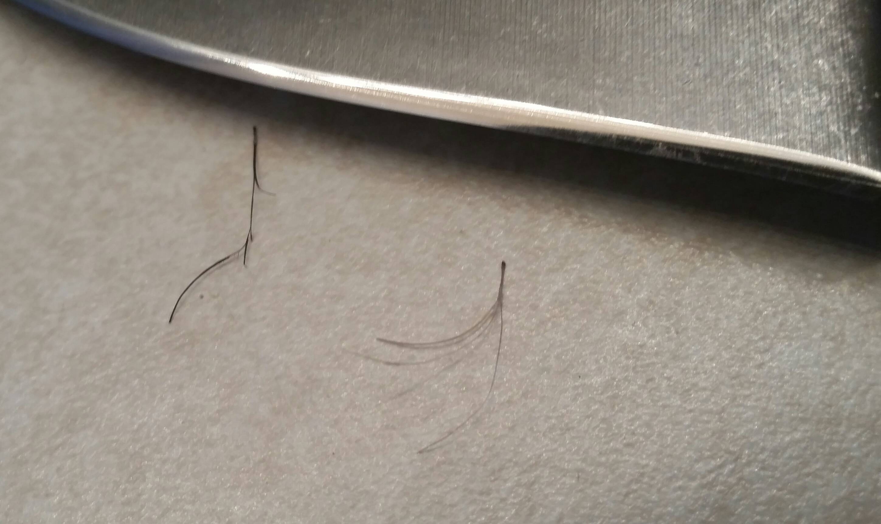

I posted this pic in another WSKO thread but I figured I would drop it in here as well.
Both these were done on the KO. I have an original WS as well.
The Bushwacker had some significant edge damage and about no tip when I received it (bought that way) and the BATAC was just in need of a good sharpen.
I did a slightly more obtuse edge on the 'Wacker as it is prinarily a chopper, it will still shave hair and make little curls out of phone book pages. The BATAC is a real cutter now...me included... !!
... that was just from an accidental touch on the edge when I was cleaning it after the sharpen..!

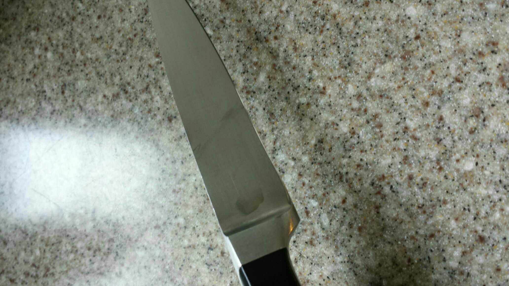

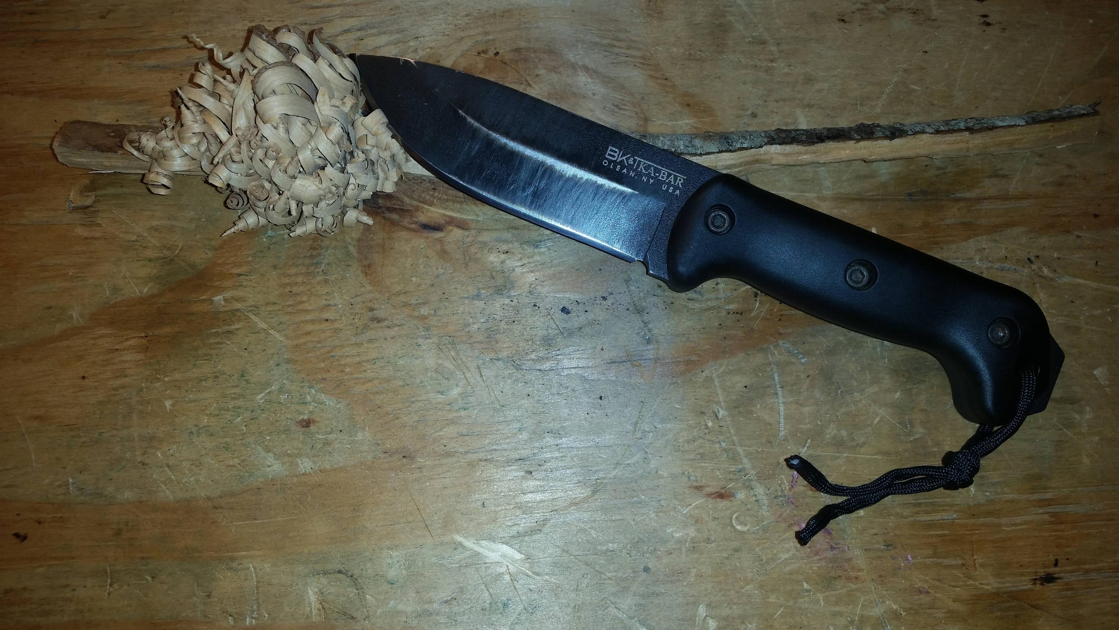

My bk2 took an awesome edge with this machine...set mine to 25° per side and gives it a solid sharp edge for the abuse its designed to take, and for a sharpened pry bar it can still make feathersticks easily with the edge the wskt ko put on it.
Oops. This is what happens if you hesitate with the coarse belts on.
I don't even use the course belts anyone unless I'm planning on removing allot of steel...this is something I learned early on after removing way too much steel a few times for general sharpening. Unless I'm sharpening a badly damaged blade I start on the x22 belt for basic sharpening and the x4 for touch ups.
I also don't even use the regular work sharp anymore since getting the blade grinding attachment. It much easier to use, yields far better results and is harder to mess up a blade like you've done.
I was reprofiling all my kitchen knives to 15 degrees and got distracted on this one. It's scary sharp, just a little mishaped towards the rear. I'm a little hesitant to use it on expensive stuff.
And btw, I recommend reprofiling your kitchen knives to 15 degrees, they function beautifully at this geometry in the kitchen.
