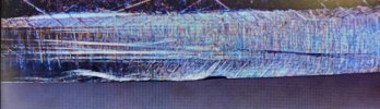

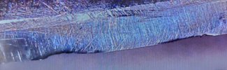

So here's some damage on my MC DEK1. Long story short I needed to cut a small piece/strand of hvac duct to jury rig a fix for a vent.
I didn't have proper tools, so I tried to cut through the strand with my DEK1. Normally, I would never use a knife for this.
These are pics I took with my cell phone of the damage. Nothing too crazy, but it was hard to get it to show up very well.20231012_131416.jpg20231012_131357.jpg
So I decided to magnify it and take photos. This first pic is of text on a penny to show the level of magnification.
The magnification is pretty high. The knife was sharpened to CORRECTION: 20° per side. Here's the damage spots on the edge.
I found some additional areas that I couldn't get to show on cell phone pics. There are duplicate images using slightly different lighting/angles. No chips, only small rolls. I wish I still had my DEK1 in d3v to test in the same way.20231012_133119.jpg20231012_132930.jpg20231012_132749.jpg20231012_132559.jpg20231012_132517.jpg

Considering folks have used EDCs to cut the steel bands/straps on pallets of heavy goods with no edge damage, I think the D3V would've probably fared better.
Thanks for sharing. I think the advantages of MC over D3V for most folks, is going to be in a somewhat narrower use-case.
I think that's likely correct. Nate made that pretty clear in the past in saying that MC wouldn't replace D3V, and that on the whole he still prefers D3V by a wide margin.
Not surprised...much as I think that MC is a fine choice for the spectrum it covers.
