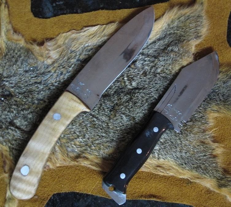

I'll say. Here's Bawanna's Pen Knife with checkering in progress:
wow that does look great , you guys have converted me to checkering, I am piling up knives to give bawanna to pay for the work :D
Mr. Tall you sir are a magician. I would not recommend a round handle like that for your first checkering experience. That was challenging.
I'm no doubt a bit biased but I love that picture and I truly love that knife too. I better hold it for a spell tonight and show it some love. The baby bowie has been getting all the attention lately. After checkering I wrapped it in para cord since the handle was a bit small but I think I'm gonna pull that off too. Looks better with the horn.

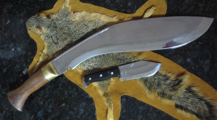

Well here is a quick and dirty photo of my Baby:) I gave the blade a quick scrub down and a short muriatic acid bath to gray it up a bit and take away some of the shine
Here it is with my FNX-9 I'm carrying today for scale.
I have used this knife for everything from cutting up chicken to trimming my daughter's straw at Dairy Queen to opening boxes to boring out the ends of corn cobs so that they fit easier on the squirrel feeder. I LOVE this knife!
Nice picture, goes well with the FN too. Still pretty, just a little less gloss after the muriatic acid.
This picture inspired me to tear off the cord wrap I covered that beautiful horn with. I'm ashamed of myself for ever doing it in the first place. The handle doesn't seem as small as it did and with the baby bowie doing daily duty I can easily live with it. I do love the little pen knife.
It was a bit of a chore to clean off the epoxy I used to secure the para cord with but I'm pretty much done. I'll take some new pics when I get a chance. I neglected to respect the blade and I'm sure it's feeling much better now that it's back to it's natural state.
