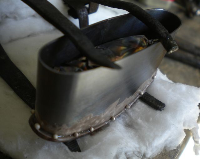

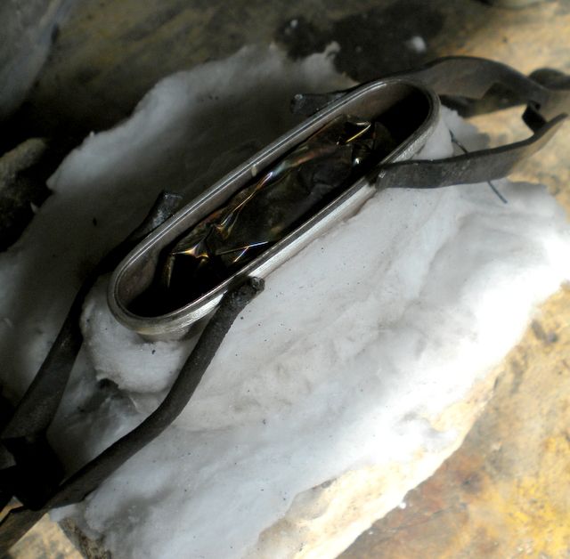

The thin bronze fittings sprung shut just a little every time I took it off the wood, so I had to support it from the inside to keep the fit to the wood right, before soldering/brazing any of the other parts on. With the tip I crumpled up some stainless foil to support it from the inside, now just have to solder the end on. Another problem is that the thin bronze wants to buckle every time I solder to it, so I’m having to use cross lock tweezers, wire and such to hold it in shape. I think I could get through it easier next time though, because I did learn a few things. Definitely required me to stretch my noodle a bit.
Have another one to do after this one, so hopefully it will go smoother next time.
Here’s a couple shots to give a better idea of what I’m talking about,… what this is like. Anyway, I got a good silver solder seam and it still fits over the end of the scabbard, but one side of the first center seam lifted up just a little. Probably just a bit too much pressure from the stainless foil inside. At least it didn’t come apart (knock on wood). I think I’ll be able to tap and or push it down a hair, then just sand it flush, hopefully. The open end did buckle and swell out just a bit, but I think I can just squeeze it back in a hair, before I try and braze/solder the silver trim on that end.
Here’s the set up I used to solder/braze the silver piece on to the tip.

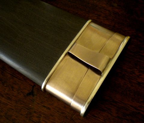

1-¼ inch belt loop.

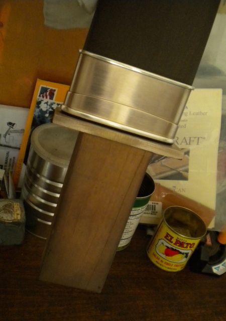

I put a leather washer in up at the top, between the top of the wood body and the inside of the throat, for a nice smooth snug fit, and to help keep the knife/sword, "knord", from falling out. I also put another leather washer at the very top on the outside of the throat to pad the guard. It has a great feel going in and out,… no rattle, nice and smooth, comfortable and best of all,... it won‘t get stuck. ;)
Not the absolute final finish, but close enough for now... a bit of a chore, but I guess it was worth it.

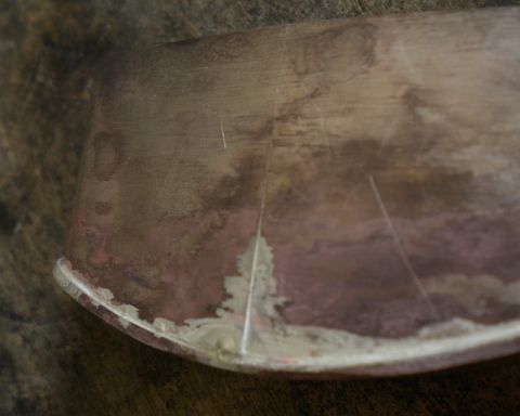

I have used quite a bit of copper and nickel silver, good contrast, close enough melting points etc., but the fusion between the two metals isn't very strong compared to copper and sterling or fine silver. It tends to split apart between layers when worked. If the pattern washed out a bit, probably got it too hot. Copper and nickel silver combo looks great etched in ferric chloride, neat textures.
Here's an example of one of mine from a long time ago, copper/nickel silver with heat patina (no etching on this one).
