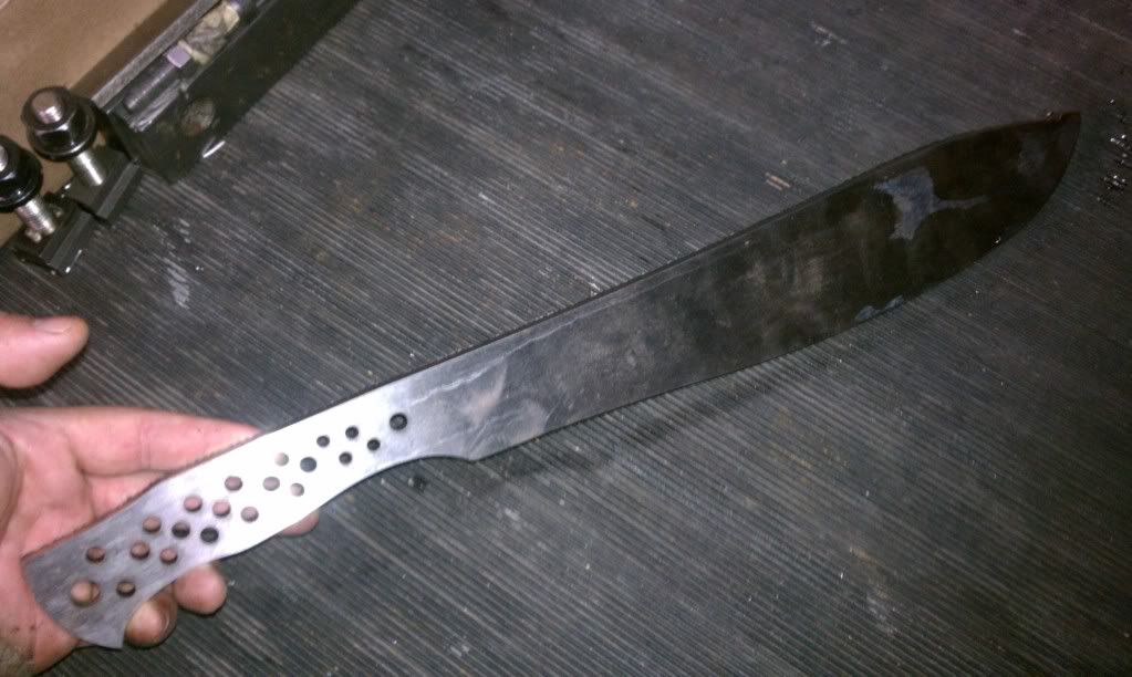

I rough ground this out of some 5/32" 52100 stock this afternoon. If I get some spare time this weekend I will grind the bevels and drill the tang holes.

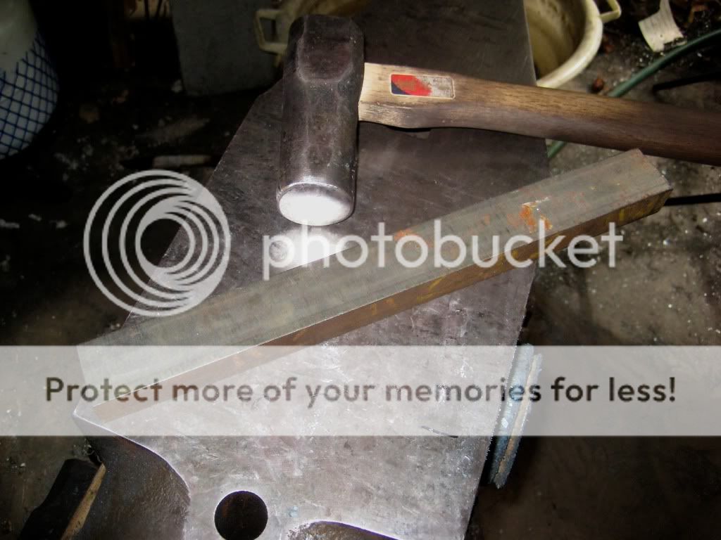

I started with a piece of W2 similar to this.

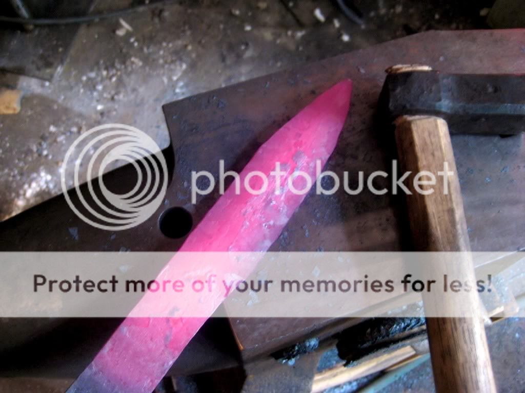

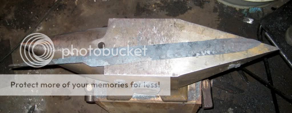

And here's some of the forging stages and finally the sword in hand. I expect this to wander a fair bit during the quench.

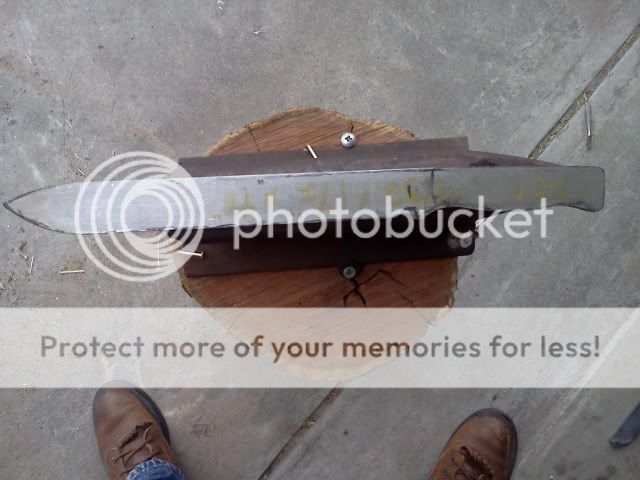

This one isn't the piece for the order, more of a trial run. I'll be leaving it brut de forge style. The blade will be about 19" and I haven't sorted out the handle yet so I made the tang a good 10" for a pein block.

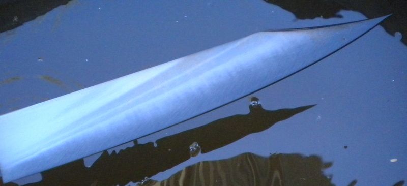

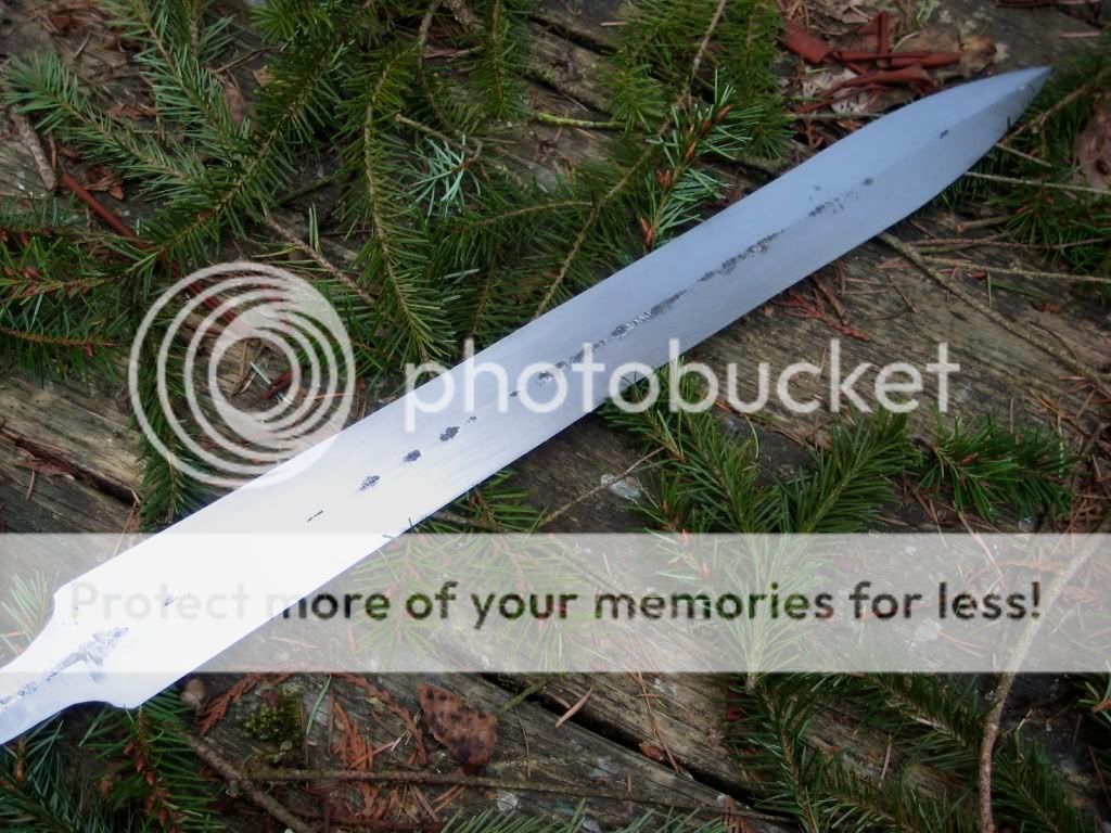

Not the final finish, but just rough sanded post HT (150 grit) and a few dips in F.C. to make sure the lines fell as planned.
The final finish will be more subtle.
Tai, I love that shot. That tip profile is so graceful but so vicious at the same time.

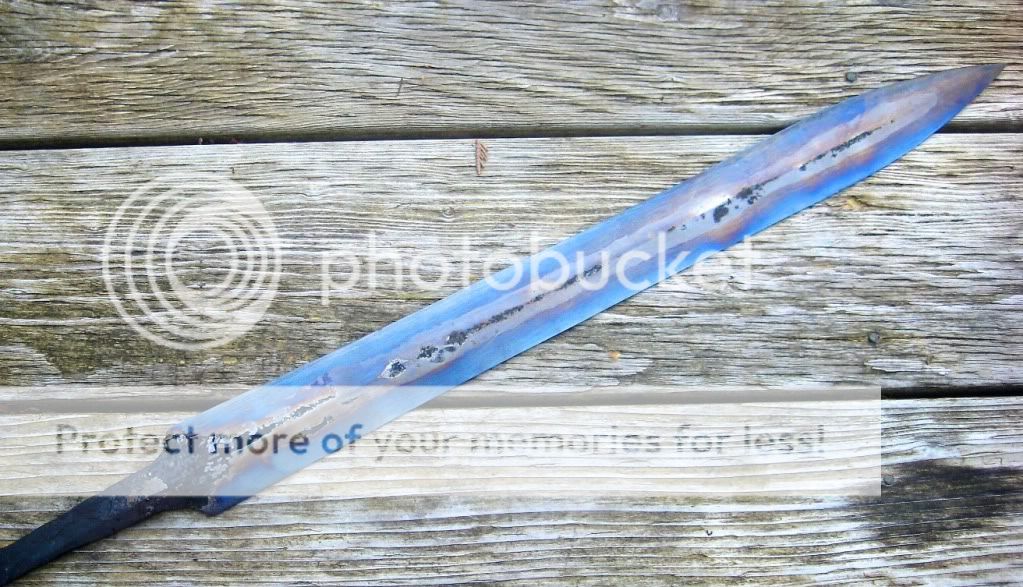

This is the first time I’ve intentionally made the point straight in line and dead on the center line of the handle with a single edged blade… a little more of a thrusting weapon, but still good for chopping, slicing and some camp chores.
Tai that came out incredibly well! I see some rays of sunlight running through the rainbow.

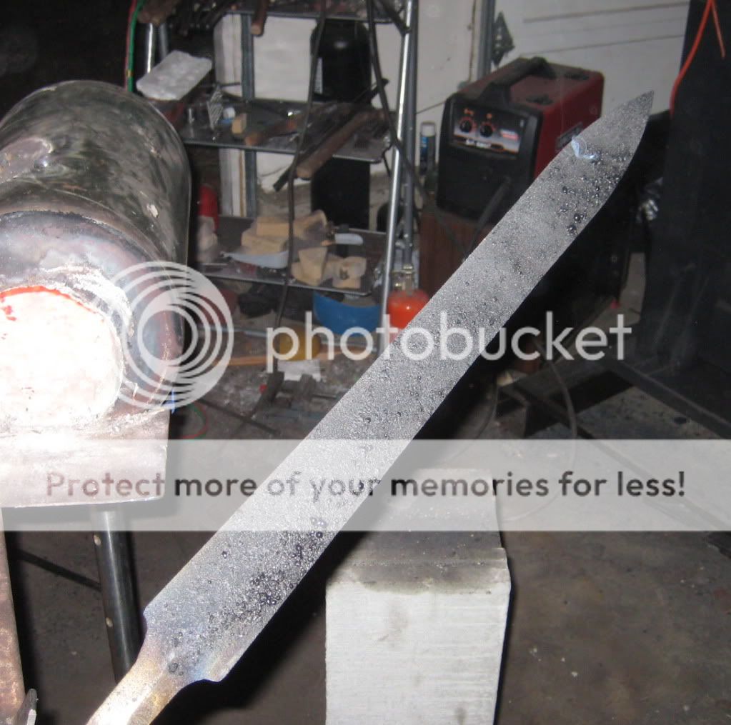

Had an exciting HT session last night. I went ahead and did it because I didn't want to waste a nice dark night. I do my HT'ing in a forge. I don't fully trust my Paragon and how can you see the colours through the door? :p And when you have a sword at that temperature, it tends to get a little droopy if you don't watch it.

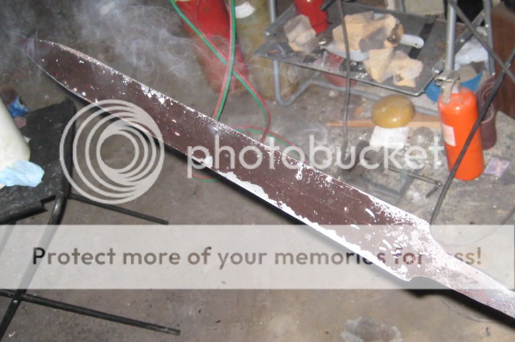

So, I heated it up, sprinkled it with anti-scale compound.
No pictures in process as I had to turn out the lights and concentrate but here it is out of the Parks50. Has anyone else quenched using anti-scale compound? I should have taken a video, the blade screams as it's cooling. It's a crazy sound, even more violent sounding than a sword into water. A quick test with a file and it skated nicely along the whole edge.
So, I thought this was going to come out like a pretzel. It's not a thick blade and quite wide and with the draw filing I took the edges down to about 0.018" but it came out STRAIGHT! I don't have to adjust anything! I was very happily amazed! Either luck or I did something right.. probably luck. :p:p
