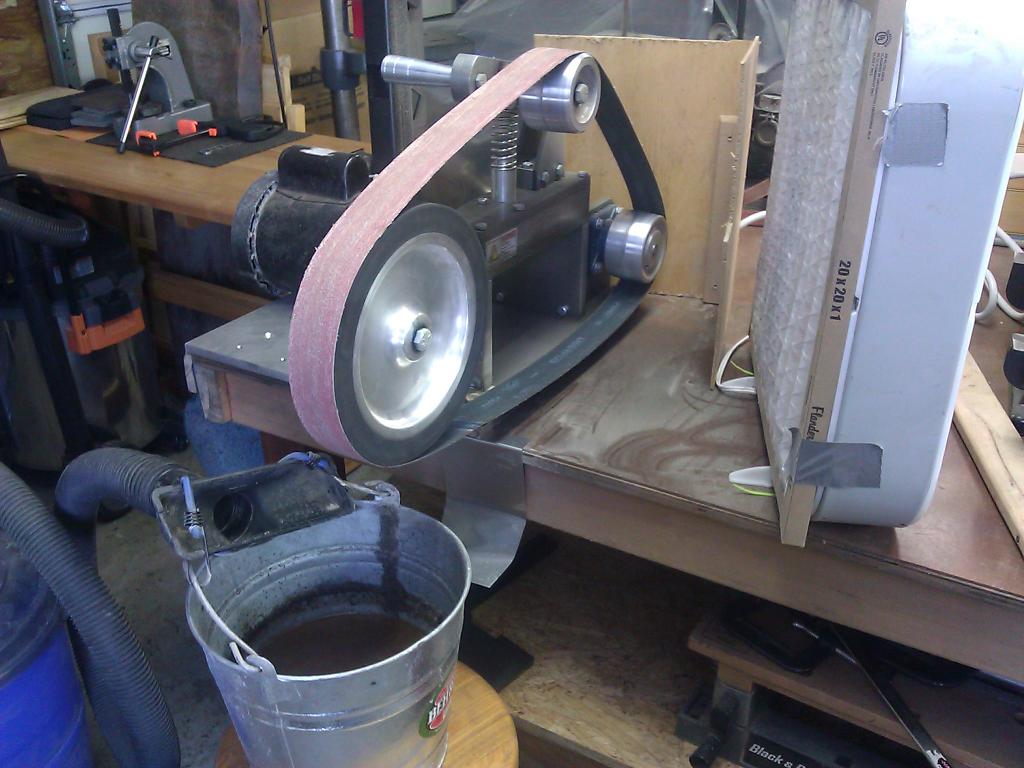

There are indeed people who use what is essentially a powered bong to catch grit and dust and whatnot coming off the grinder. I haven't tried it myself but it makes sense. Which is worse, emptying a bucket of sludge every week or vacuuming up dry dust every week?
I think the choice is between sludge and fire. I'm waaaay in favor of sludge, given those options.
Here's my current ad-hoc arrangement. It works better than I expected. I'd still like to add some flashing under the belt path and in other spark-prone area.

Right on, I've been using that same set-up right behind my grinder for years. As Bladite said, not as good as a proper dust collector but certainly worthwhile. You still need to wear a respirator of course, but it does help a lot with general cleanup.
However be warned... if you let the filter get too dirty and then aggressively hog off a bunch of steel, the sparks can suddenly turn the dusty filter into a huge glowing IR heater, fed by the fan pulling air through it :eek: So vacuum off the filter often. Don't ask me how I know. :o :D
