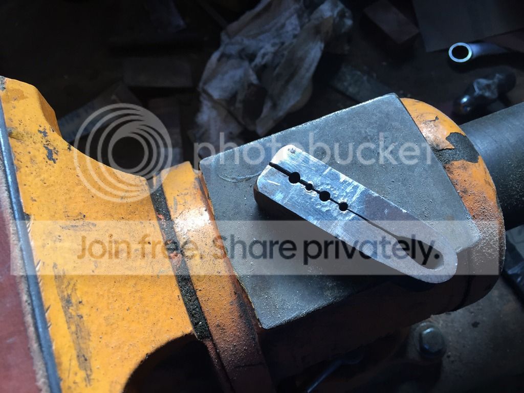

Here is my pin vice. I clamped a piece of pop can between it, then drilled a few common sizes of pins. 1/16" 3/32" and 1/8"

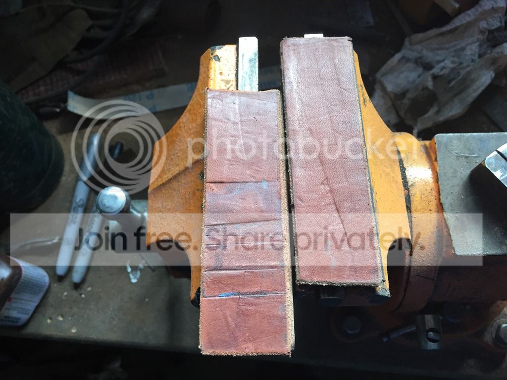

Here is some leather lined angle iron pieces that I use to hold blades i dont want to scratch.
"NO Weld knife Vise" i was shopping for one of these a few months ago. the cheapest one i could find was $50. i didn't like it because it had a piece of angle iron welded to the bottom to be clamped in the vise, which would get in the way if i turned it on its side in my bench vise and limit the number of positions i could hold it with. then i noticed the only reason it needed to be welded was because of the "up" pressure on the bolt that tightens the jaws. i realized if the nut was inside, it would push against the body of the vise and welding would not be needed. so i bought the rectangle body off ebay for $12, bought a nut, bolt and knob/handle at the hardware store for $8. i drilled a hole, set the nut in the right spot with a few drops of crazy glue, clamped it in the vise upside down, and applied JB weld around the nut. put some jbweld on the bolt before screwing it into the knob. 2 pieces of wood, contact cement some leather on them. its been working great for a few months now. most people use a 2"x2", but i went with 3"x2" in case i want to do a 2" wide blade.
