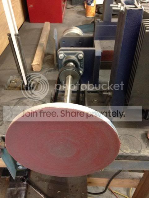

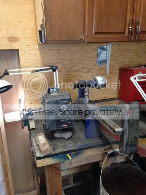

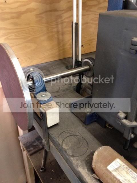

I made an attachment for buffing from the leftovers when upgrading to direct drive and VS.
Saw another thread on this forum that suggested this solution.
Thank you for that. It works great.

Like many, I have limited shop space and money. I saved up and got a KMG and a VFD. After a shop visit to Bruce Bingenheimer's place, I REALLY wanted a disc grinder. Thankfully, he also had his set up where I could get myself one like it for minimal cost using my KMG and existing VFD.
