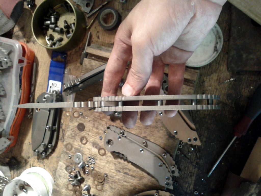

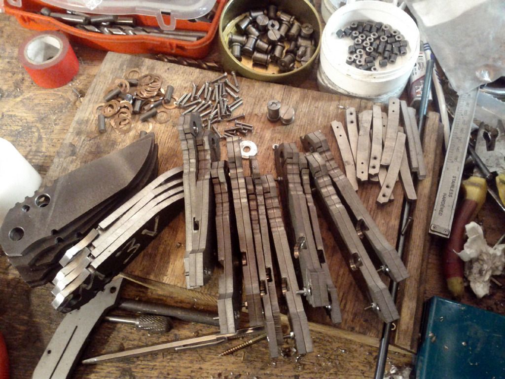

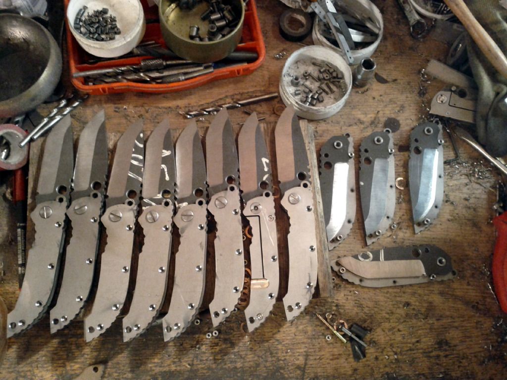

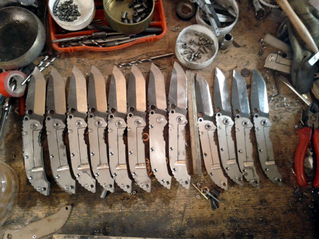

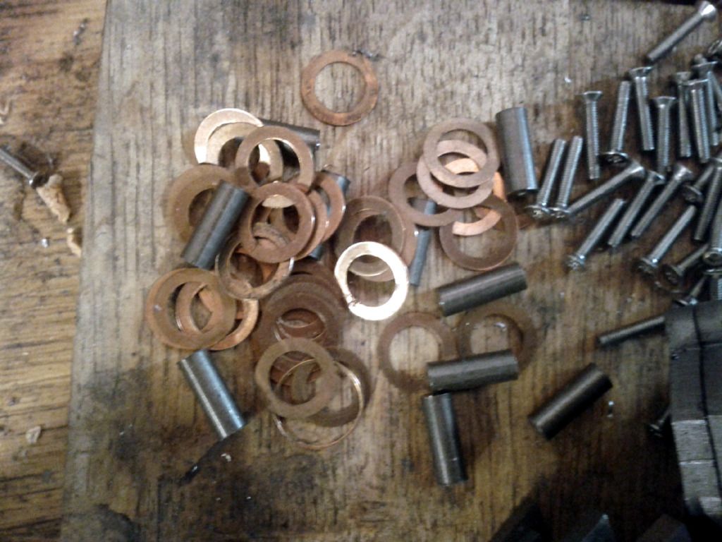

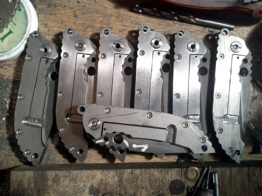

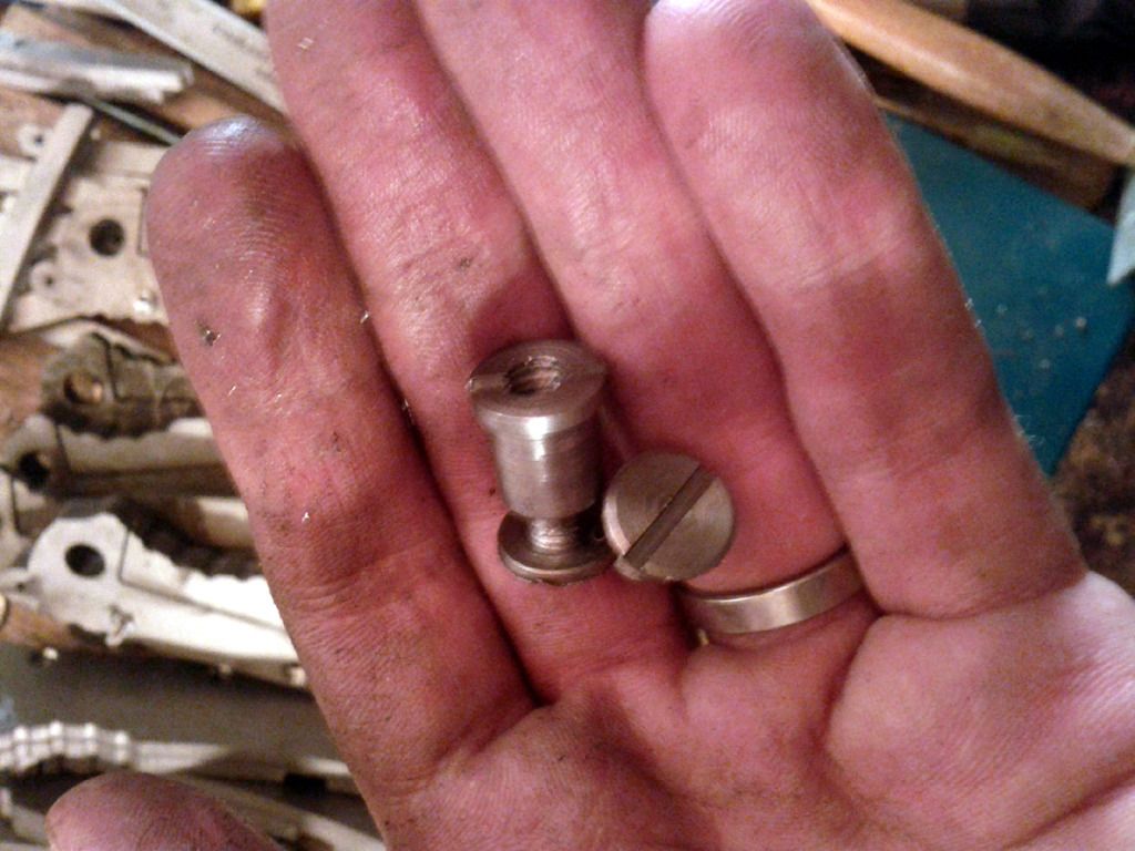

so i finally started the third batch of knives.. here's a few pics, as you can see i switched to slotted head pivots as a few of you suggested it's better than the previous one and easier to dismantle your knife!
Alphahunter i can't wait to get started :D

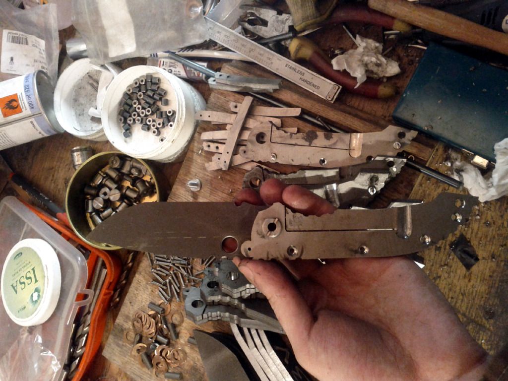

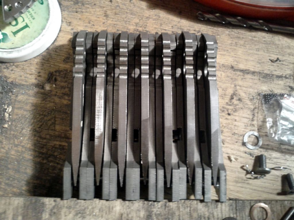

here's a few more pics..

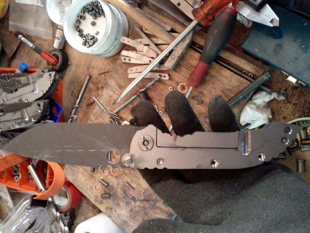

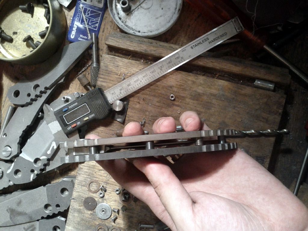

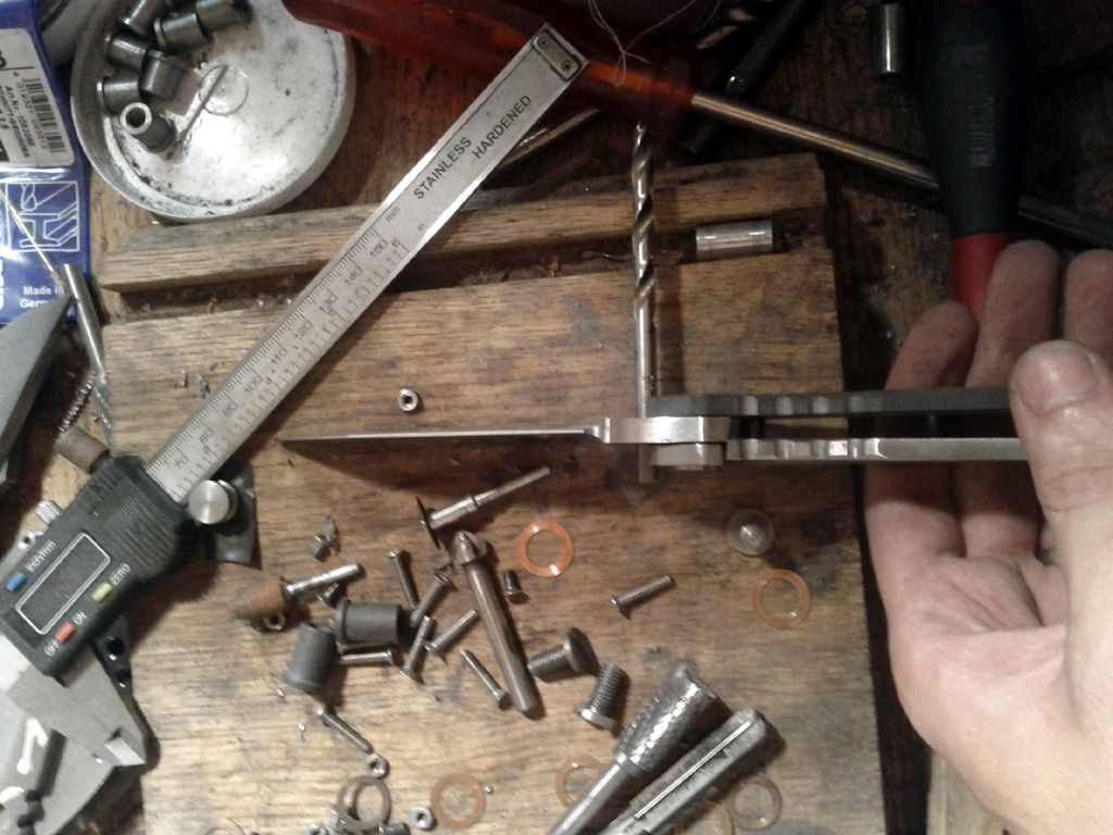

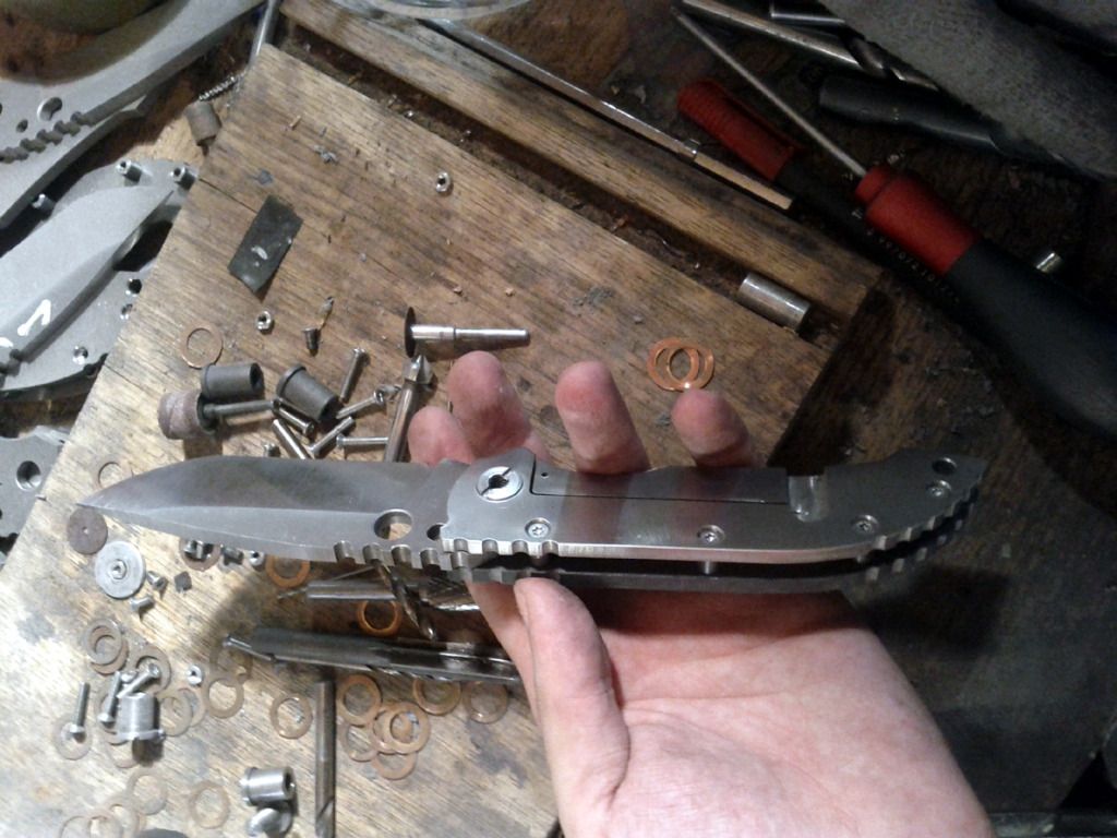

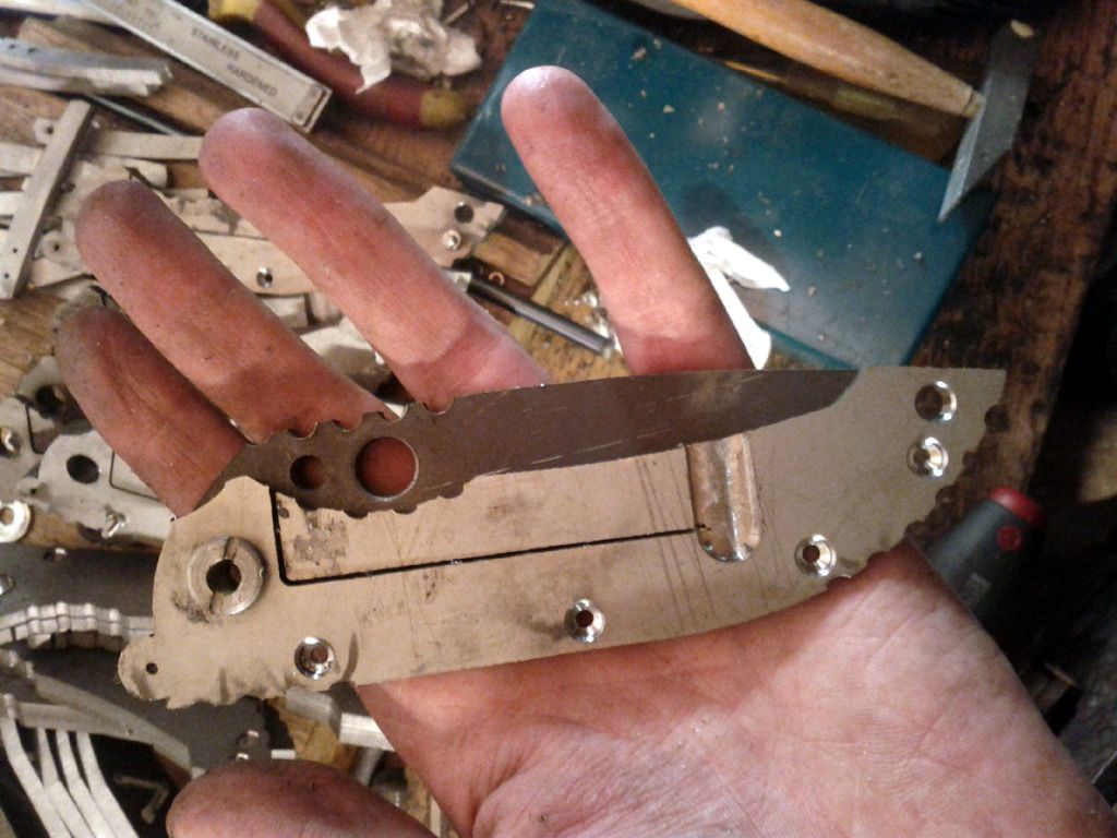

a few people asked me what do i use as a blade stopper..well i use the first standoff, i was thinking of using a special 2mm rod but i like to keep things as simple as i can..
the photo below explains what stops the blade.
thanks for looking everyone :)

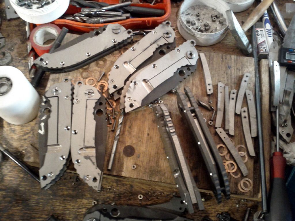

todays update:

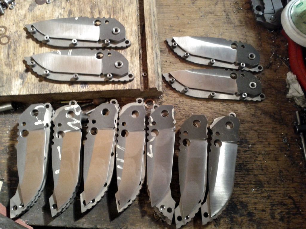

grinded the blades with 60 grit..tomorrow i'll do the 'fine' grinding
thanks for watching everyone!

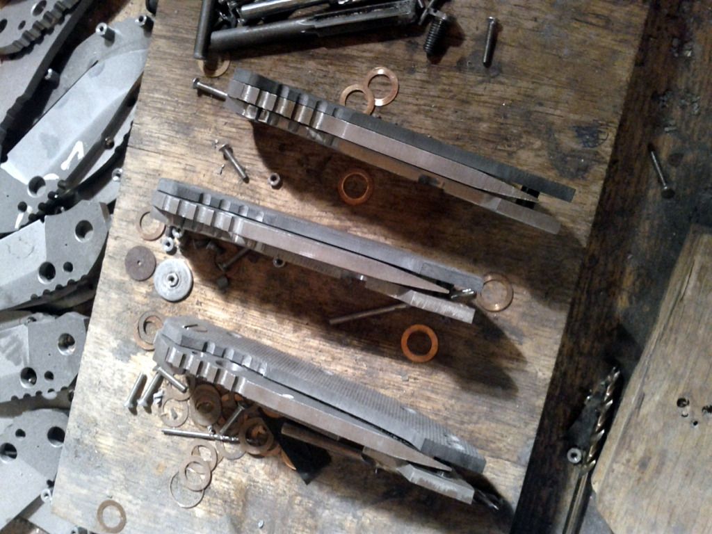

today i grinded the blades to finer grits , tomorrow i'll sand flats and handles and maybe set the detents if everything goes smoothly :)

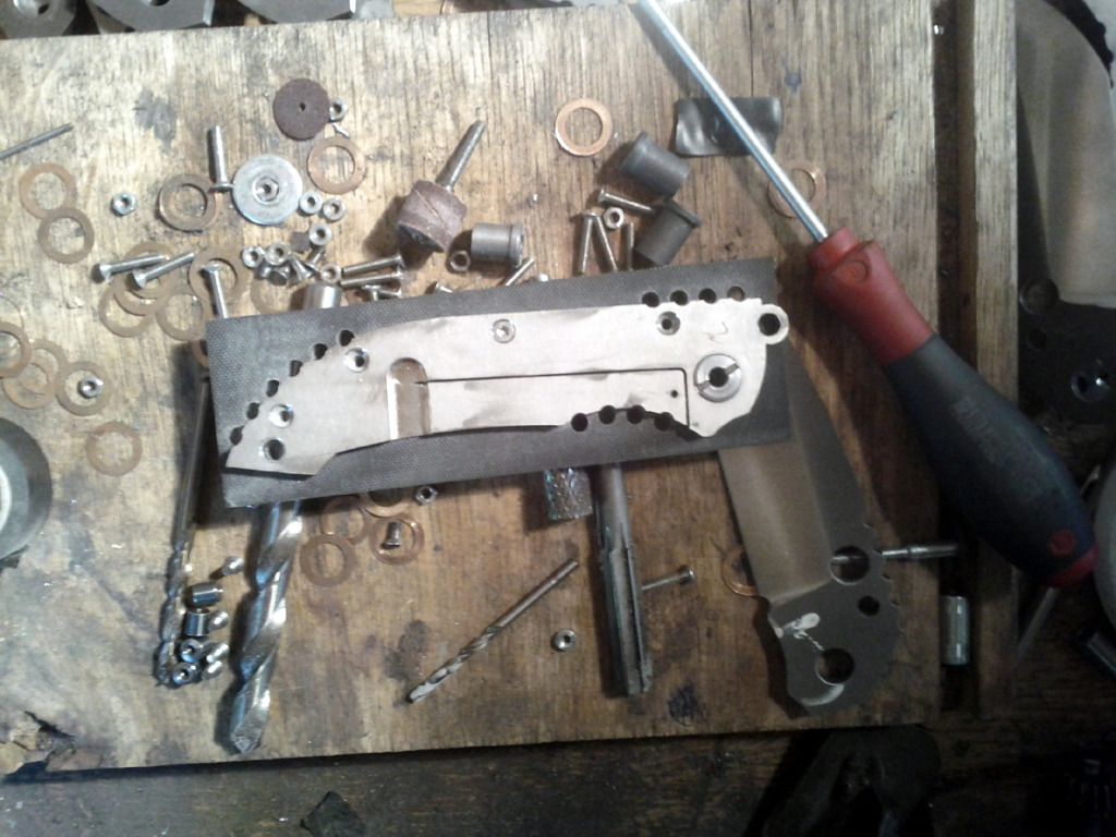

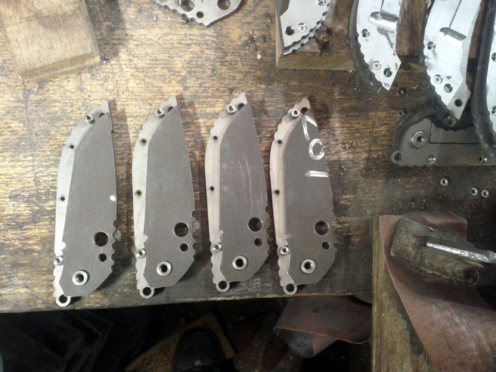

today i don't have a a lot of new photos..spent the day on setting up the blade choil (blade stopper) and setting up detent balls.
tomorrow i need to go to my friends shop and cut G10 for 4 G10/Ti knives..i should leave the blades for HT on Friday or Monday , will see when i get the slot :)

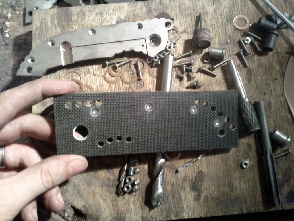

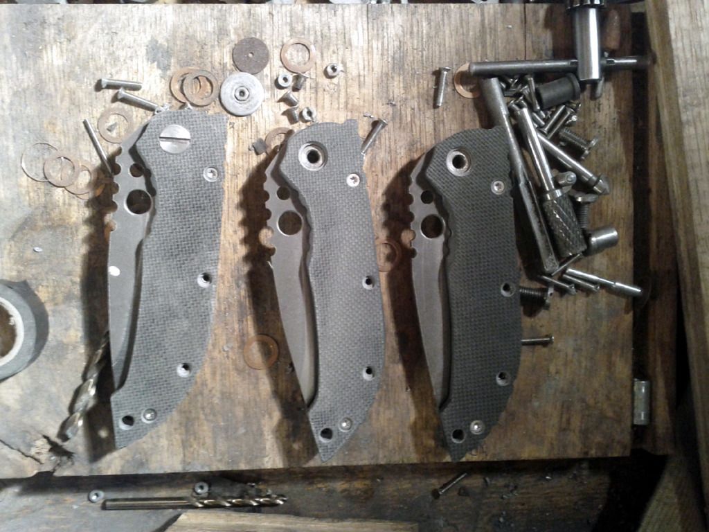

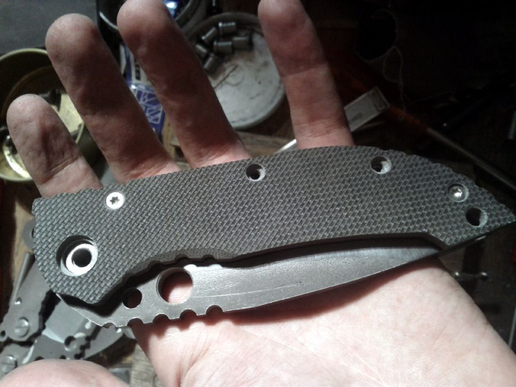

today i worked on G10..man that stuff is everywhere, i took a shower and i still smell g10 :D
tomorrow i'm getting OD green g10 and i'll make forth scale tomorrow..
here are the todays photos..HT is on Monday!
