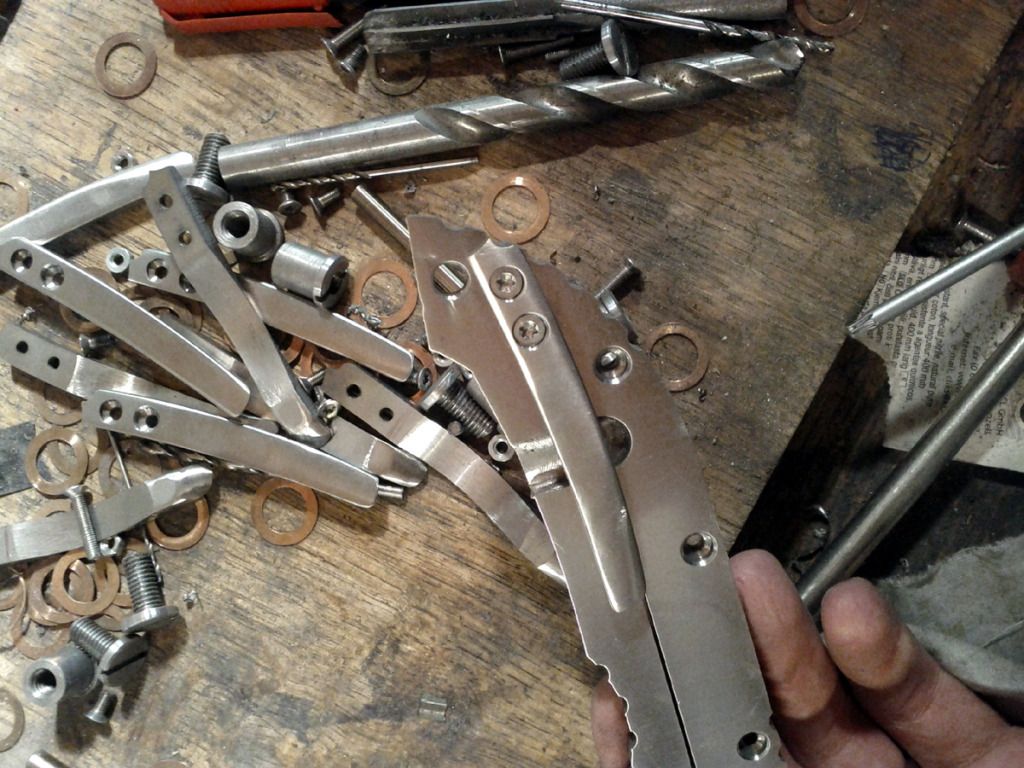

I do like the slotted head. Did the old machinist have a change of heart and stopped being so obderate?

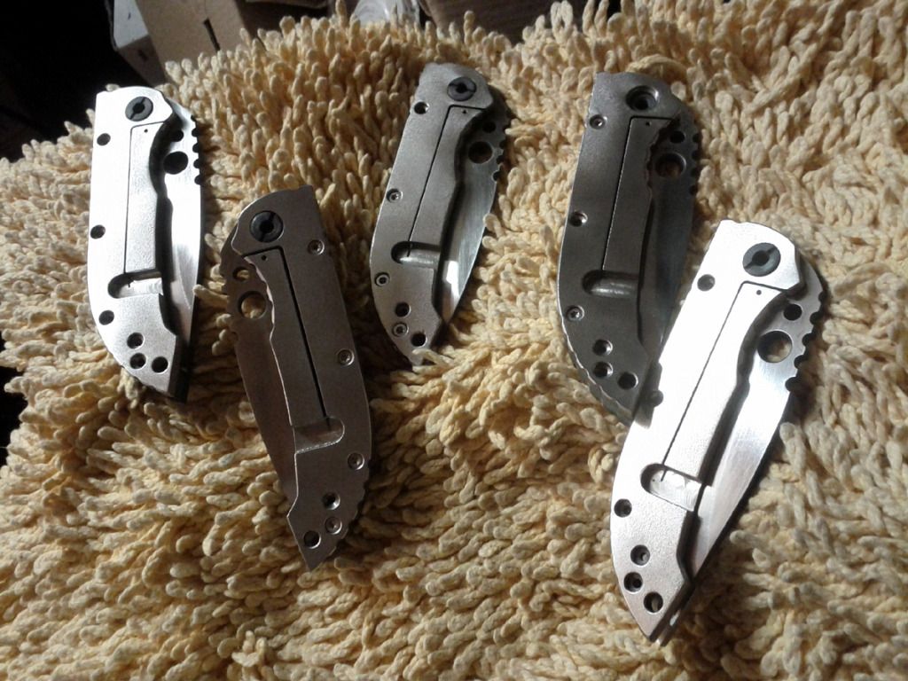

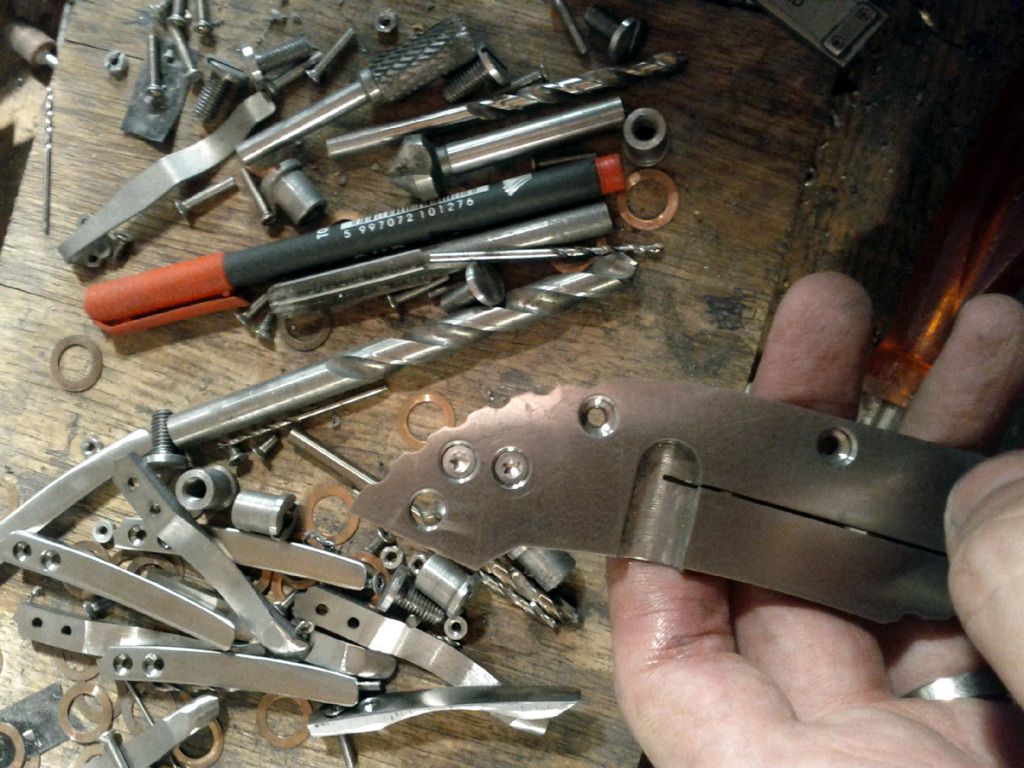

The question I have is what the heck is going on with that eye-hole protrusion on the end of the frame? My guess is that it holds the blade open while the lock is fitted or something. Seems like a big extra step but I have faith you know what you're doing so I'm just curious.
Thanks
thanks Mark!!!
haha..yes the machinist came through for me..hes really old but his knowledge is very impressive!!!
as for the eye hole protrusion , you're absolutely right!!! holds the blade open (exactly where i want it to be) so i can fit the lock and helps to make the jimping align better :)

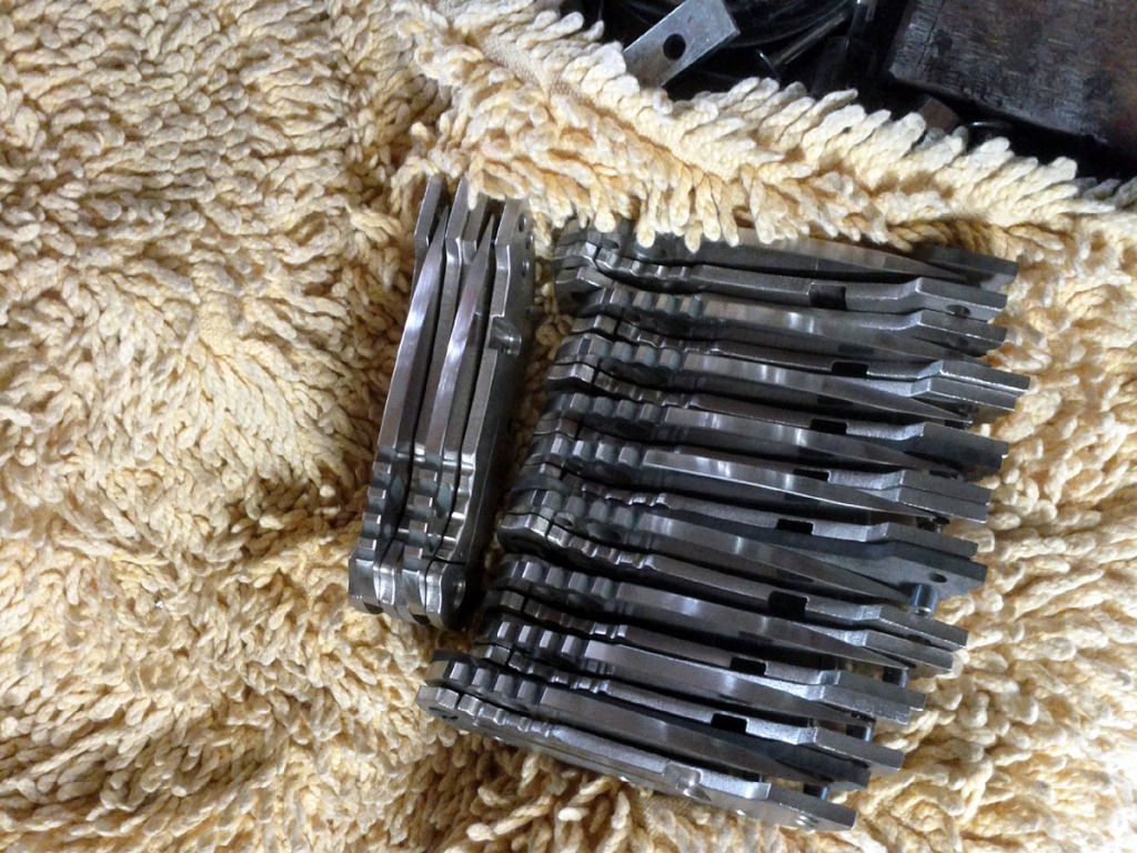

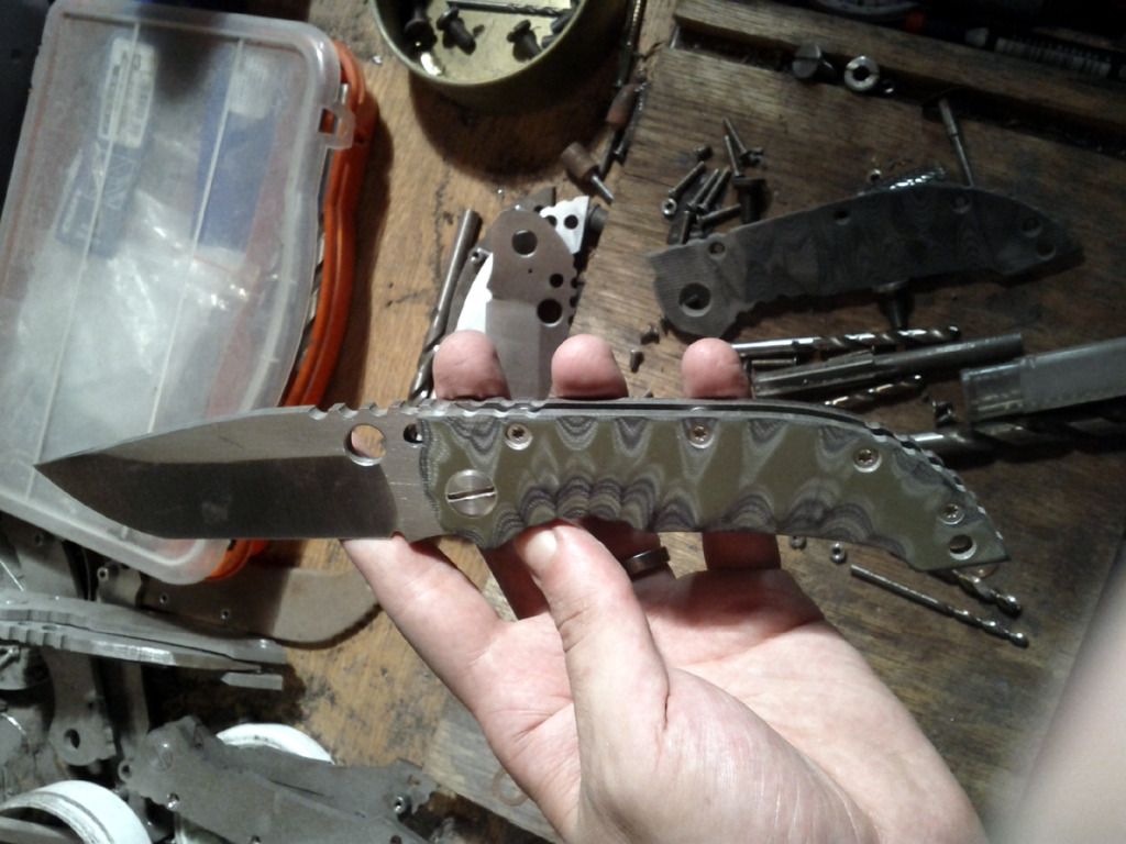

i just finished up this od green / black g10 handle...it's the first one i 'profiled'
over the weekend i'll make clips, polish and orange peel the frames..

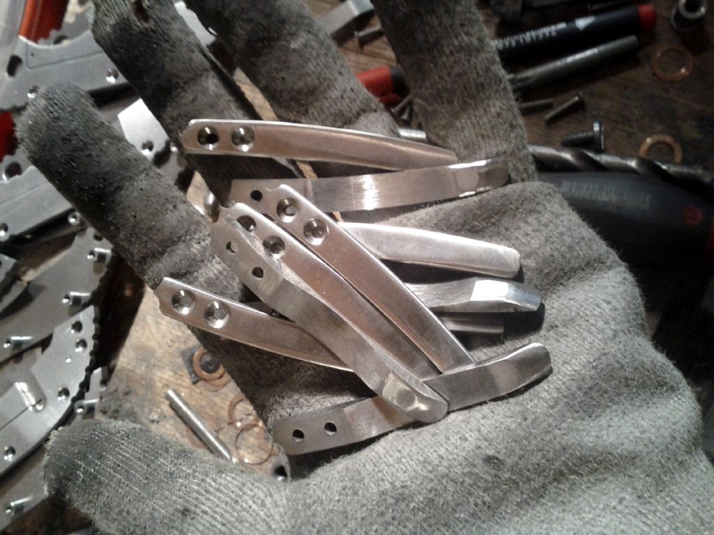

today i made clips...man i burned my fingers sooo many times...
knife can be with or without a clip..

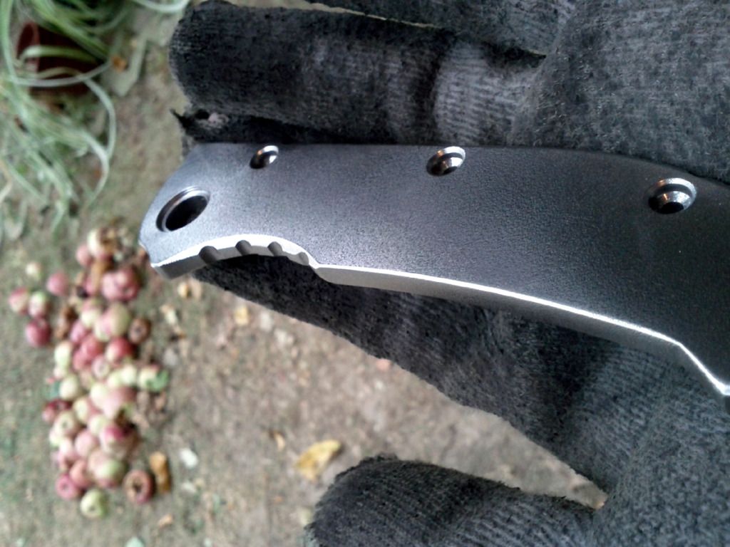

today i got the blades from HT but i have to wait for pivots..they will be done on Thursday so i can't fit the locks now..

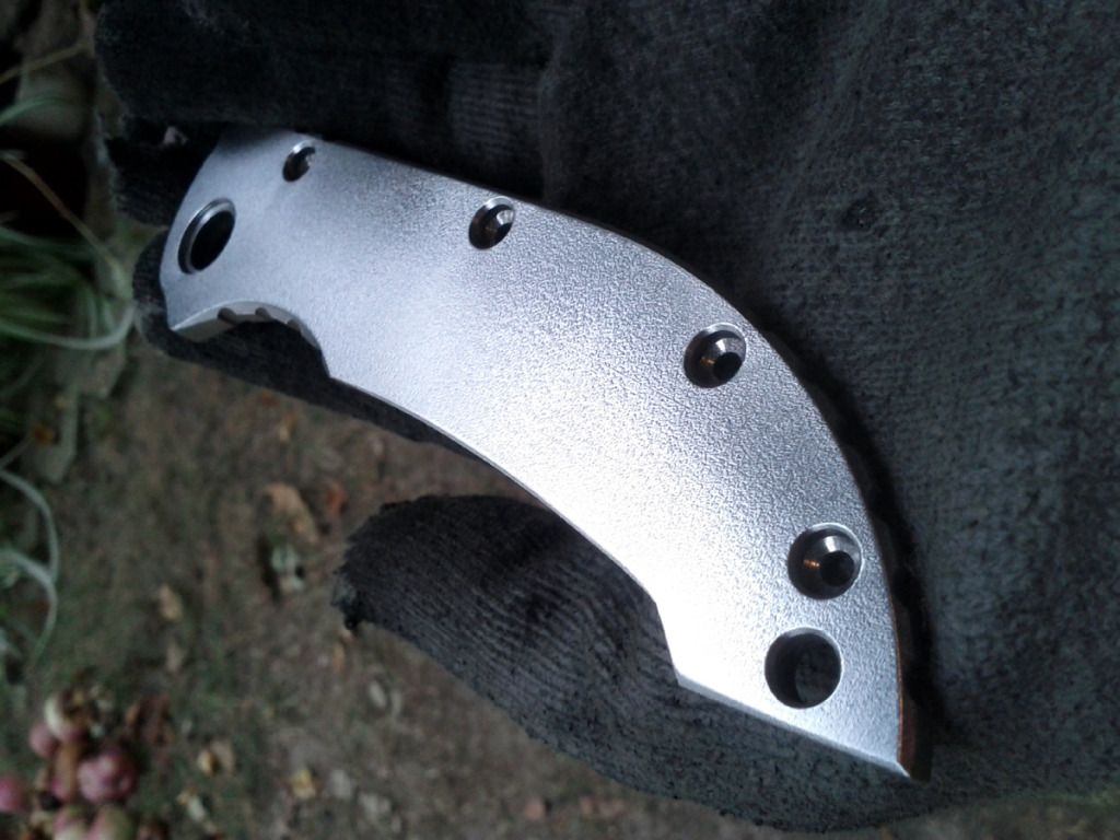

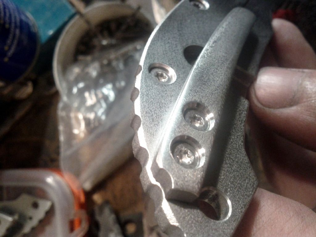

i cleaned the blades and OP one frame just so you guys can see what will it look like..it's a lot better in person!

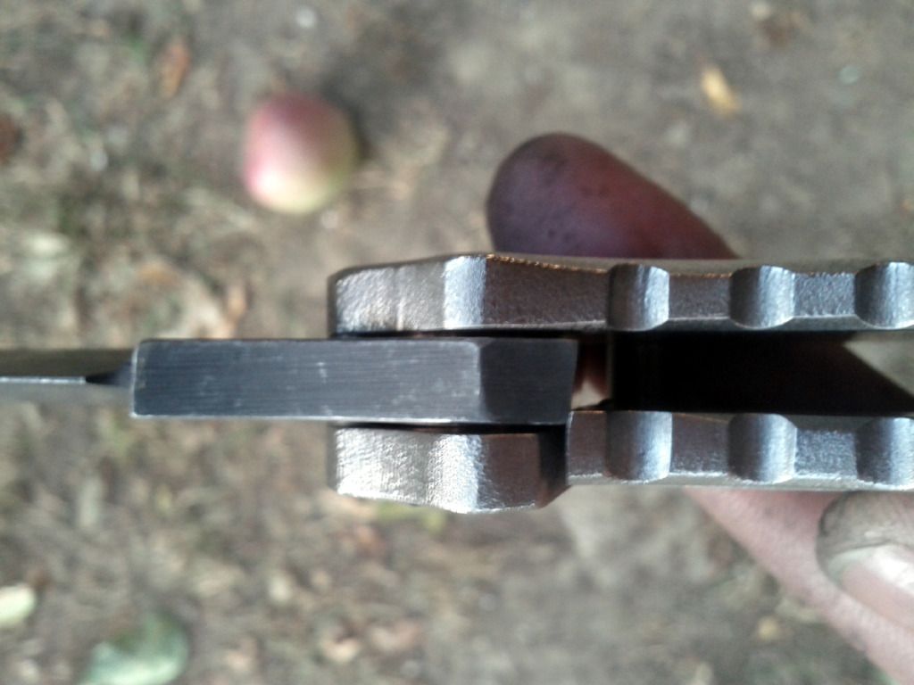

The screws seem to be recessed a lot deeper than you've been doing and since there is always a method to your madness I'm wondering why so deep on countersinking. Then again maybe it's just my imagination.
hahaha Mark you notice every little thing :)
yes i recess them a bit more as the Ti frame on these is 1mm thicker..and it looks cooler :cool:

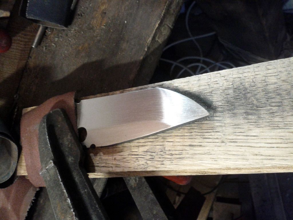

here's a few better pics of OP...today i hand rubbed the blades...went through 6 of them , so tomorrow another six..every time i get to this part i keep saying to myself no more 3v steel..i don't need this...but once everything is done i come to my senses :D

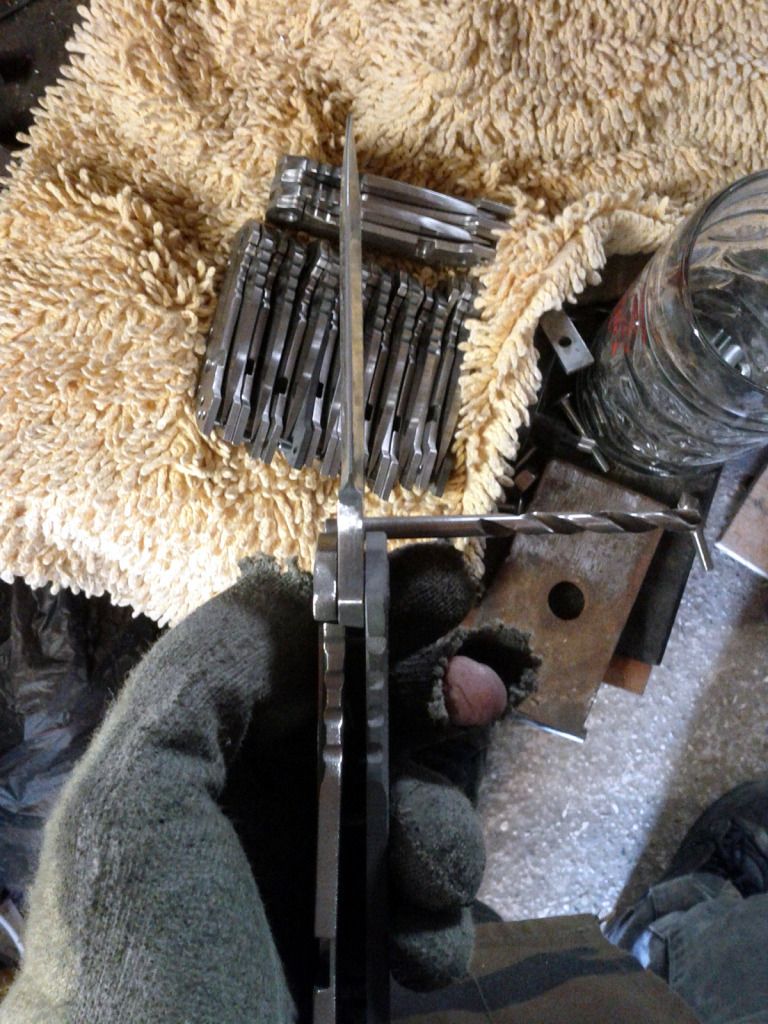

so...today i am finally done with the blades...sanded the flats and the spine and fitted a few locks..at this rate i should be done by Tuesday :)
on the first photo the blades are inserted into frames without washers and aren't assembled...

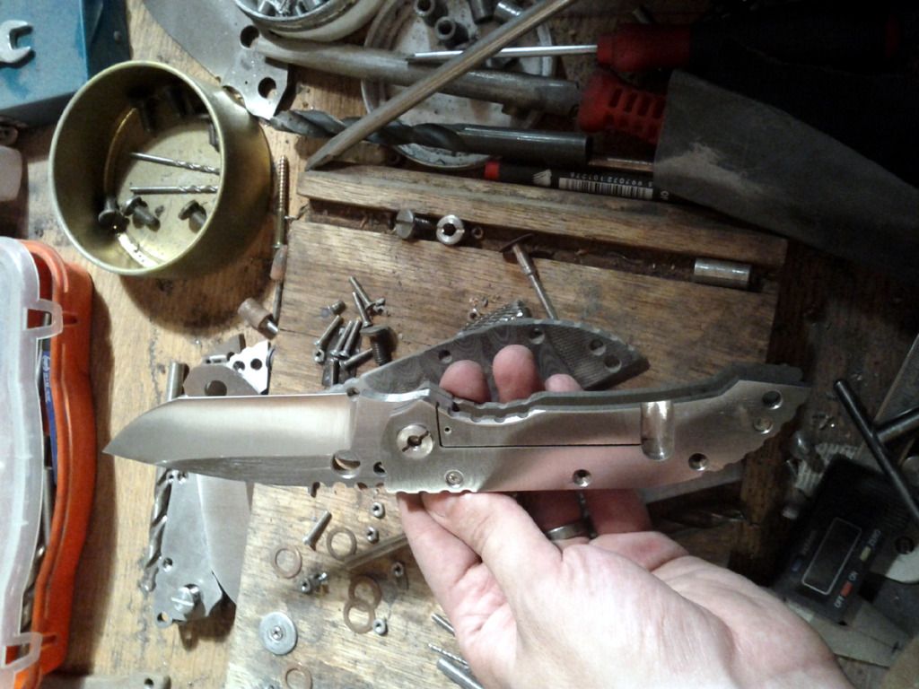

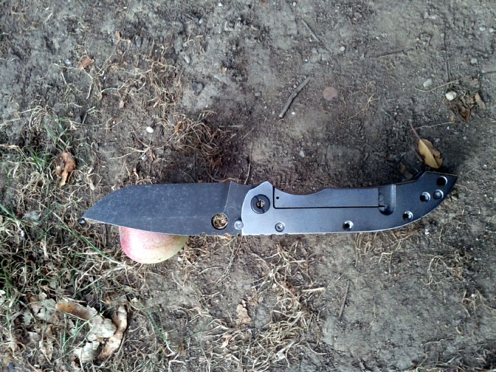

today i dunked the blades in FeCl and stonewashed them..after that i press fitted thumb studs/blade stoppers.
tomorrow i'll fit the remaining locks and start sharpening the blades :)

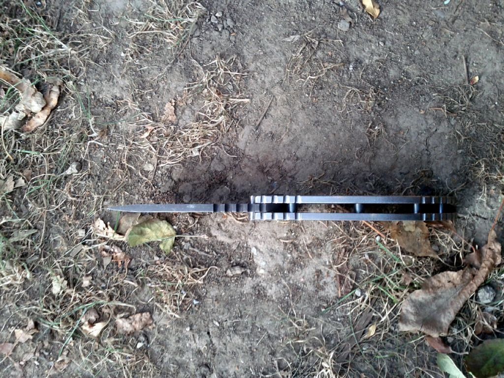

i don't have anodizer but i did flame a few before..can't get a complete even color but i think it looks cool!

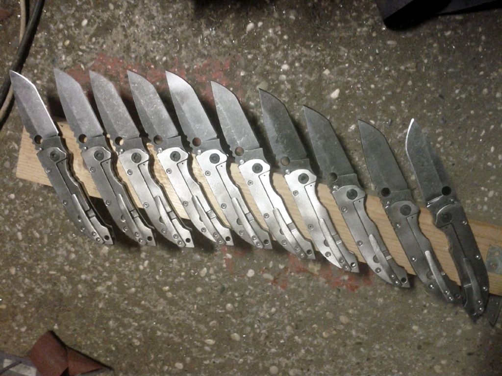

so for the past 3 days i've been sharpening these knives.. today i'm finished..tomorrow i'll check every single knife and do some fine tuning and i should send these Friday :)
not many pics as i worked all day and by the time i wanted to do a pic it was dark..tomorrow i'll get some better pics!
