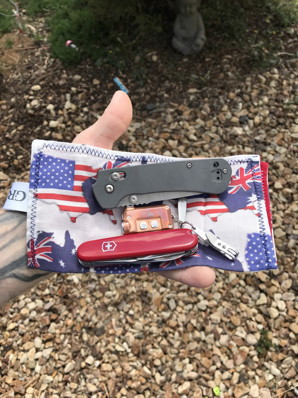

I received mine today. About one and a half weeks to be shipped to Australia, awesome.
First the positives: I really like a lot about the Perpetua. The ergonomics really fit me well, it’s extremely comfortable in my hand.
The G10 is great. It’s grippy but not aggressively so and it feels very high quality. It’s the nicest G10 I’ve felt on a knife. The axis lock mechanism is really nice, it’s very smooth to pull down.
I love the blade shape and the finish. The stonewash is gorgeous. I like that the whole knife is monochrome, it’s discreet and will hide wear very well.
The grind is fantastic, it came hair shaving sharp. One of the sharpest knives I’ve received.
Unfortunately I have 3 issues with it.
First issue: there is rust or pitting spots on the spine of the blade.
Second issue: the clip was nice and tight out of the box. I’ve only had the knife in my pocket for half a day but just removing it and putting it back in my pocket has already loosened the clip considerably. I know this happens with all clips but certainly not within one day. I worry about the long term durability of this clip.
Third issue: the action is gritty, loud and screechy. Something is wrong with it. I added a couple of drops of nano oil and slightly loosen the pivot but it has actually gotten worst from when I received it.
When I hold the axis lock mechanism down, the blade swings freely and it’s beautifully smooth but as soon as the axis lock mechanism is released, it’s back to being horribly gritty and screechy.
Also the thumb studs aren’t far enough away from the scale and they aren’t tall enough. This is very disappointing especially considering this was supposed to be fixed on the production knives. It was mentioned in Epic Snuggle Bunny’s prototype review and was mentioned in the opening post in the comments section. Maybe I’ll get used to the thumb studs? I can’t tell because the knife isn’t able to be flicked open with the gritty screeching action.
I’m very disappointed. There is a lot I like about this knife. I think this will be a great user knife, especially with a higher quality pocket clip and better thought out thumb studs.
I’ve contacted massdrop and sent them photos and video of the above issues.
Here is the video.
If it’s an easy fix, that would be great because the cost to send it back to the U.S could cost a third of the original cost of the knife.

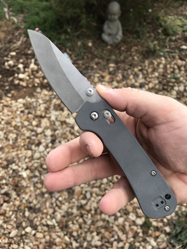

This is an update from my first impressions and issues posted just above.
Recap: I had an issue with the action. It was screechy, loud and gritty. I have a video posted in the prior comment. It was bad, I could open the knife with one hand. I had contacted massdrop but haven’t heard anything back from them. Anyway, RDO today so I sprayed the hell out of it with WD-40, cycled the action and rinsed with hot water. I then used compressed air to blow it out, dried it eith my wife’s hairdryer and gave it another spray of compressed air. Some 10w nano oil and boom! Perfect. Action is smooth as a baby’s bottom. I’m really really liking the knife a lot. The G10 is grippy and looks great, ergos are fantasti, the blade shape is very utilitarian and great for EDC. I love love the heavy stonewash. It’s the nicest stonewash I’ve seen next to the Boo’s Mini Aero. Great jimping on the Perpetua as well. I did complain about the thumb studs being too short and too close to the handle... now that the action is fixed, it’s not an issue. The studs are nicely designed and catch my thumb nicely. I flick them from across the G10, not underneath the actual stud. The only issues i have is with the small rust/pitting spots on the spine of the blade and the pocket clip. The clip seems flimsy and doesn’t seem it would keep tension.
Overall: I’m really really happy with this knife. It’s a nicely built and designed knife especially for the price point. It’s made to be a user and Millit & TJ did a great job implementing those “worker/user”!design characteristics into the Perpetua. If future runs do happen, I would like to see titanium liners used to reduce a little more weight and a deep carry pocket clip. I would definitely pay extra for these extras.
Video of the now fixed action:
