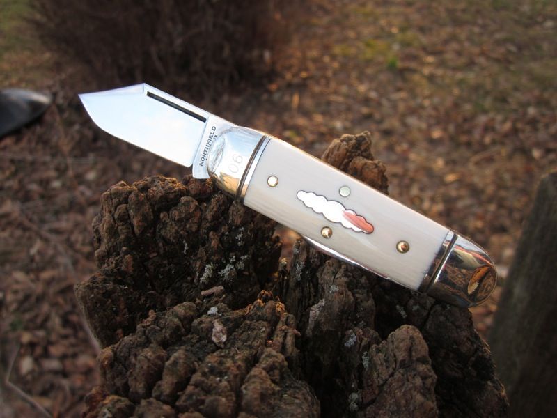

Are the ivory pins nickel silver? also the center spring pin? I ask since i'm making an ivory scales one, and if the Master goes with N.S. who am i to dare ss pins? ;)

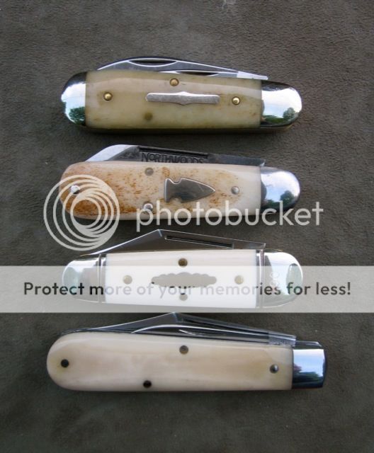

As for ivory, there is truly nothing else like it-- see?
IMG_9686.jpg~original
(One of these things is not like the others.)

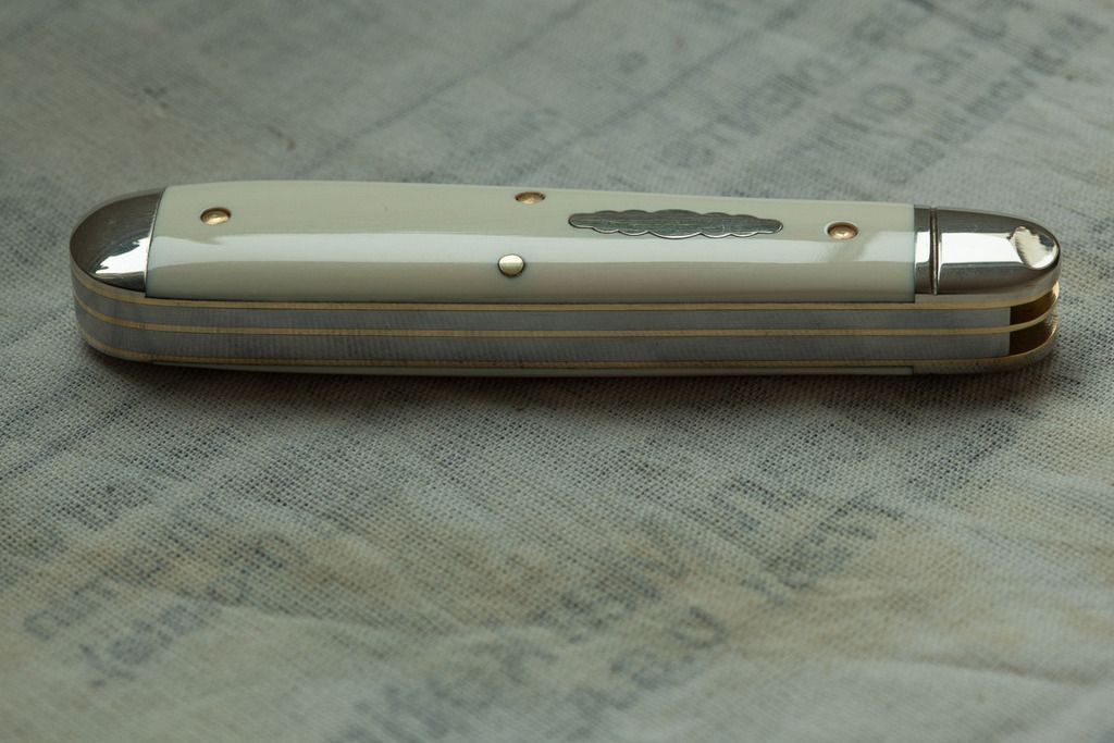

My sole ivory knife, solo:
IMG_6220.jpg~original

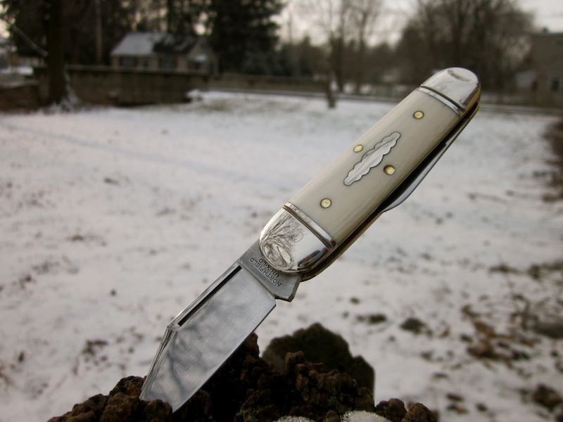

I only have one.
_MG_2080.jpg~original
_MG_2093.jpg~original
