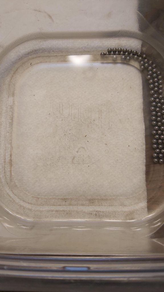

Alright, I got around to cleaning the linear bearing as in the video posted earlier in the thread by 777 Edge 777 Edge . I won't go into much detail since the video does that but I will note my particular experiences.
All the parts ready for soaking minus the red wipers.
What I used to soak them.
Kind of hard to see but there is a fair amount of dirt and swarf left in the bottom of the bottom of the container. I did give this bearing a preliminary cleaning earlier on but did not take it apart. It seems that it should be a required step.
Unfortunately I noticed some crud left over in the bearing race hole in the main part of the bearing so I wet some paper towel with alcohol and pushed it through with a 2.5mm allen key to clean it out. This was a good idea because it seems even a 20 minute soak did not remove some of the crud. I had to push several wipes through each side until they came out clean.
Same thing with the outer races. Lots of grime that needed to be actually scrubbed off.
Thankfully these ones are a bit easier and a qtip worked well. Lots of grime and more metal swarf. While I was at it I cleaned out the race on the base bar as well again due to accumulating grime from the bearings I was unable to clean the first time.
Fully reassembled. There are 44 bearings per side in mine. The gap on both sides is even.
Cleaning did result in a significantly smoother bearing but it is not anywhere near as smooth as the one in the video. There are times where it will hang up and needs to be pushed through and it smooths out again. For the sharpener use it is fine

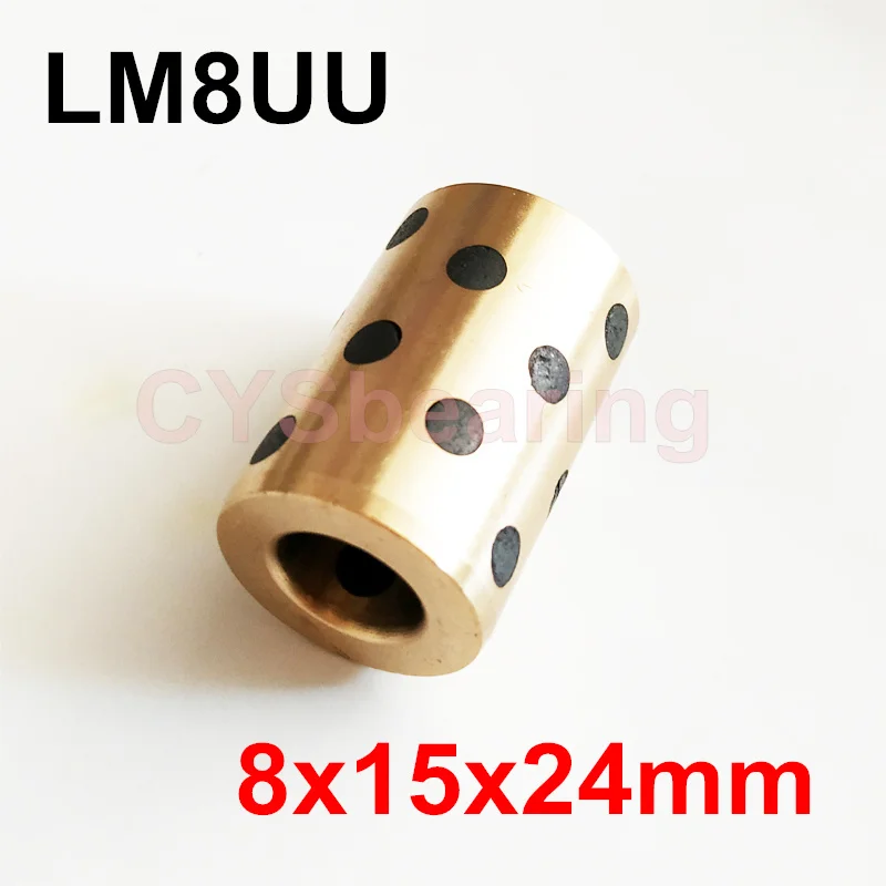

While this one is copper and graphite. Self lubricating.
US $1.47 5%OFF | 1pc 8x15x24 mm linear graphite copper set bushing oil self-lubricating bearing JDB LM8UU LM8 8mm

Thanks for the links, but I don't see a need to replace them. The linear base bearing is smooth enough and works perfectly fine for me, it just needs to be well cleaned before use. The LM8UU bearing(s?) also work perfectly so unless yours come defective there is no need to replace them. If that is the case then Amazon is likely a slightly more expensive but significantly faster way to get replacements since these bearings are commonly used in 3D printers.
Regarding the race do you think the slide action would improve if the voids were filled with more bearings?
I don't have any other experience with this type of bearing so I am unsure if the gap is needed for them to work properly or not or if adding another ball or perhaps 2 to each side would improve things and eliminate the occasional sticking problem. It could simply be a tolerance issue, or the retaining wire is touching the bearings causing them to drag slightly which is preventing mine from sliding freely as the one in the video.
