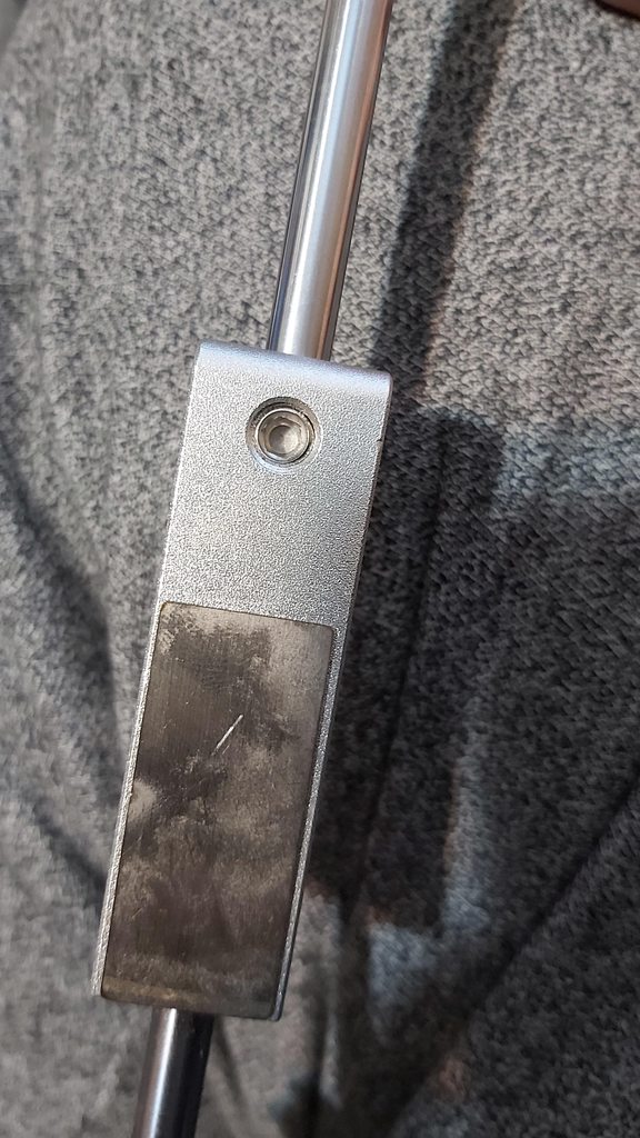

Since you didn't post a picture I am guessing that would be a set screw or a grub screw, whichever you prefer to call it. Not sure on the pitch, but it is a 4mm hex key if memory serves
Wow, that’s the exact piece I missing. I can’t even use my sharpener because the rod keeps falling out… I even notice the magnet doesn’t work on the top for angle digital gauge:rolleyes:
Take the handle piece to a hardware store and see if they can help you find a screw that will fit. It is known that the part for the angle gauge is not magnetic, you have to replace the metal strip or just hold the angle cube in place.

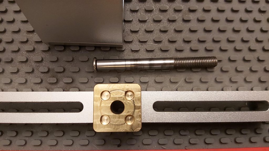

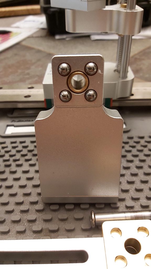

Next up is removing the clamp bar. I noticed a bit more wiggle than I would like and tried to see if I could do anything about it.

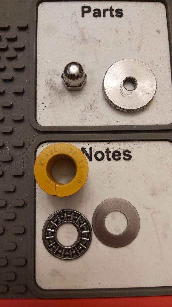

First you remove the cap nut on the back of the thread behind the clamp bar, followed by the knurled wheel, spring and (surprise!) the 2 washers and needle thrust bearing. I did not pay much attention to this area before and did not notice that there was a needle bearing there, I just though it was a washer as it is all it theoretically really needs. Be careful that none of the rollers fall out. The spring has some print on it, appears to be "Ming Li TF 25-25"

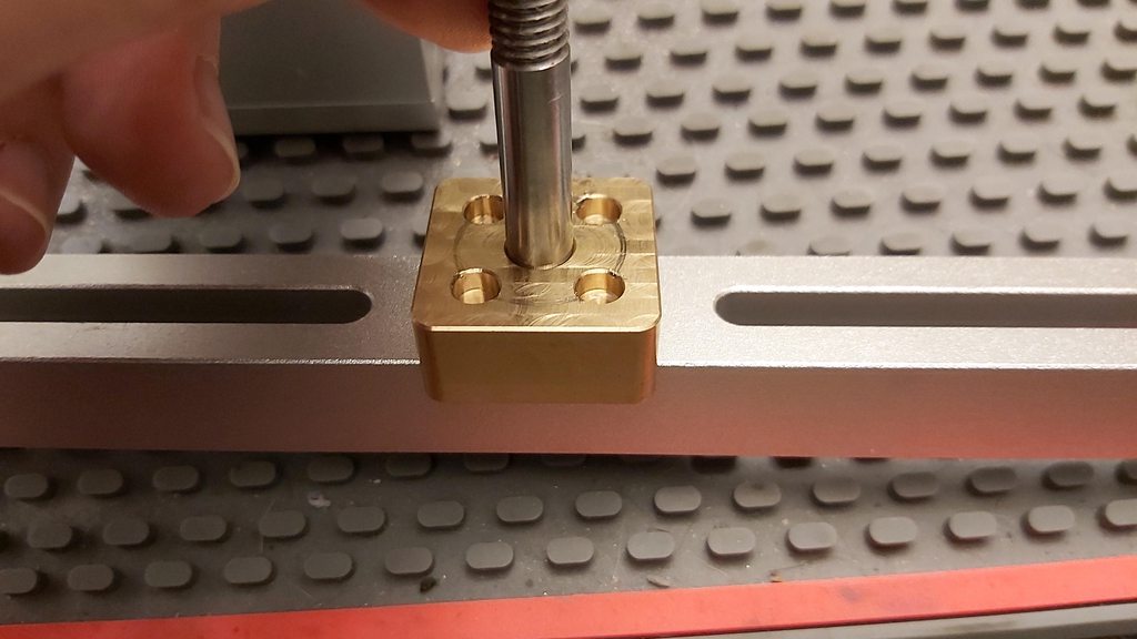

Now you can pull the clamp bar out with the shoulder bolt. The fit between the bolt at the brass/bronze piece was a little loose with a fair bit of wiggle in the bolt. I feel this contributes to a bit of the front to back wiggle that is there.

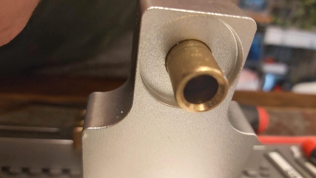

Behind that is a bronze bushing and the bearing balls that locate and stop the clamp bar from turning. The bolt was very snug in this bushing, almost no wiggle at all. I think there may be a minute offset from my bearings and the holes in the back of the piece on the clamp bar which allows it to wiggle up and down ever so slightly even when the tension is cranked way up. Perhaps somebody can think of a viable upgrade to this. I also noticed that it rotates clockwise much easier, it might just be a bit of wear in causing ramps to form at this point though.
The bushing sticks out the back and acts as a guide for the spring and is what holds the washers and thrust bearing in place. I cleaned all these parts to remove a few bits of swarf and foam from the packaging and added a bit of Gunny Glide to the bushing and bearing during reassembly.
It still has a bit of wiggle, enough to throw it of by a small fraction of a degree. Not enough to worry about for most sharpening but it may be noticeable if you are putting a mirror polish on a wide bevel, but variations in stone thickness or dishing could be more of an issue.

This is probably the only part I am a little concerned about with long term use. I can already see a bit of wear on my brass bushing, and it seems that yours is also showing slight signs of wear.
I'm expecting the steel balls to eventually wear out grooves in the brass and for it to pick up slop in the nice solid stops it has right now when you rotate the bar.
If this part was hardened steel as opposed to brass, then it would have been great.

Yes, in many other systems typically the part where the bearings slot into a bushing (similar to this one) it is manufactured from hardened steel. Every system's rotating mechanism is slightly different but most works on the same general principle.
The brass will probably hold up well enough in the TooHR system for general use, but for hard and very regular use the brass will most likely wear out from the friction of the hardened "bearings".
To extend the life of the brass bushing as much as possible, I would recommend that the rear spring tension is kept to the minimum necessary.
That being said, this is an epic system for the money and I'm glad I have one.
That "receiver" for the steel balls to locate to looks like brass to me, not bronze, which is much softer and easier to machine. As has been said, it is the wrong material for the job. Personally, I would use a nice lithium based grease for the thrust bearing and bronze bushing as well as the locating balls.
I only see one washer with the thrust bearing, there should be two?

Yeah, you can already see the groove and I have mostly kept it on light tension. Next step would be to find somebody with a mill and see if they can make a part out of steel, maybe with a bronze bushing for a tighter fit on the bolt. If it is possible then it might be worth having a small run of them done of the price is decent. If that turns out to bee too expensive then perhaps a steel washer with 4 holes in it could be used as a sacrificial part. Install it, add some loctite or even super glue to the back between the brass part, tighten it up and let it set and it should hold fine until it wears out.
Hmm, think I have a tube of lithium grease out in the shed somewhere. There are 2 washers on the thrust bearing, the 2nd is under it, I didn't want to set it on the mat and pick up some junk.
