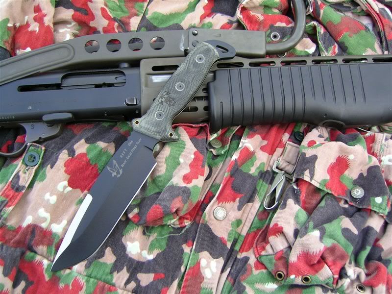

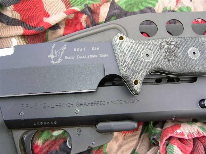

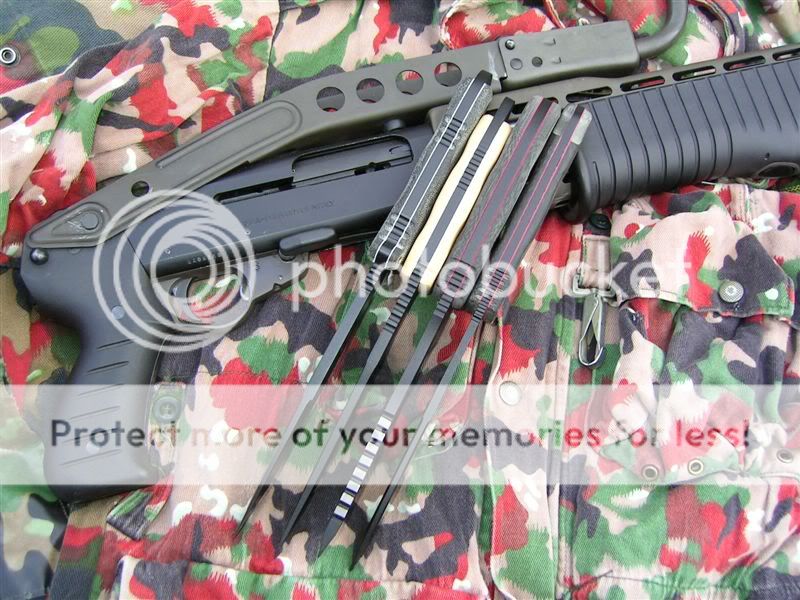

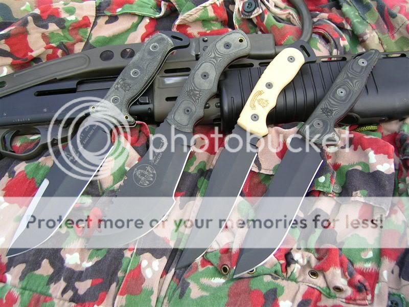

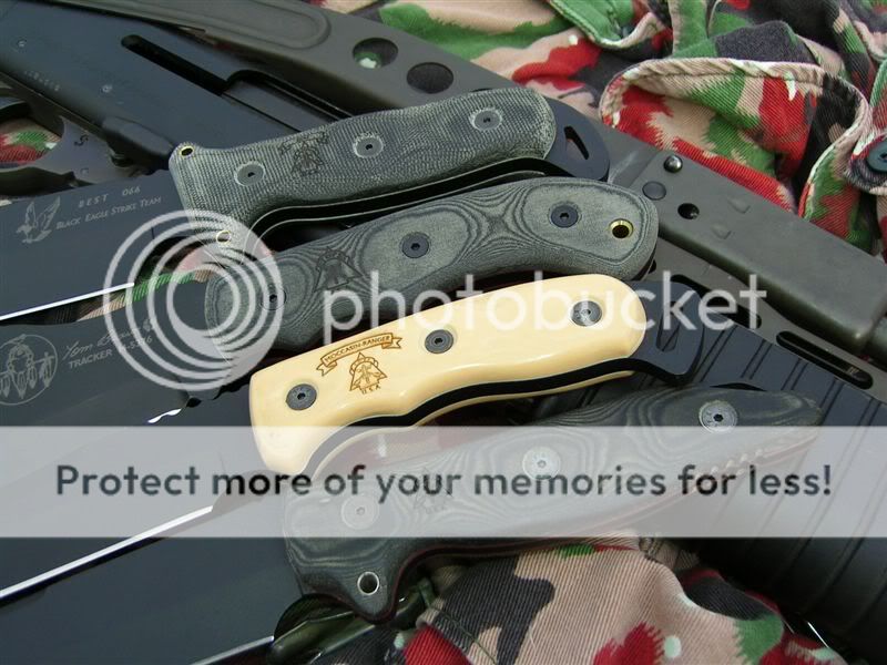

Gentlemen
Here are some of my TOPS knives.
They work great as camp knives but the Cold Steel Trailmaster will outperform them all.
Cheers,
André
imo the cold steel trailmaster will outperform them because it is flat ground. i don't know who came up with the idea to put a short hollow grind on a thick spine but to each their own.
It is cost efficient, there is a strength issue, but generally you are much better off changing the stock thickness if you need that much raw strength and going with higher grinds to get the same strength, weight and better cutting ability. Hollow grinds are also problematic on large knives like that due to the way they don't support the edge, if the edge suffers failure it can lead to a blowout of the primary grind. Plus the grind inherently will focus loads across the edge making it much easier to blow them out.
-Cliff
Great pics Andre - confirms my suspicions of narrow grinds on thick stock. Tough - yes, good cutter probably not and your comment about the Trailmaster outperforming them is very telling.
