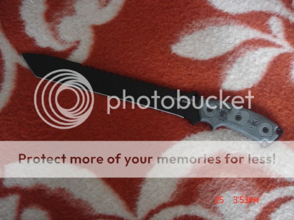

I find it interesting that of the pictures posted, particularly from people who "love their Tops" that none show any wear whatsoever. It makes me wonder how at least these individuals can laud the product without even using it. At the least, it only partially answers the original poster's question. I didn't think there was much of a collector market for these either, but maybe I'm wrong. My $.02.
:D :D As I said, I love the designs. I bought them more for my collection, although I have used and sharpened the Scalpel & Lone Falcone, but not enough to really show on the coating. :D :D
