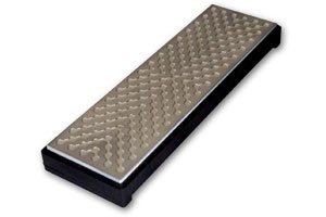

I want to find out which ones can be expected to be extremely flat, and which ones will be a "they tried to compete with the others and failed" type stones with raised edges or valleys along the interruptions in surface. I know DMT hones are extremely flat, they use it as a key part of their advertising, but what can I expect from the other makers?
Norton
Buck
Smith's edge
Lansky
EZE Lap
If they can all be expected to have valleys or peaks or raised edges, then I will keep saving my money and continue being a loyal DMT fan, but certain deals I have found slipping my way, and would like to take advantage of them. On the other hand, I don't want to make a mistake with a subpar quality stone just for the sake of saving a few dollars. Thanks for your time.

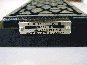

Don't forget to consider high-end Shapton diamond flat stones from Japan:
Shapton Diamond Reference Lapping Plate (DRLP)
"plus or minus 3.5 micron tolerance"
http://www.jendeindustries.com/mm5/...JENDE&Product_Code=1019&Category_Code=SHARPEQ
Shapton Diamond Glass Lapping Plate (DGLP)
"The result is a flattening plate with a production deviation of ± 5 microns"
http://www.jendeindustries.com/mm5/...JENDE&Product_Code=1037&Category_Code=SHARPEQ

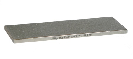

DMT Dia-Flat Lapping Plate (I think this is what you mentioned):
"Precision ground flat to +/- 0.0005" [inches]"
http://www.dmtonlinestore.com/Dia-Flat-Lapping-Plate-P80C15.aspx
Let's convert everything to microns so we can compare.
0.0005 inches = 12.7 microns
So on paper, the Shaptons are flatter.

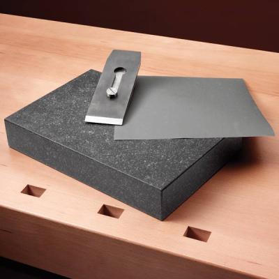

If you need just super-flatness, but without abrasive, there are machinist granite surface plates, and machinist cast-iron surface plates. They come in various grades. Here is one that is (on paper) flat to 0.0001 inches (about 2.54 microns). Wood-workers often use it with sand-paper to sharpen chisels. Machinists use it to check the flatness of parts, and to do precision layout. There are higher grades of surface plates, which are even flatter. btw, the link below is to cheap made-in-China surface plate, so it's not clear that it actually obeys its specifications on paper. However, if you buy a granite plate from a real company, such as Starrett or Mitutoyo, they can be purchased with certified calibration reports which are tracable to NIST (the National Institute of Standards and Technology http://www.nist.gov/index.html ).
http://www.woodcraft.com/product/2004864/7535/granite-surface-plate-9-x-12-x-2-a-grade.aspx
I have a dial indicator, with a small granite plate that is supposedly flat to 0.00005" inches (1.27 microns), but dial indicator is only accurate to 10 microns (it's a real dial indicator from Mitutoyo). The stand I'll be using is this one, but the cheapo dial-indicator has been replaced by the Mitutoyo dial-indicator:
http://www.amazon.com/gp/product/B002BRUUCI/ref=oh_details_o03_s01_i00
This is a cheapo stand (made in China for sure) and does not come with any certified calibration report, so I don't know if it really is flat to 0.00005 inches. But it's the equipment I have, so I'll try testing with it, although one would have to take the results with at least a few grains of salt.
If there are machinists who are reading this, please consider testing the flatness of some of some diamond stones on real equipment (ie: stuff which is actually of high quality and has certified calibration tests). We would love to get real numbers from real machnists using real measuring equipment. If you have a CMM (Coordinate Measuring Machine), that would be _awesome_.
