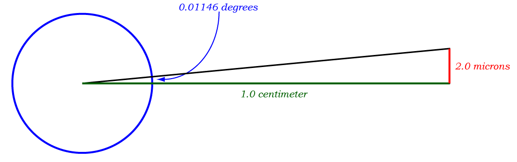

Here is another way to think about 0.01 degrees: How big of an angle is 2 microns over 1 centimeter? Using the small-angle approximation for trig functions: (0.002mm/10mm)*(180/pi) = 0.011 degrees.
A micron (0.001 mm) might seem so small as to be inconceivable (and thus ignorable), but I disagree. Visible light ranges from about 0.4 to 0.7 microns. So when you are stropping with green chromium-oxide (which is typically 0.5 micron grit), you are already working at the optical level. I think this is why woodworkers say, if you can see a glint off the edge, it is not sharp. But if you cannot see a glint, then it is sharp. My guess is that once the edge gets significantly smaller than an optical wavelength, you cannot see it anymore. (I'm 100% not sure about this, because I don't know enough about the limits of human vision, and although I am a physics major, I don't know all the details of what the surface roughness looks like microscopically, and how the light would bounce off of that in terms of diffraction.)

I'm asking because a right-triangle which is one centimeter wide, and two microns tall represents 0.011 degrees.
So if your sharpening rig is about 1 cm long, you need it to be precise and rigid to 2 microns. That is a tall order.
If your set-up is about 10 cm long, then you need to be precise and accurate to 20 microns. Now, 20 microns is 0.00079 inches, or 0.79 mils. That is more accurate that many imperial calipers. In other words, even if you measure your machine with imperial calipers, that is not accurate enough to guarantee 0.01 degree accuracy.
So if a machine is accurate to 0.01 degrees, its errors due to slack or gaps in moving parts, and also rigidty, must be smaller than 20 microns (say your machine is about 10 cm). I think 20 microns is very small; it's less than 0.8 mils. How often in machine shop, do you make a part with your own hands, that has accuracy of 0.8 mils (20 microns) ?

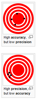

There are scientific instruments which output a voltage. Since voltage is just a real number, these devices have infinite resolution. Even if the instrument were to have infinite resolution, it could be inaccurate and/or imprecise.
We are not talking about resolution. We are talking about accuracy and precision.
https://en.wikipedia.org/wiki/Accuracy_versus_Precision
https://en.wikipedia.org/wiki/Repeatability
https://en.wikipedia.org/wiki/Sensor_resolution#Resolution
https://en.wikipedia.org/wiki/False_precision
I'm not speaking about these terms casually; they are technical terms in science and engineering. In research papers, they are debated, and if one makes a mistake with them, then the science can be bad and the paper will be rejected from publication.
Resolution is not the same as accuracy.
Repeatability is not the same as accuracy.
Precision is not the same as accuracy.
Sensitivity is not the same as accuracy.
Repeatability is not the same as precision.
Precision is not the same as sensitivity.
etc.
Both precision and accuracy are necessary for a good measurement. Either alone, is often not enough.
This serious when doing science: if one were to make mistakes about these, then the resulting science could be flawed, and the paper be rejected from publication. It is as important as statistical significance.
And the rejection would be justified; building a high-tech bridge with significantly flawed science (say, where precision is confused with accuracy) is a bad idea. And false precision has lead to disasters in the past, so this is not anything new.
