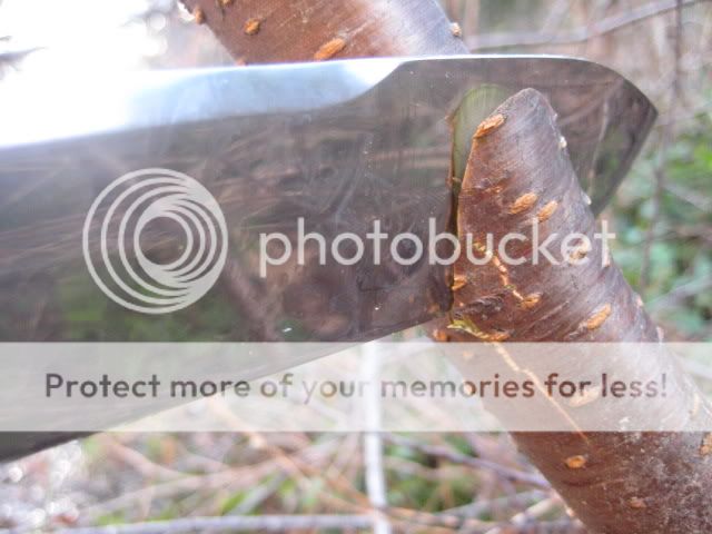

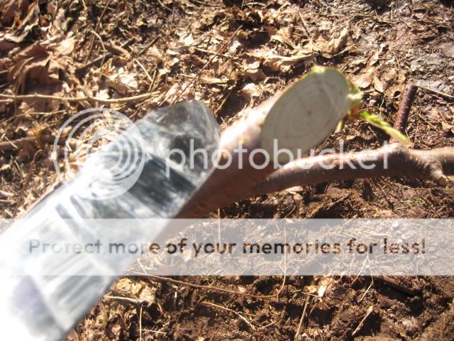

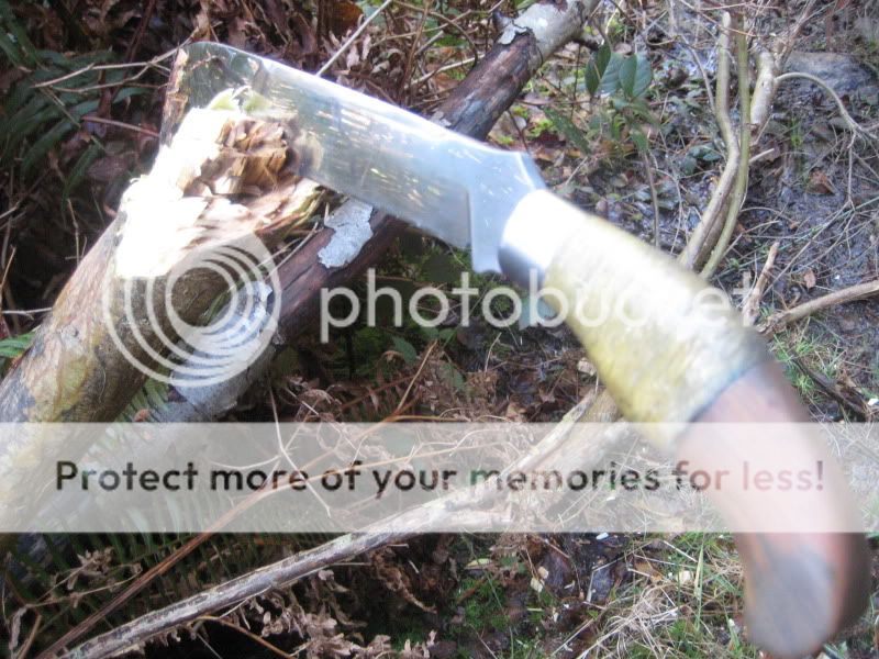

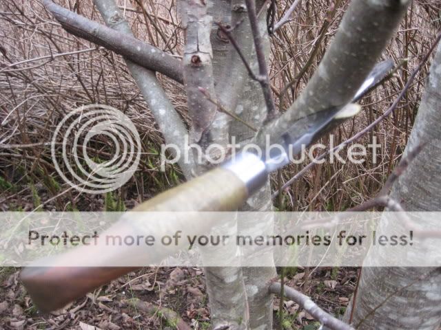

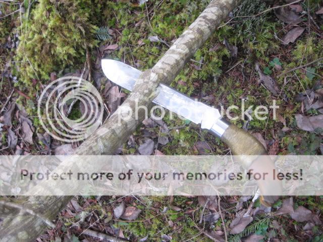

Got er out today for a spin in the woods.
I'm very pleased with the performance, but I'm going to rewrap the handle. It just ain't quite right.

The journey ain't over yet! I know now that the knife performs pretty much as intended, so I think I'm going to revisit the handle and get it just right.
It is hard to know exactly how a knife is going to work out until you either have full sized mockup or the real deal in your hand. Especially if you'll be designing one on paper.
Lorien when you get that handle all wrapped and the blade is as sharp as you want, hang up one of your bike inner tubes and give the lose end a chop. If it is as sharp as it should be, you won't have any trouble cutting it. If it is not sharp, hang on good because it won't cut it. That stuff is grabby and it takes a sharp edge with good geometry to cut.
I have never been able to get a knife to cut a hanging inner tube with any consistency! I haven't tried too many times, do to the potential for disaster, but I'll take your advice and make it one of my standard edge tests. I don't usually require an extreme level of keenness from my bush blades, but I do generally believe 'the sharper the better'!

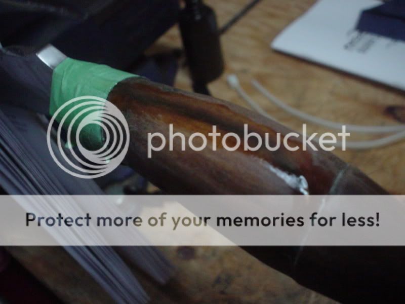

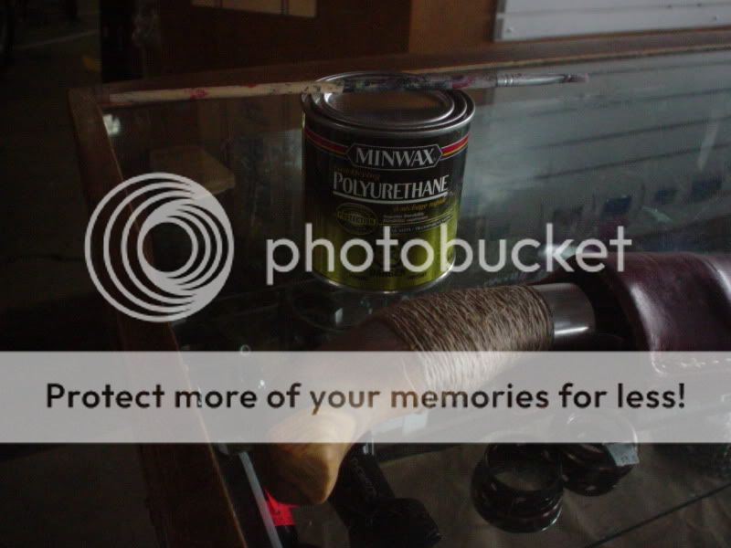

Harry, I did take your advice and I Crazy glued the crack in the handle:thumbup::cool:

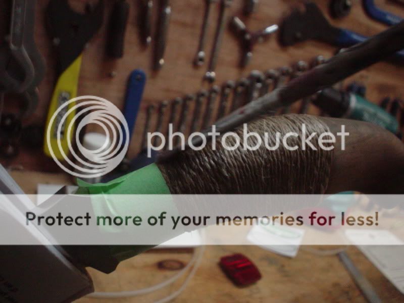

Glad you tired the crazy glue Lorien. It will be interesting to see how this handle holds up. I know you will put it through some tough use. What kind of finish are you going to put on the binding? Have you thought about using something hard that would help the binding support the wood underneath, like epoxy? It would make a layer kind of like micarta... I guess.
I thought epoxy would be the best choice Harry, but all I have on hand is polyurethane. Do you have any specific suggestions for epoxy?
I've used spar varnish and while it hardens up nice, it's kind of smelly. I don't know how this polyurethane will do, since last time I applied it over the spar varnish it never hardened. Just stayed sticky and felt really gross. But I think I'll try thin coats of it this time and hopefully it will end up nice and hard and I can sand it smooth where it needs to be and keep it tractiony elsewhere.
I can always cut the wrap off and try it again if it doesn't work.
I would use some acraglass from Brownell's, but most any slow cure epoxie should do a good job.
Pop's Knife Supply has some very good 2part epoxy(s) that have done me well on a couple pictures. Someone on bladeforums turned me on to their website and they are really friendly folks!

Hi Lorien. Your blade looks like it cuts really well. Nice and clean and deep.
How's it handle with the angle of the blade to the handle? It must throw the tip down and make for some wicked speed and great "flick" cuts.
For epoxy, you can get some West System stuff locally. There's different hardeners, Fast, Slow (though the difference is like 12 hours or 16 hours so I wouldn't call fast very fast); and there's a 207(?) coating hardener that's clearer than the others but I haven't tried it.
If you're planning to sand the epoxy, it tend not to go all shiny or anything but rather opaque.. I'd try a test to see how it'll work. If you don't like it, you won't be able to cut the wrap off. You'd have to grind it away.
The Polyurethane glue is likely a recipe for disaster. I'm surprised it didn't foam up on you last time.
grlangr- :):):) I'm so glad you have found this thread to be inspiring. It wasn't my aim to inspire, but if that was the effect then I am proud of that achievement.
I've checked out the West Systems stuff online, and I think that I will order some. In order to soak into the hemp twine, it's gotta be pretty aqueous.
Instead of spending more money on stuff, I'm going to just use what I've got on hand. But this time, I'll follow the instructions when I apply it;):D
