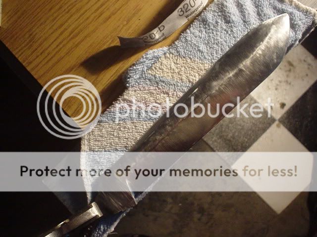

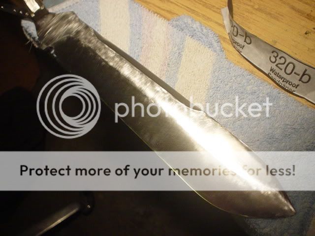

If you sand somewhere around a 30-45 degree angle from the centerline, then you can just switch to 30-45 degrees in the other direction with the next grit. Accomplishes what you're doing here, but more than twice as fast.
I don't worry about a smooth, full drag pull on the sanding strokes until I'm on the last grit.

THANK YOU! man what a difference that tip made!:D
I almost see the light at the end of the tunnel...
my life has been absolutely nuts! And it's only getting nuttier over the next couple of weeks. It's been an exceptionally busy late summer here at the bike shop, and I've just added the ludicrous proposition of moving my business at the end of the month:eek:! Moving on up:D:thumbup:!
Suffice to say, I've been starved of spare time. Anyway, I've got the blade down to 320 grit and we'll see how things go, but I might just finish it at 400.
Nick pointed out that the longitudinal sanding strokes were counter productive and man, was he right! It took probably an extra hour just to correct some of the deep scratches I made. Oh well, live and learn:).

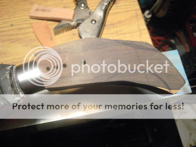

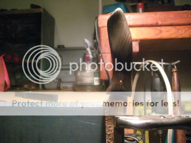

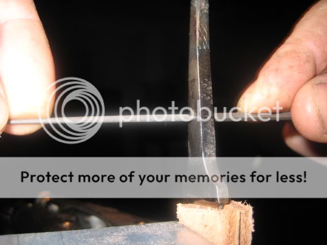

As can be expected the hole I drilled in my tang does not match up to the hole I drilled through the handle. There are many reasons that this happened, and I won't go through them all here. The important thing is that I've kept track of what those reasons are and hopefully will not revisit them in the same manner. Now that I think of it, maybe I should refer to those reasons as 'mistakes'.
Here's the action shot:
At least the initial hole is large enough for me to not miss. Oops, I missed! Here you can see how I had to remove material to get the pin lined up through the tang and both sides of the handle.
ok, they kind of line up now.
this shot is a little cleaner. The grain in this lignum is really pleasing.

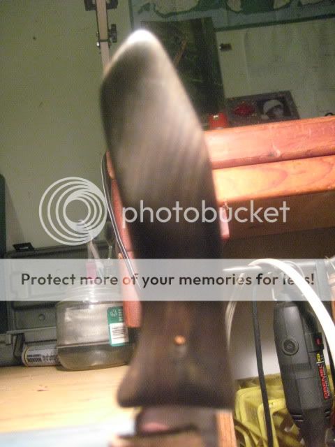

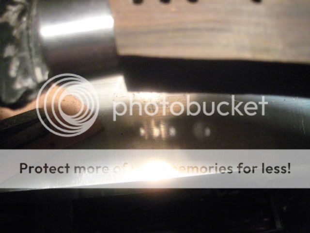

What you didn't see in the previous picture was how butt ugly the transition between the handle and blade is. It looks terrible, and not only that, there's a big gap on either side of the blade because I removed too much material. It will be filled with epoxy, but look like shit no doubt. I was going to use a little piece of titanium as tsuba, but it was so hard to work and get done right, this project kind of languished because I could not get past that issue.

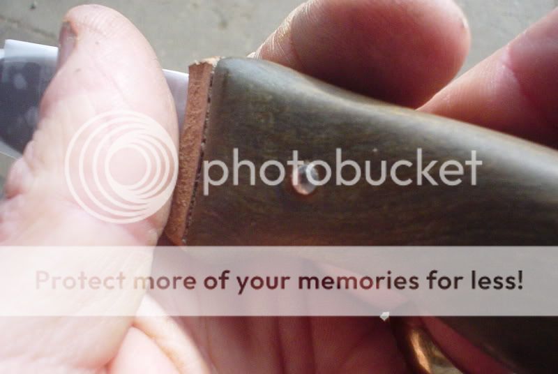

Last night I stumbled into the idea of making a leather tsuba, (not really the right word, but I'm not sure what else to call it). The project is back up and running:).
here's the little guy with the leather 'tsuba'. I will glue it to the handle with Gorilla Glue tonight, and then trim it down so that it matches up to the handle. I won't leave it sticking out like that.
here you can get a gist of how crappy the knife would look with nothing in front of the handle.

And thank you sparrow75, the handle kind of looks like a piece of poo to me. But, it feels really comfortable so I'm good with it:)

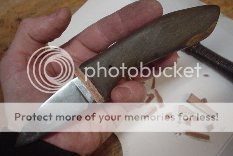

I should really be working, but I have this knife to finish...
trimmin my tsuba with my Goo leather trimmin knife;
she's starting to look kind of ok.

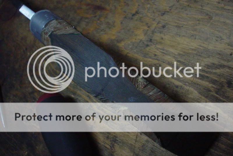

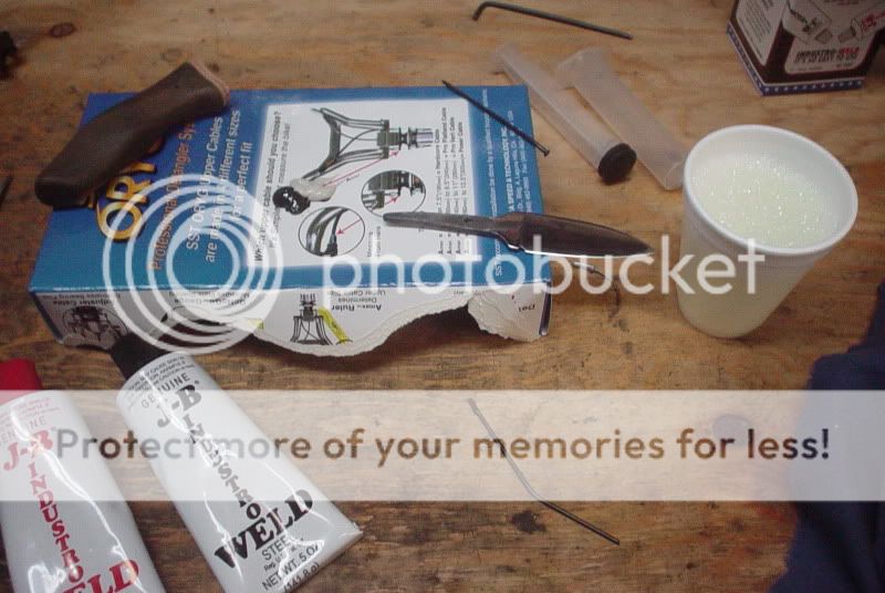

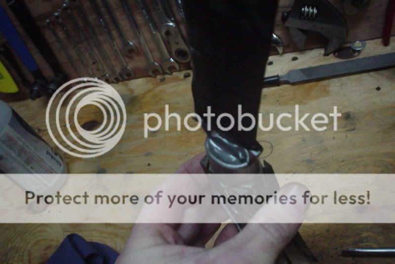

and now on to the epoxy. I'm using JB Weld, which is pretty amazing stuff.
I found a syringe which I'd usually use to bleed hydraulic brakes. Not any more! Worked great by the way and kept things pretty neat.
I mixed up more than I thought I'd need, and I was right. There was epoxy everywhere! I planned ahead, (for once) and had a cup of warm soapy water and a rag close at hand and the extra cleaned right on up.
I had to laugh when I saw how crooked my pin was. It doesn't matter and it will be unnoticeable once it's cut down and peened.
sort of almost looks like a knife!

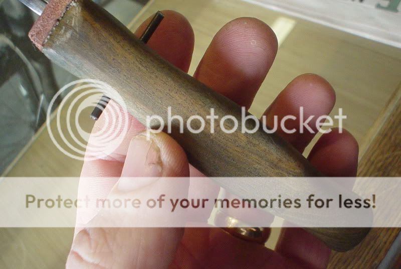

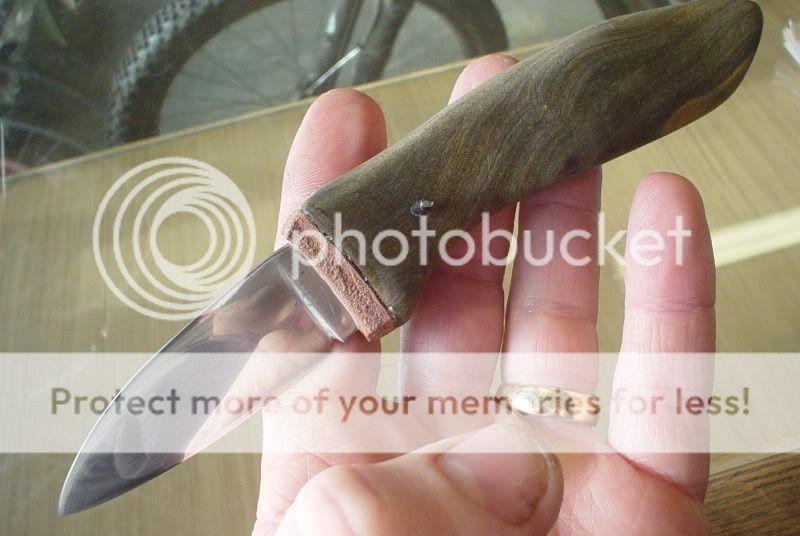

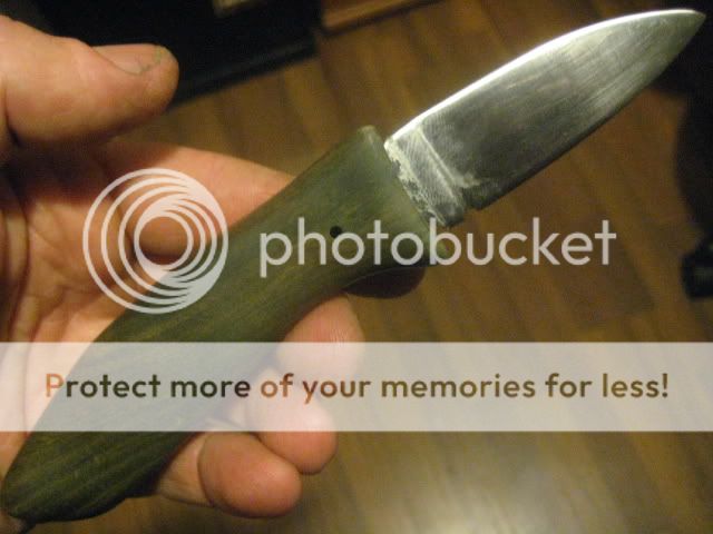

the little knife is just about finished. Blade is pinned to the handle and epoxied, leather tsuba is varnished and will need another coat or two before I'm totally happy with it.
Here are some more pics:)

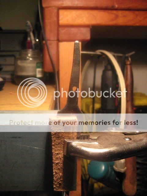

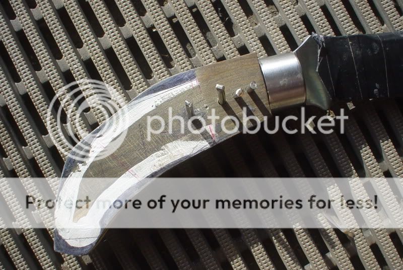

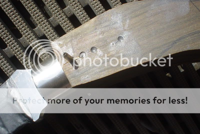

I epoxied and pinned the handle on the big knife. I totally screwed it up and I'm not real happy about it:mad: I rushed it when I knew I should have take some more time. Good lesson learned there.
However, all is not lost and I believe I can still make a reasonably good knife out of it. But we'll see.
Here's how I screwed up;
I really wanted to have three peened pins showing. Then I was going to wrap the mid part of the handle with hemp twine.
As you can see, the pins didn't make it all the way through and not only that, the wood cracked a bit from me trying to force them through.
And not only that, it snugged everything up so tight, that my ferrule is crooked.
The best part of not having a plan is that adaptation to unforeseen difficulties is expected:). I do have a way to 'fix' all these problems, without starting all over again.
I'm soldierin' on with this bad boy. Thank you Harry for your kindly advice and insight!
