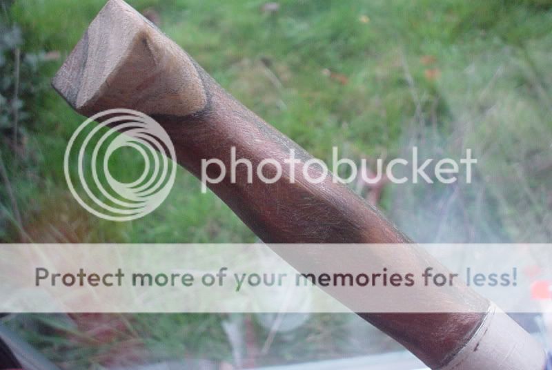

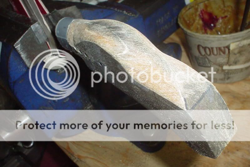

I removed the larger chunks with a hacksaw, and here you can see that I've started filing away at it;

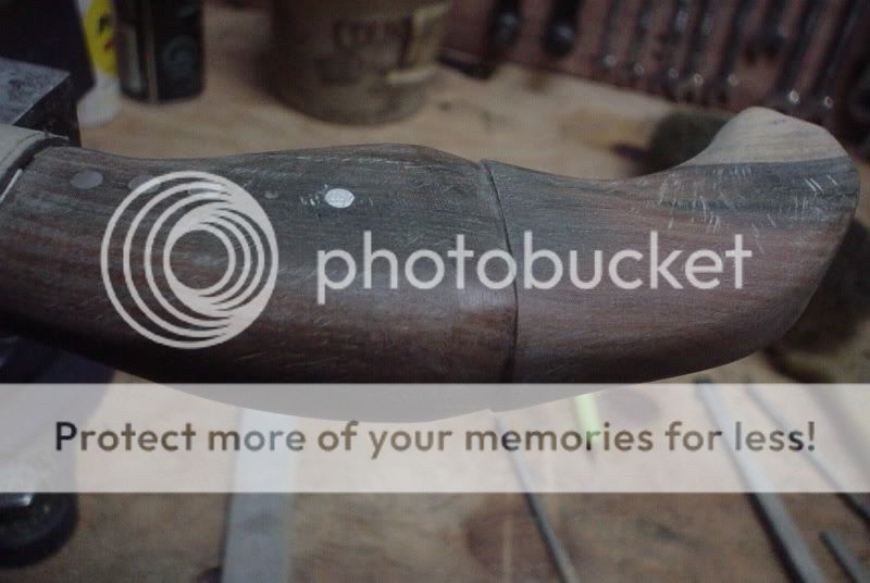

After a day of filing away at that handle, in between bike repairs, here is the result;
Today I'm going to refine the shape of the handle and start sanding it a bit.
The crack you see at the top of the handle is definitely not a good thing. So, the forward part of the handle will be hemp wrapped and sealed. Initially I was planning on starting the wrap just behind the first three pins, but since they didn't work out, I'll be wrapping from the ferrule to just past the palm swell.
The hemp twine I'll be using has great tensile strength and isn't overly thick, so I'm hoping it will deal with abuse well enough, but time will tell...
One thing is for sure- the feel and balance of this knife is great so far!:D:thumbup:

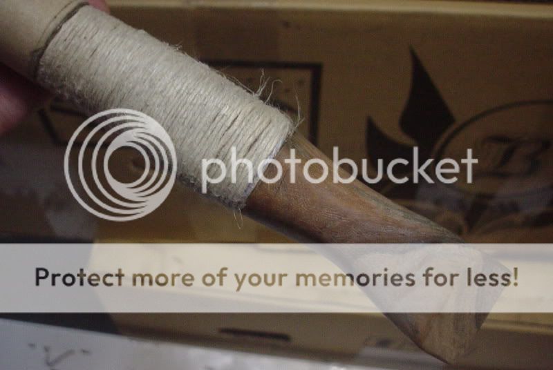

I'm soaking the hemp twine in warm water. Thinking it will shrink a little after I wrap it. We'll how how that works out.
Handle's pretty much shaped to my liking at this point, so wrapping it is going to be the next step.
Lorien you might think about blowing those cracks out with an air hose and trying to wick some superglue in them. Might not help much, but it couldn't hurt.
Harry, I hadn't thought of that, and it's not too late yet to try:thumbup:

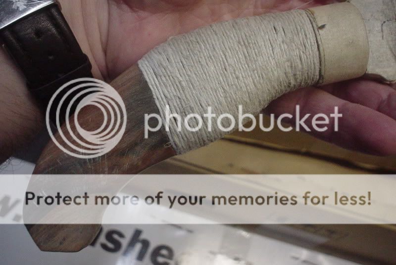

This is how it went today;
I filed a groove around the circumference of the handle so that the hemp cord would be flush with the end of the handle. I had to unwrap the handle once and redo my groove, but I'm pretty happy with the way it finally lined up.
Here's sort of how it will look with the wrap;

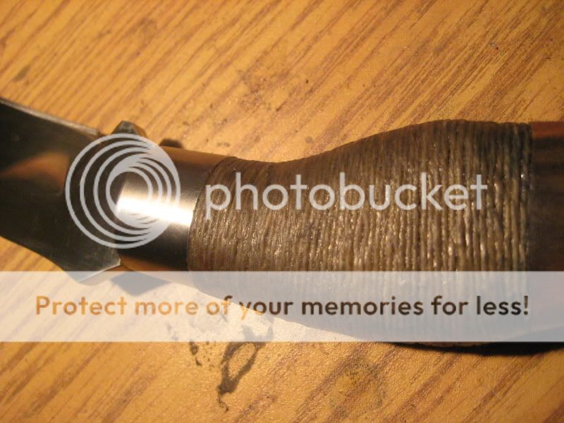

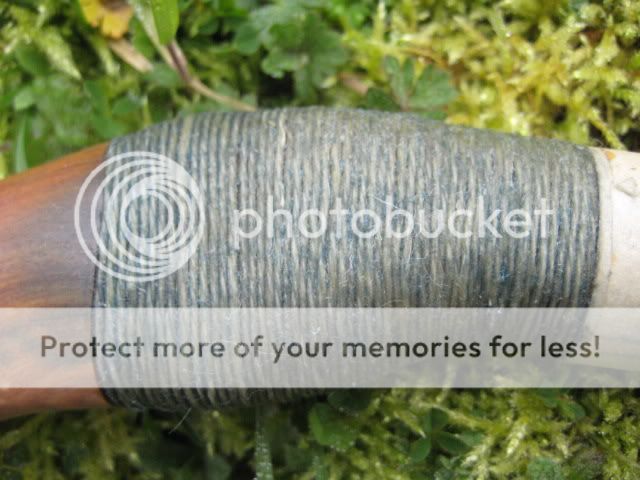

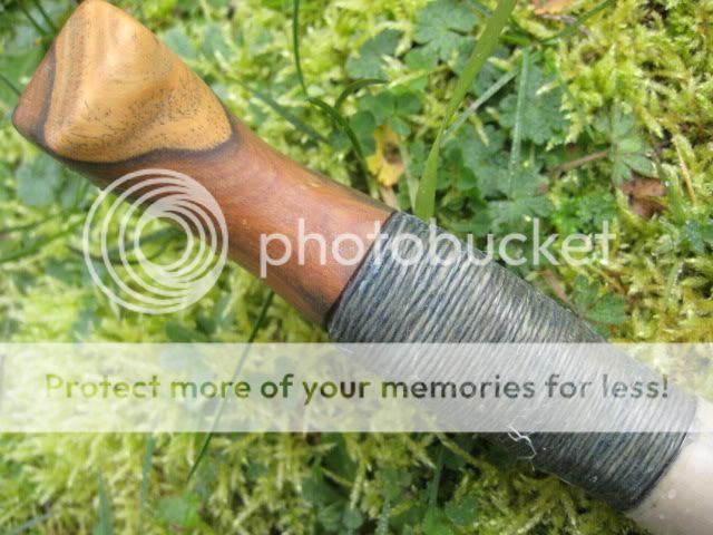

I tried something a little unusual, which turned out really cool.

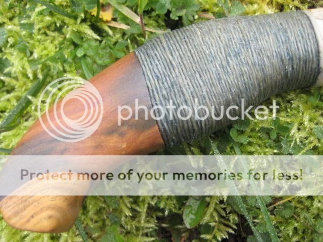

The lignum vitae that I'm using for the handle is really interesting stuff. Not only is it incredibly dense and oily, but it oxidizes in air and changes color from rusty red to a slate green.
With that in mind, I kept a small amount of dust left over from sanding the handle, and stirred the dust in with the urethane sealant I'm using on the hemp wrapping. What you see in the following pictures is the color which that mixture created. I like it a lot!
I have one more coat of clear satin urethane drying right now and will probably do one more coat, but the handle is pretty much done. I'm really excited to pull off all the tape and see how it looks as a whole. The last steps will be to apply an edge, and then make a sheath, (Dang! I'm out of leather:().

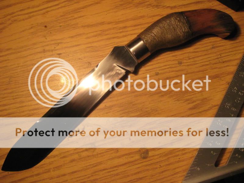

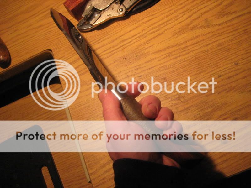

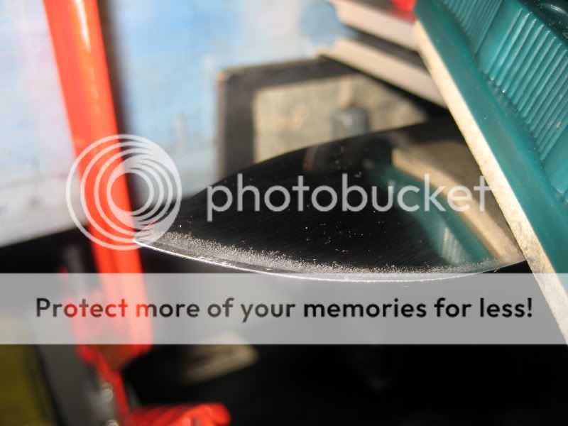

it sure is time consuming to apply an edge without the use of a belt grinder.
I'm using my Lansky system to get the edge right, and the picture I've included is from last night. I got a whole lot more done today and the edge is a c hair from being done. It will be worth the trouble, as I have been finding out that Nick W's heat treat of the blade is bang on!
There is no better way to find out the hardness and toughness of a blade than to sharpen it.
I'm working it toward a 20 degree bevel overall, and there is a little meat toward the edge which should add a lot of durability, but hopefully not at the expense of a good working edge.
Tomorrow I'll bring the edge to its final polish, make a couple of minor touch ups and I'll be able to call this knife COMPLETE! Oh yeah, there's still the sheath, so maybe not completely complete, more like mostly complete:p

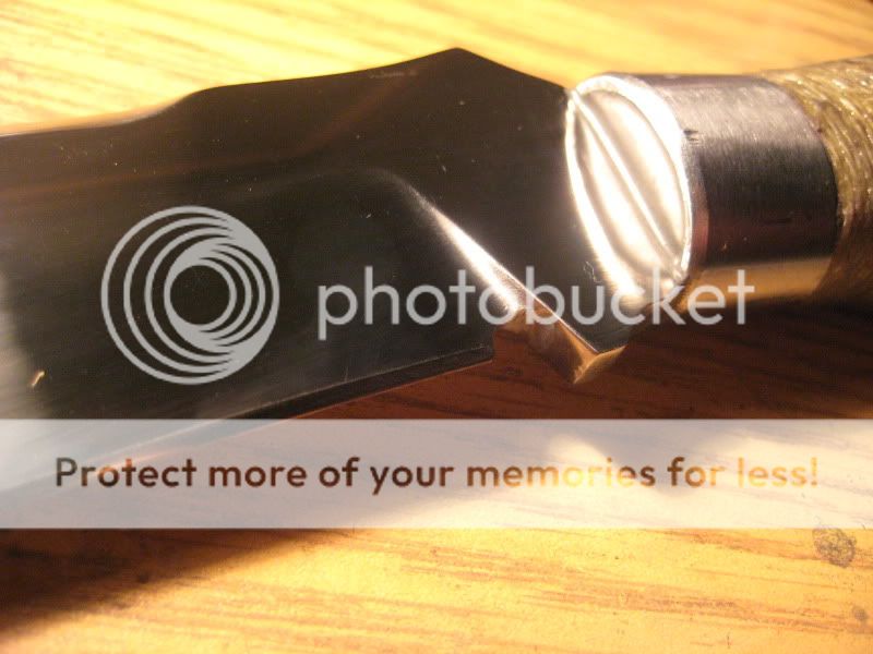

There's some really fine work in this, particularly that ricasso/plunge shot. Nice work.
Interesting if unusual design and it has a real Indonesian feel to me.
I'm looking forward to hearing how it performs and of the real thrill of using your own work.

I snapped just a couple of other pics this morning;
This knife's name is Lorlok:D
