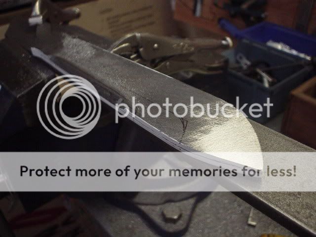

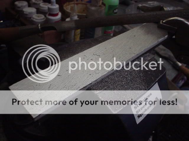

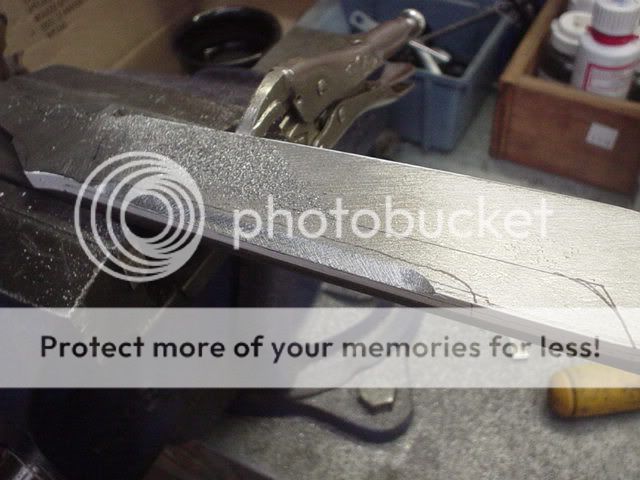

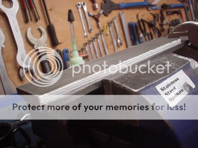

Like I said, I didn't want this to be a wip thread, mostly because it will probably take forever;) However, being a full on rank nOob, I'm starting to think that there might be some use to other folks who might not think they can make a knife. Like posting my picture of hacksawing through mill scale. I didn't know! Now I do, just like that. Sure, I could've found that info by researching, but like Ray said, busy season is coming and research takes time. Why not make stupid mistakes and get corrected so other people can learn? This thread is more a practice in humility, and I expect lots of great humbling experiences so long as I keep posting pictures;):).

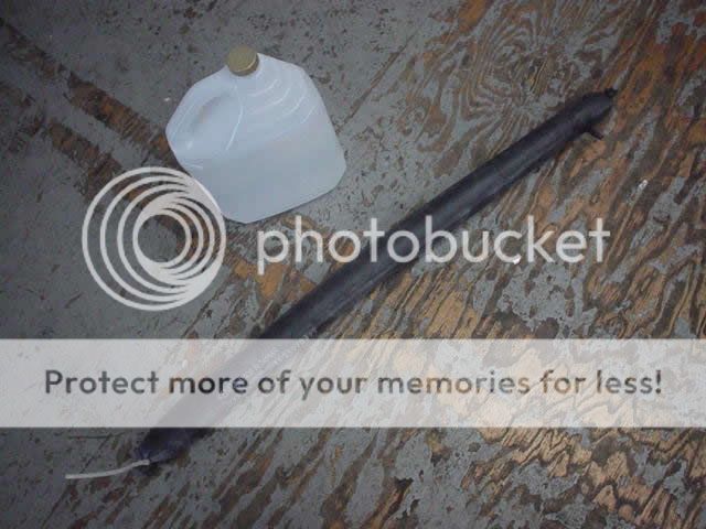

ghetto etching tank, made from a bicycle inner tube:barf::D
I can adjust the volume of my tank using a pump!
Yeah, I know...:rolleyes:
necessity is the mother of invention.

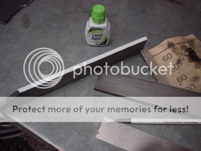

materials so far
hacksaw blades.........$6:D
steel..........$0:D:D
vinegar.......$3.50
seeing this etch tank picture-------priceless!!:D:D:D:

if you use the draw file method, be careful when you start to get an edge so you dont slice your finger. to keep from getting cut, cut a slot in a small block of wood and fasten it to the file between your hand and the edge. use chalk to keep the filings from loading the file up.

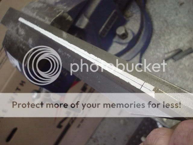

Ummm did you ever think about drilling a series of holes around the outline and then cutting through the web between to speed up the process and the expense of saw blades? :confused: You'd think you'd never made a knife before :p

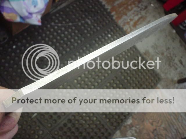

here's the progress I made over the course of the day yesterday;

It looks like you're coming along great Lorien! From the sharpie outline I think you'll want a bit more shoulder to seat the guard against, but that may just be me. :)
Remember to keep that blade supported while you're filing on it. I can see you've got the bar under it. Angle iron works even better as it won't allow any flex. :)

Lorien, looking good and I'm guessing that the vinegar soak helped :p There's a lot more to this knifemaking thing than just rubbing the steel against something abrasive :D
