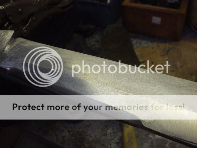

I'm usually antsy when it's slow in the shop, but I kept myself busy today!
I'm torched! That's burly work, my abs are hard as rock at the moment, so to soften them up, I will drink a beer:)

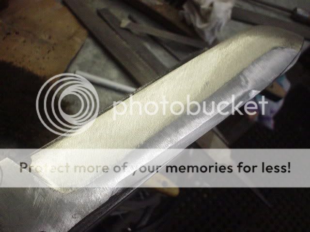

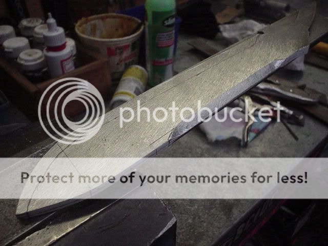

Lorien, here's a free tip for you. You'll go through fewer hacksaw blades and files if you remove that gray stuff on the outside of the bar first. ;) If you have an angle grinder, that works great, or you can soak it in acid overnight.
On the other hand, if you want to enjoy learning all the fine points yourself, forget I said anything. :D
I'm looking forward to seeing the finished product.
that tip would have saved me some time when I made my first and only knife by hand with files, and a mini hack saw. I did not have a vice. Only some c-clamps and a board for a table. With 1/4 5160. It took a while.

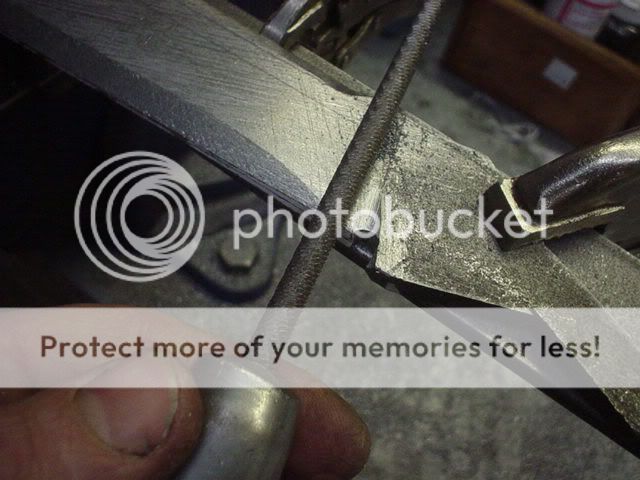

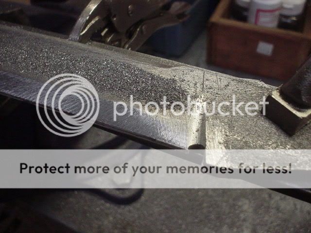

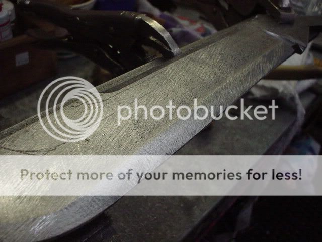

A couple of filing tips:

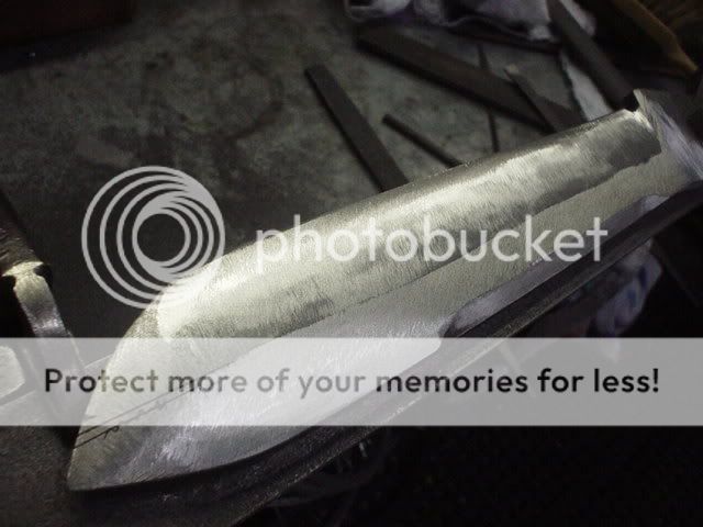

Your grind line should follow the cutting edge. That way you maintain the same bevel/angle all the way from the ricasso to the tip. A change of angle becomes very visible when the blade is polished. I scribe this line into the steel with a scriber. Take care not to go over this line, it is difficult and time consuming to correct.

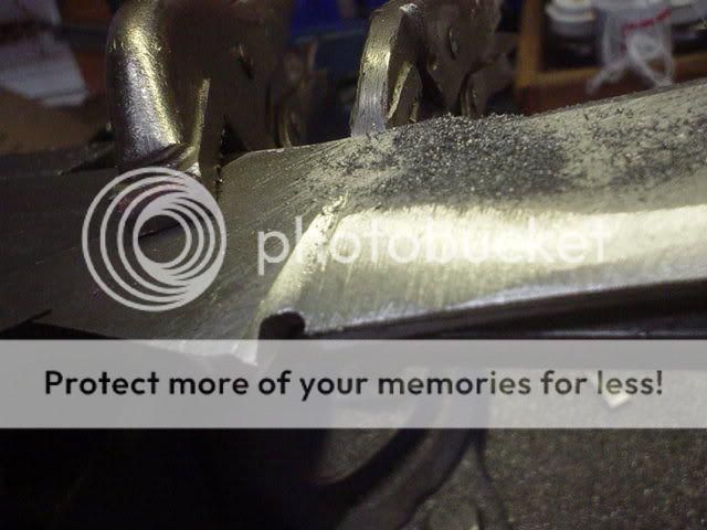

I use a chainsaw file for setting the end of the grind at the ricasso. Unlike the rattail files, it is straight and gives you an even radius. This generally looks better, and will make for easy sanding. I file this groove to about 90% depth while the blade is still flat. This gives you a defined starting point for the grind line. I blend in the remaining 10 % while filing the flats. This will prevent the little dip that that can result when cleaning up this area.
When filing the actual "grind" file the entire blade length in one direction. Place a light perpendicular to the file marks, this will make the file marks show up white. To ensure your file work is flat, file the entire blade in the opposite direction, your file marks now show up dark. This will show you any areas that may need correcting.
Until you are experienced enough to “feel” what your file is doing, lay the file down on the area you are filing and make sure it is laying flat. This will help to maintain the correct angle. This is a little difficult to describe, hope it makes sense.
Filing from left to right will remove material faster, but results in coarse file marks. Always finish filing from right to left. Make sure that all the final file marks run in the same direction, meaning that all previous file marks have been removed. It is a good idea to do this for all the work, since random file marks make it difficult to determine what you are actually removing. It will also make the initial sanding much easier, since you will only have to sand in one direction to ensure all file marks have been removed.
Wolfgang
When I used to file knives I used a compass set to the desired grind height to mark the grind line following the edge.
Wolfgang- thank you for those tips! Just the kind of advice I was going to call and ask you for. Thanks for saving me the long distance phone call. Truth is, I don't know enough yet to even know what questions to ask. Anyway, I'm going to reread your post several times and try to make it stick!:thumbup:

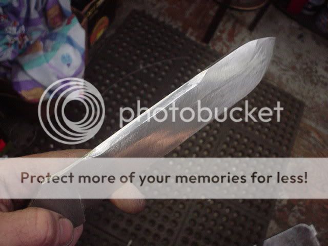

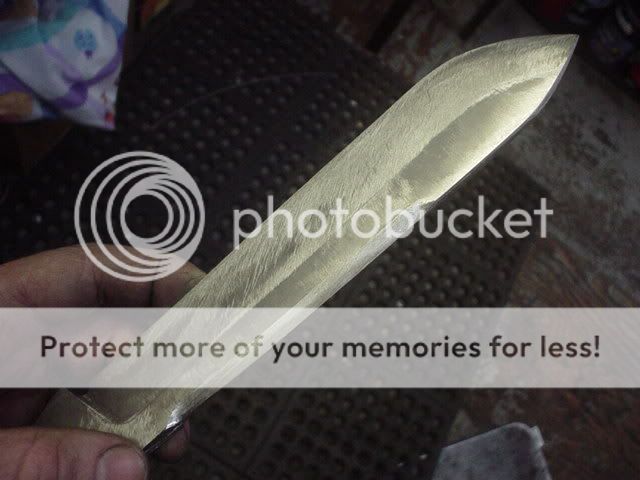

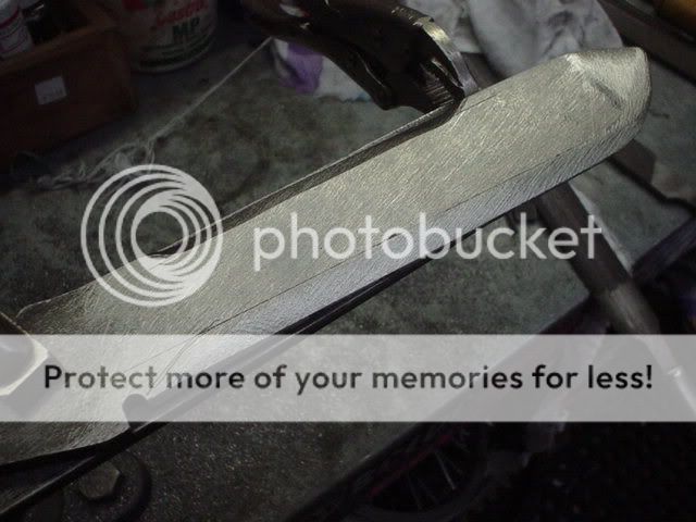

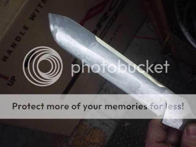

Things are starting to look a little better. Still on the files, but I'll be ready for sandpaper soon(ish).

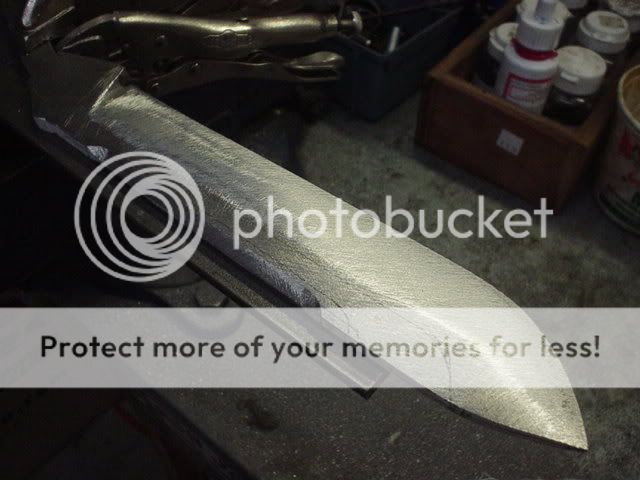

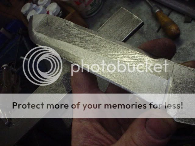

I go out for a few hours, Lorien, come back 7 hours later and
find that have you have created something that looks like an
amazing knife in advanced progress!
What is going on here?!
Is it transported inspiration from your fellow countryman
that is flowing through your fingers?
