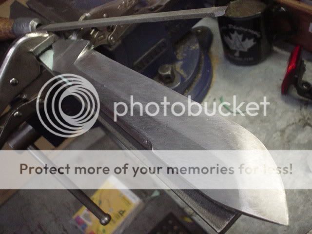

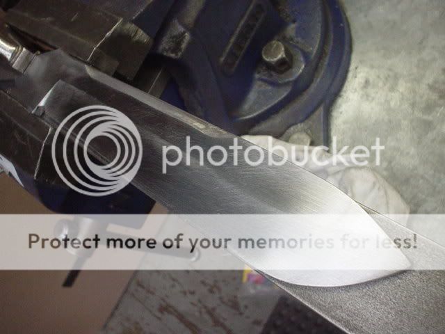

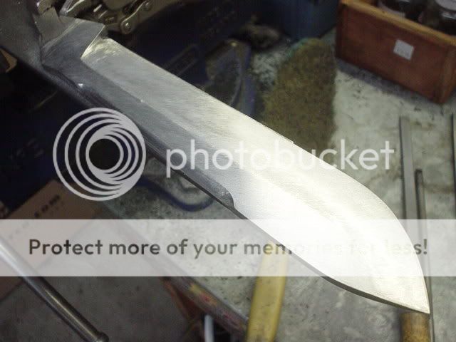

great looking so far. you have made really quick progress on that blade. I would hate to tell you how long it took to make my first and only (the itty bitty blade little ugly), in the few stolen moments I had to work on it.
Lorien I would say you are ready to HT. that blade . And it is looking good. If you can do that well on your handle this will be a killer first knife. O and nice wip thread.

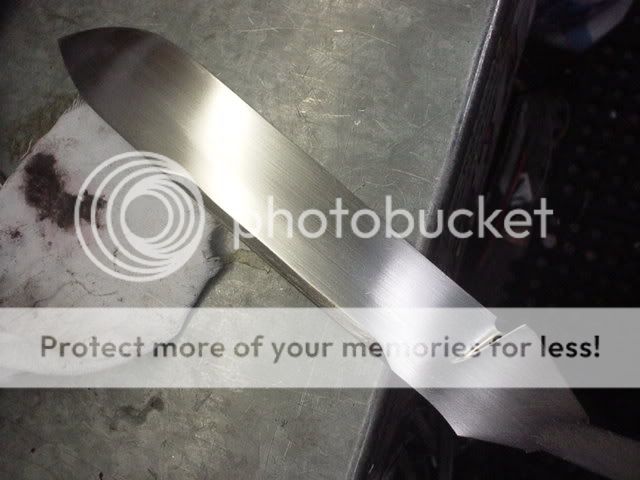

Thanks Dave! I still have to sand the other side and get rid of some file marks, but she's getting there. Once I get the blade all cleaned up and ready to go, I'm hoping to start the handle today.

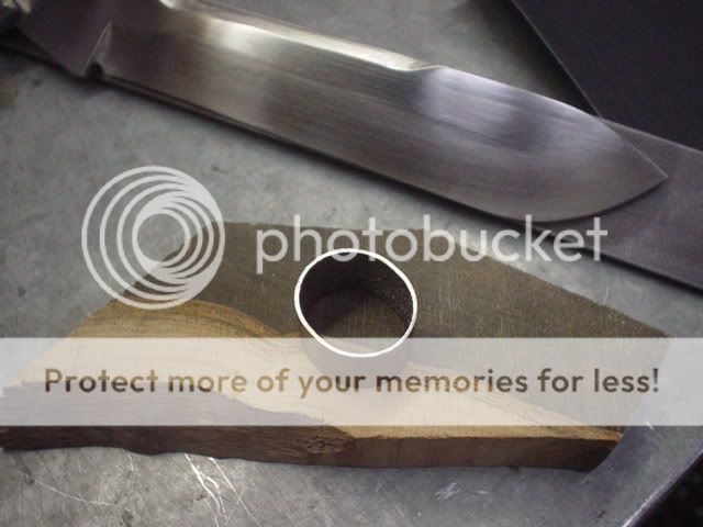

Well, I started getting the handle going;

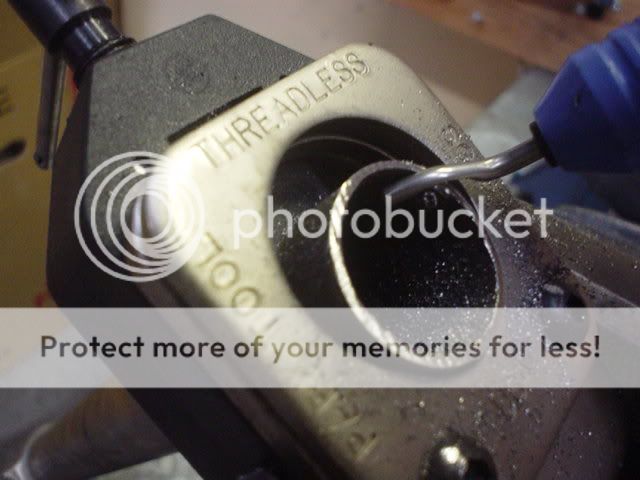

I have this neat wood, and I'm going to use this piece of titanium tubing, (a bicycle seat post:D) as a ferrule(?) to keep the wood in good shape.

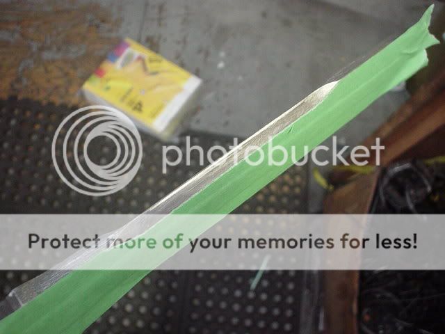

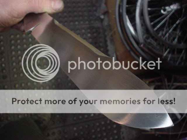

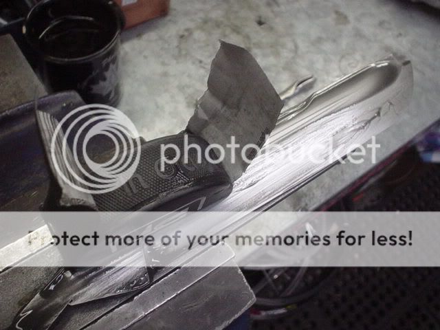

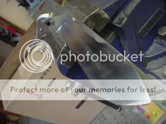

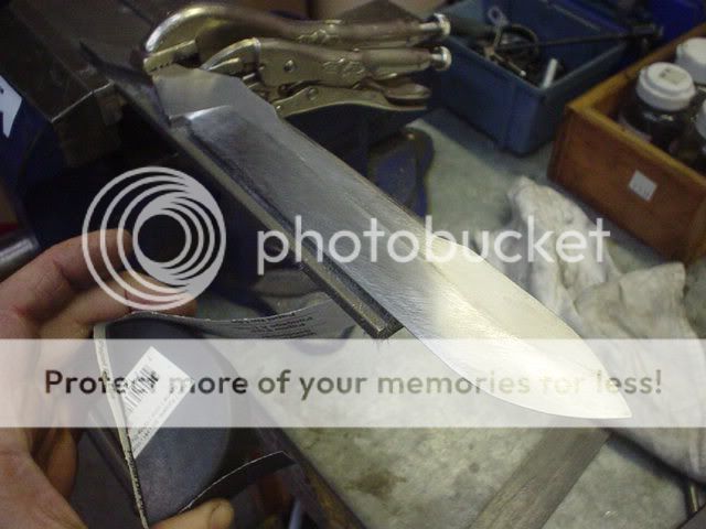

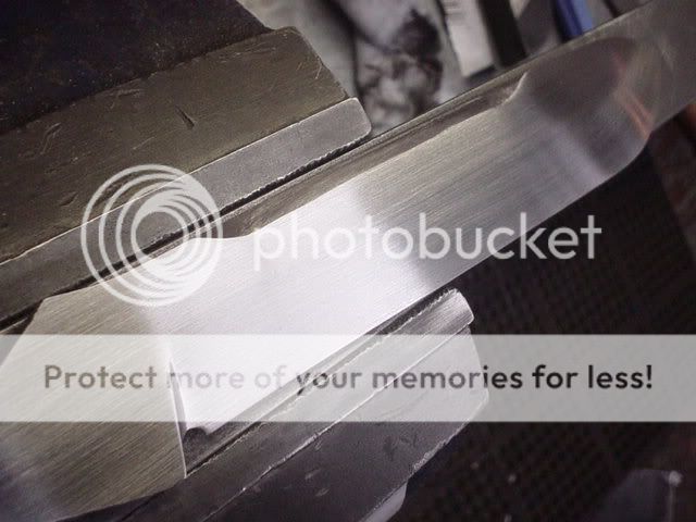

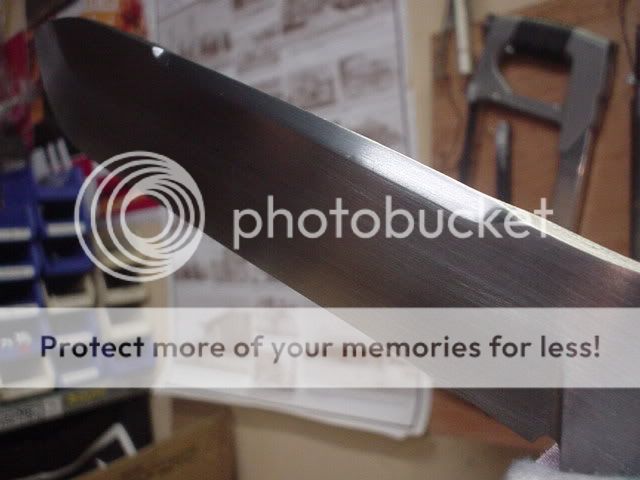

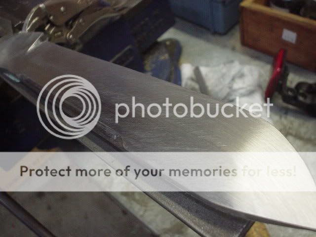

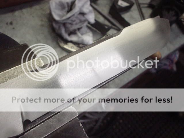

And I got the blade pretty much sanded up. It was a real b!tch trying to get all the file marks out, but I figured it would be easier now that the steel is 'soft':rolleyes: than after I harden it.
I put tape over the side I already sanded, in order to avoid marring the surface I so painstakingly prepared;

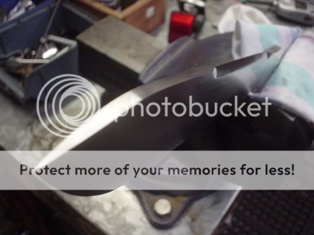

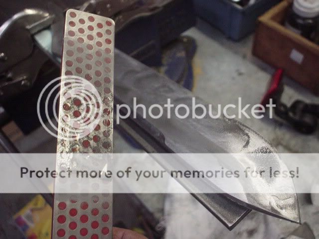

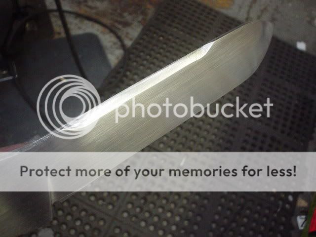

I thought I could save some time using this diamond hone. I was wrong.
File, all the way!
