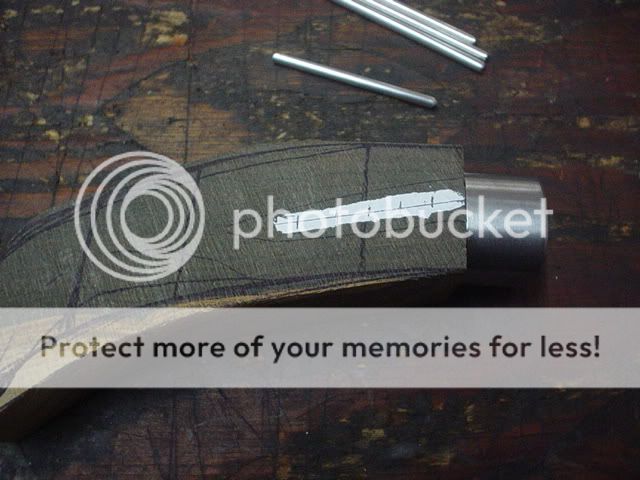

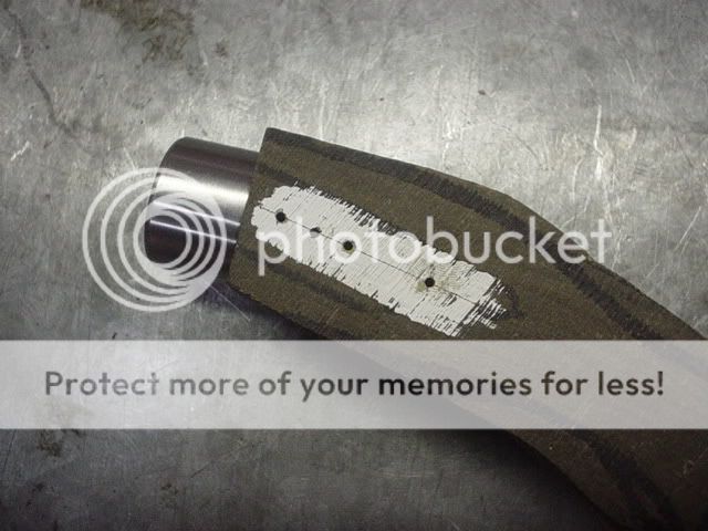

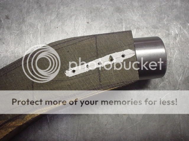

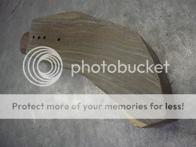

I've hit the wall a bit with the ferrule, and I'll just have to buck up and go to an art store somewhere to get the acid resistant ground for my etching plans. But, in the meantime, I carefully started drilling the holes for my pins. The pins are still much bigger than the holes they're going through, but at this point I'm just not going to take too many chances.
hehe, yeah I know:o.

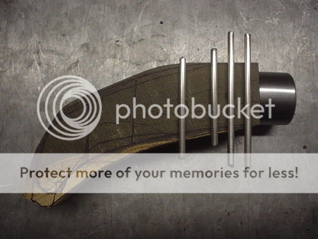

But the graphic I plan on using in the ferrule incorporates a series of three and I thought three pins might further the concept at least in my own mind. Three amorphous designs and three solid pins for strength, hopefully a balance.
The fourth pin will be under wraps and I see it as insurance for the leverage happening at the end of the tang.
To be honest, two of the forward pins are going to serve mostly a decorative purpose, and I don't think will really add meaningful strength.
JB Weld is probably going to be the major factor in the strength of this handle fitment, I'm somewhat ashamed to admit. I think it would be cool to be able to make a knife so precisely that epoxy is unnecessary, but that's going to be well above my abilities for quite awhile I expect.
Oh, and just to let you all know how 'on the cheap' I'm doing this project, that pin material is stainless rods used to hold fenders on to a bicycle:p. 10 or 11 gauge is my guess. Pretty soft material and very corrosion resistant. Shiny, too, when polished;)
Hey man, I'm no Warenski and never will be, but I'm having at least as much fun as anyone else who ever made a knife! We'll see if I keep saying that once I'm ready to fit all the pieces together:o:)
