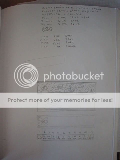

I've done a little research and I've decided to etch the ferrule. When I was in school, I took several printmaking courses and did lots of intaglio and lithograph printing. It's really fun, negative space type stuff, and my cold feet over embellishing the ferrule have warmed up some.
This is a bit of a relief, because I was thinking I was going to carve or engrave something, and my Dremel is a little unwieldy for that.
Once I am able to start scribing accurately, and I have a bit of ferric chloride or hydrochloric acid and some printing ground, I am going to screw around with a piece of dummy steel and dial in the technique.
I carry the ferrule in my pocket all the time, pulling it out from time to time and just generally hoping that some creativity will flow between it and me. I still haven't settled on what is going to go on there, but I've run the gamut from native to celtic art, to text to stylistic patterns. With etching, a topographical contour style pattern might be really neat, but I'll have to experiment a bit and see if what I have in mind can become reality.
At any rate, I keep hitting up that ferrule with files and paper, and it's starting to look very nice as it is.
If you folks like, I'll post some pics of my dummy etching. I'm hoping tomorrow to get the stuff I need to make this happen and maybe get some photos up next week.
P.S. I picked up some toilet cleaner today, with about 23% hydrochloric acid. The pure heavy duty stuff is really nasty and fumy, so I'm expecting that it just might be a time sacrifice to get the etch I want. I need to find a ground, and the closest I could find is roofing tar. I figure I might be able to cut it with methyl hydrate to get it to a useful consistency. But I don't know, it would be so much easier to get the right stuff, it's just not available locally :(

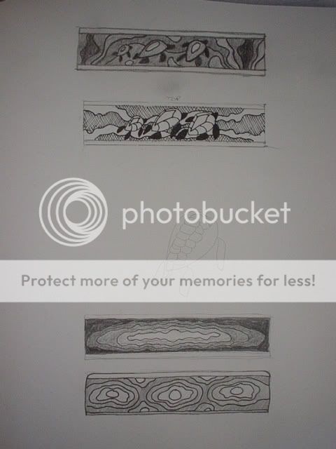

on paper, I have a good idea of where I want to go. Here are some ideas.
I'm going to prepare a dummy piece of steel and start experimenting!
:eek::thumbup:i like the bottom drAWING , but it will take some serious flying of the freak flag to pull it off.........lol:p
may the force be with you:thumbup:
my freak flag is always flying high, Andrew:)
I think I will need The ForceTM to get this knife completed the way I want. I'm putting myself under the gun a bit, too. I don't want this to drag on forever, I'm just itching to get another project underway. I don't expect perfection on this knife, but I do want to make it to the best of my current abilities. The whole point of making it is to develop my eye, hand and knowledge, so that the next project will be better and fuller.
And, I've decided to take your advice and choose door #3. Amorphous shapes- gotta love em!;) And, I can make them from roofing tar!
