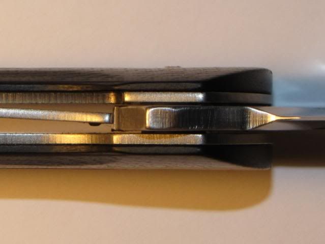

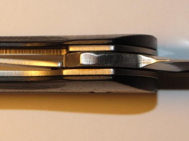

I've had my Pro for over a week now. I have all of the issues mentioned in many of the posts above. The blade is off center when open, and sometimes hits the liner when closing. The liner lock is very inconsistent. Sometimes it lines up fine, other times it goes all the way over to the other liner. This knife has tiny little white nylon pivot washers, when combining that with the little itty-bitty pivot bolt/screw, it's a bad situation all the way around. Also, all the screws on this knife (including the pivot) are low quality.
There are many things about this knife that I like a lot. The blade - awesome. The scales - beautiful. The overall pattern - great.
For just a couple more dollars for phosphor bronze washers and better hardware, this knife would have been a home run.
Here's a couple pics showing the lock-up variance. I did not force the lock to that position (second pic), it lands there maybe every 1 out of 5 times. I think the main blame can be put on the nylon washers - too much flex.
4 out of 5 times
1 out of 5 times
^^ Thanks for the pics. I watched your review on youtube (thanks for that too) and I could see the liner moving all the way over when you opened it. :(
