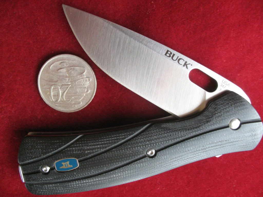

Here's a picture of the pivot screw. Does that look like a good quality screw to you? All the screws on the knife looked this way, I felt that they would strip out easily. I would take a better macro of it, but I've already returned the knife to the retailer. If you have ironed out all the issues as it appears you have, I will purchase another one. I really loved the Vantage Pro, but could not deal with it's shortcomings. How can I be sure to purchase one that is the updated version?
