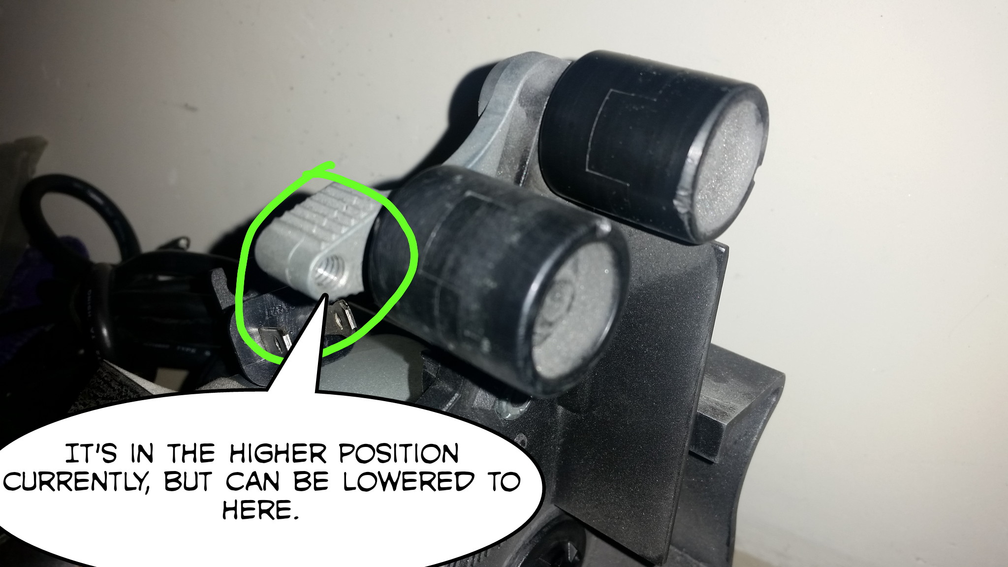

I usually polish the bevel out and when I want a lil tooth I over tension the x65 belt with the pulley on the higher setting...
I forgot to ask this when I saw it before, but what do you mean by higher (and/or lower) setting of the pulley? I thought there was just one way to set this up?
Oh, I remember seeing that. I double checked and they call it the "short" or "long" center position based on whether you wanted a flatter grind for straight blades, or you wanted a more convex grind on the curved blades. I think I just set mine in the "Short" position as I didn't have any dramatically curved blades. I never even thought about going back and forth between them based on what I wanted to do with the edge.
Thanks again for the info!

Yea works great, on some knives I want a greater convex, mainly on thicker knives..then on thinner knives or atleast thin at the edge I use the "short" position to keep it closer to a v edge with minimal convex.
