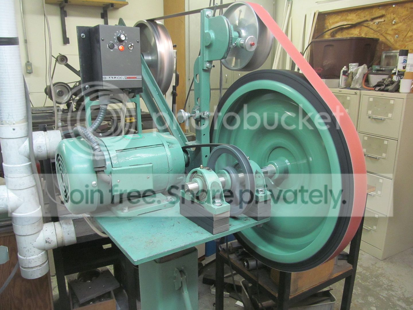

It started as an experiment to see if it would work. I was looking for a hollow grind that would work on thinner blades such as hunting knives. My friend found this US Army Infantry Fighing Vehicle idler wheel that was 3" wide and 24" across. I had it cut down to 2" wide and had a hub made for it to fit my grinder. It takes some getting use to but I like the grind. Its almost flat but not quite.

Good lord Bruce....that almost looks cartoonish! It looks like your tracking wheel uses a ratcheting mechanism similar to the TW-90. That's pretty cool!

So do all your grinders use the 132" belts. Just noticed that thing in the background.
