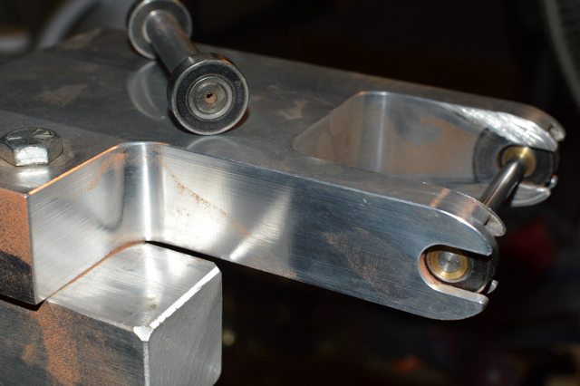

I decided to work my way up to a wheel like Bruce's to get used to the grinding a little at a time. Here's what I have so far. Larry
