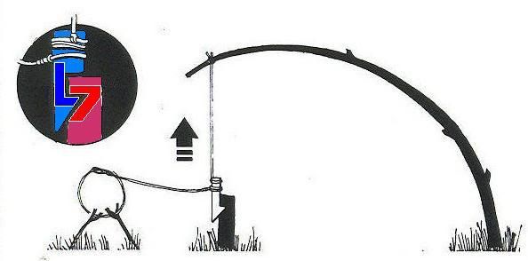

I don’t know what it is about trap triggers but they hold a great fascination for me. From the simple L-7
to the more complex large animal deadfalls.
Perhaps it’s the deadly efficiency of something that can be made from a few sticks and bits of cordage. The fact that the concept works is demonstrated by the fact we’re here today. It’s, in a large part, how our ancestors fed themselves.

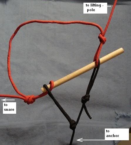

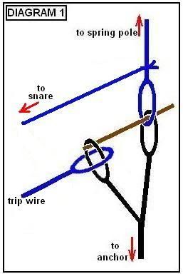

The spring pole cord is attached to the 2 anchor loops by way of a stick (nail) running through the two anchor loops at an angle (this is important) and the spring pole loop. (Diagram 1)
The snare is attached to the cord going to the spring pole and (in the original), a trip wire/cord was attached to the lower trigger loop, so that when something tripped the wire, it pulled the lower loop off of the nail, releasing the spring pole (and the snare).
In the original, the trip cord was strung between a rock, which it was tied to, and the lower anchor loop. However I wanted to use it as a neck snare which directly released the trigger. To this end, the trip wire became the end of the snare and was attached to the spring pole cord.

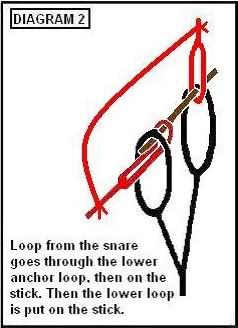

Working on this, I encountered two problems. The first problem was the snare loop dropping down around the anchor loop, negating the mechanical advantage of the trigger to the point where the trigger may not release, or at least, not release properly. (Diagram 1B).
In Hood's application, the tension of the trip wire kept the snare loop cord in the proper position. With the neck snare application, this tension is not present.
With a bit of experimenting, I came up with a better set up. (Diagram 2).
I, originally, had some concern that the snare loop would pull under the anchor loop without pulling it off. This has not been the case., and even if it was, it could be rectified by making the cord coming from the snare a larger diameter than the anchor loop. By modifying it in this way, the positioning of the trigger, relative to the snare becomes a lot less important.

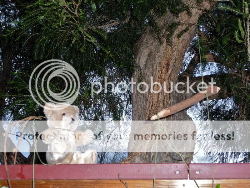

Please excuse my meagre photography skills - low light/backlight... but it's a falkn teddy snare! :eek:
I'm new to snares so please bear (pun) with my nomenclature and choice of knots - any advice re better knots/setup options is welcomed! :thumbup:
Icicle hitch from the 'spring' (tree branch), 2x alpine loops on the snare line finished with a scaffold sliding knot for the 'noose' (not sure why I chose a scaffold knot, it just came to me) and the anchor lead had 2 bowlines and was knotted just short of it's midway point with a simple reef knot around a lower fixed point/branch.
My thoughts and observations - the taper on the end of the pin did seem to increase trigger sensitivity (whether that is a good thing depends on the circumstances?). I can't realistically test this on my neighbourhood possum (protected) but if a trigger failure occurred due to slippage of the 'snare lead trigger loop' under the anchor loop - then perhaps a simple stopper knot on the apex of the snare lead trigger loop would bulk it up to prevent such slippage. FWIW slippage did not appear to be a problem with brief testing tonight. I would also use a self tightening knot on the non triggering end of the pin (to avoid losing it during triggering). Also, when setting the snare the thought came to mind that a second icicle hitch from the spring to a fixed point that is tied off to a fixed point prior to setting the trigger, and the second line is released at it's lower end after the snare is 'set', might avoid it triggering fully during the set up process? Not sure if that safety measure is an approach commonly practised?
Thanks again to DocC for this fun snare reconfiguration!:)

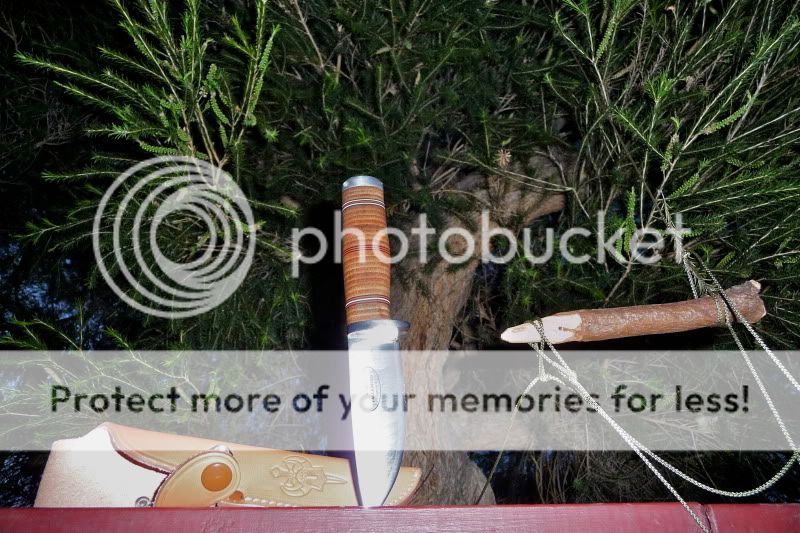

Obligatory PS - no Teddy's were harmed in the setting of this snare... :D

A little teaser:
I don't know if any of you noticed anything a little strange about this picture:
The strangeness is how the cord from the lifting pole cord to the lower anchor loop seems to stand up ever so nicely. The answer? The picture was taken with the trigger mounted sideways:
The point being that this trigger can be used vertically, horizontally, on an angle, any which way at all and in almost every position when the pull is put on the snare, the trigger self-aligns to that pull. This has an interesting application that has been tested in New Zealand by our buddy Coote. More on that later.
