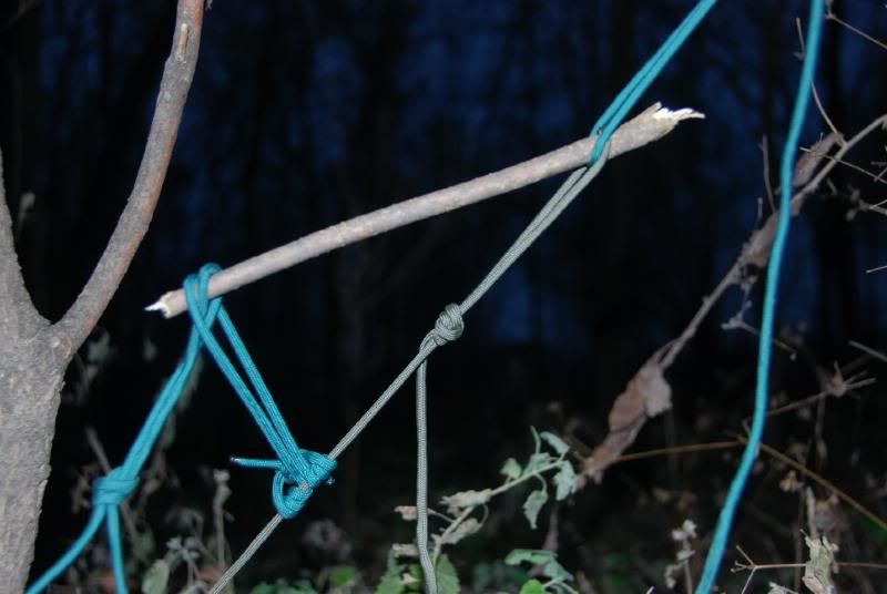

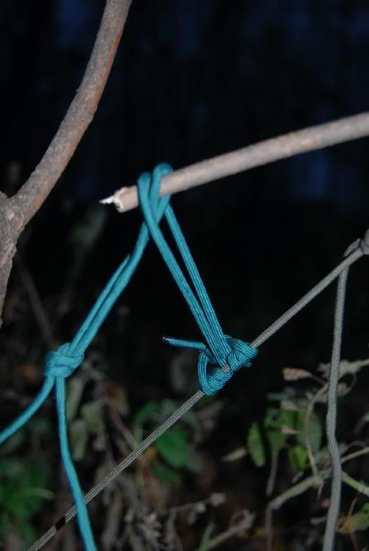

OK, captain slow is back with some more thoughts and, for the first time ever, pictures of his experiments with this trap.
So this was my first experiment with this trap. I spent a very, very, very long time trying to get the loops adjusted so that this trap would work properly but was never able to get it right.
Today I was able to get out (albeit a bit late) and try the trap again. I had a thought (yes, I am aware of the danger inherent in this) and decided to try it. Used a prussik loop for one of the loops on the anchor so that it can be adjusted however necessary to line it up with the trigger stick. Within about five minutes I had the entire trap set up, and it functioned flawlessly.
Close up of the prussik used for the trigger:
Interested to hear your thoughts, Doc, on what issues this may present for the trap. I couldn't see it doing any harm myself.
It was pretty late when I was out tonight fiddling with this, so I wasn't really able to do anything more. Well, could have, but it was getting cold and dark and the dogs were bored to the point of pestering the daylights out of me.

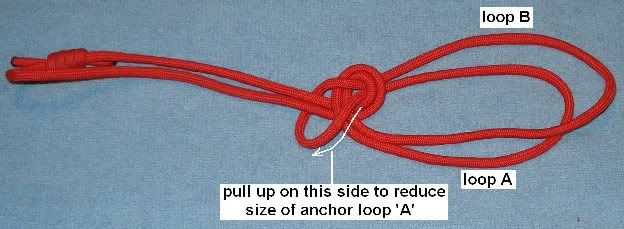

(In this part, I'm going to introduce a solution to the relative sizing of the anchor loops, one to the other.)
One thing to keep in mind is that in a survival situation, almost all of the prep work of loops etc., can be done in camp, at night, around the campfire, so many sets can be prepared. Once in the field, a few knots, etc. and you're set.)
The next problem I had with the trigger was to get the loops in the right place. I found that sometimes I had to retie the loops 3 or 4 times to get them in just the right position, and I found this to be irksome.
The first solution that I came up with was to tie a loop in each end of a piece of cord and then tie the two ends together with an overhand knot, keeping in mind the desired location of the two loops relative to each other.
The anchor cord could then be tied to a root, rock, etc. This seemed to work pretty well as it was easier to locate the relative positioning of the 2 anchor loops.
This is important as it determines how sensitive the trigger is. The greater the angle of the stick, from horizontal, the more sensitive the trigger, assuming, of course, that the stick length between the loops is constant or greater (affected by the length of each of the separate anchor loops and attachment cord). The stick, after all, is just a lever. The longer the lever, the greater the mechanical advantage, thus, the greater the sensitivity.
As I was working with this new method, other possibilities became apparent. To make the anchor loops more readily adjustable, a different knot is used. It is known as a BOWLINE IN A BIGHT
You will note that one side of the Bowline in a Bight is continuous to the other side,
so with a bit of pulling, the loops are adjustable.
(Note: you want to tie this in a loop of cord, not just a straight piece of cord. Under certain conditions, the knot can 'spill' as discovered by my buddy, Phil. In other words, use a tied loop for the anchor loops. This also helps in securing it)
Using a loop of cordage, the anchor loops can be made in less than a minute.
Let me know how you like it.
The next part will deal with anchoring.
Doc

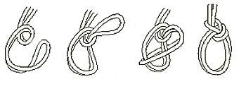

ETA: The following is a pretty basic drawing for tying the Bowline In A Bight - thought it may help.

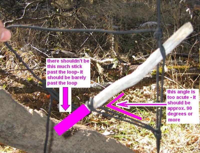

Hey Russell,
Good on you for getting out and trying it. I can tell from your picture that the trigger wouldn't work.
First of all, the angle between the 'nail' and the lower anchor loop should be approx. 90 degrees or greater. You don't have to obsess about this, though. Once you see how the trigger works, you will set it correctly, just by the feel.
I, also, think your problem is in part, because the anchor loops are too close to being equal in length. If you had shortened the smaller (lower) loop which would also have lengthened the upper loop (when using the Bowline in a Bight) and repositioned the 'nail so that it barely extended past the lower anchor loop, you would have been in business.
Maybe this will help:
Compare the angle and the length of 'nail' extending past the lower anchor loop of my picture here:
with your first picture. I think you'll see the difference.
Looking forward to your attempt tomorrow.
Doc

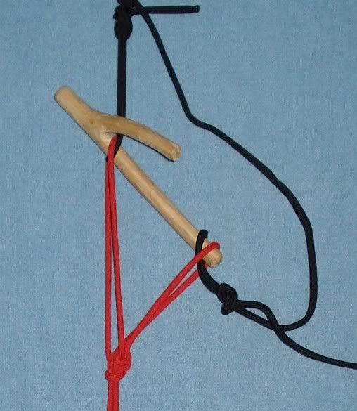

:o :o Just realized I hadn't posted the picture of the forked stick already.

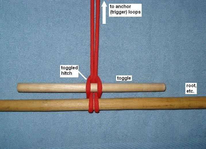

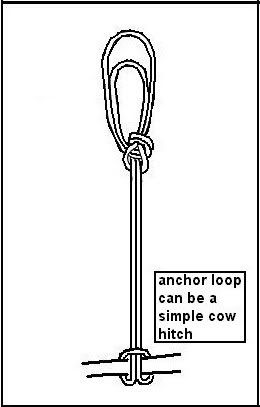

OK, anchor attachment. These attachments are assuming that you're using a loop of cordage and a Bowline In A Bight for the anchor loops.
Obviously, you can just tie this loop to a root, rock, etc. but because it's a loop, it can also be attached with a cow hitch (see diagram) and this works fine.
However, you may have need for an expedient attachment - that's where a toggled hitch comes in - pull the toggle and the anchor comes free. A toggled hitch may also reduce wear on the anchor cord, especially if you're using something like Spruce root as an anchor attachment (no really sharp bends like with a conventional knot, for more brittle cordage.) It's also very fast to attach.
An overview:
In this picture, you will note that the bottom section of the anchor loops cord is quite long. This is to allow it to be tied to different diameter anchors. The height of the actual trigger loops is not too important.
Now here's where some of the versatility is evident - maybe you don't have a rock, root, etc, as a tie down. If your main loop is long enough, it can be used as a Prusik knot on a nearby sapling, etc.

The use of a forked 'nail'. When the trigger releases, the 'nail' doesn't fly very far. One caution, don't have the smaller fork side down and against the upper anchor - I have had it bind on a couple of occasions. This is only used for playing anyway. Set up for real critters, the loss of a stick is no big deal.
