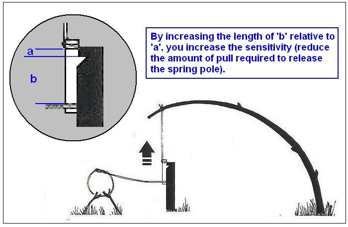

No question, the L7 is pretty straight forward but if you're going to use it, improve its sensitivity by extending the 'L' downward and tie the snare to the bottom of it. This lends a mechanical advantage and makes it easier to trip. (see Troop's comment below).
The "L7" needs too much force to trip it, in my opinion, of course. You've got the full weight or tension of the rig sitting right on the trigger.
Quite right, Troop. Most triggers use some kind of mechanical advantage to offset the full weight or tension of the motor.

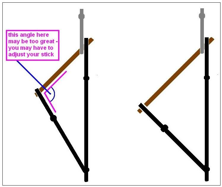

rocketbomb, good on you bro! I had just about given up on anybody, other than edgyone getting off their butts and trying it out. (Just saw your post, Russell. Good for you man. Looking forward to the pictures.)
The stick can't be too slippery. You must be setting it up wrong or your stick's not long enough, and the lower anchor loop trying to set up some kind of equilibrium is just coming off your stick. (I just whipped up a quickee side-view diagram to explain what I mean).
A head on the nail would seriously affect the trigger in a negative way.
Can you post a picture? That way I can see what's happening. If you're setting it up correctly, none of those things would be an issue.
This is why I didn't want to post more than I have already. I wanted to make sure everybody understood how the basic trigger works, and there's only one way for that to happen and that's to do it, as rocketbomb has found out.
rocketbomb, don't give up on this trigger. Once you get a handle on it, you'll love it. And there's really nothing to it, just difficult showing this over the internet. If you were here in person, you'd have it in a couple of minutes.
