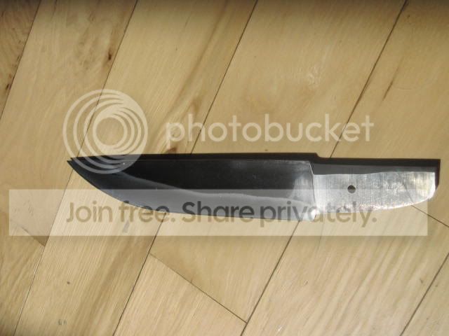

This is W2, water quenched. I used satanite.
same steel, the only variable was 100degrees lower temp
Interesting but really there are a few variables I would say. The geometries are completely different and I would think the upper blade had more mass.
Looks like you left the upper blade's spine without clay..
I think all that activity near the tang on the first blade is due to geometry. Did the clay blow off of the first blade?
