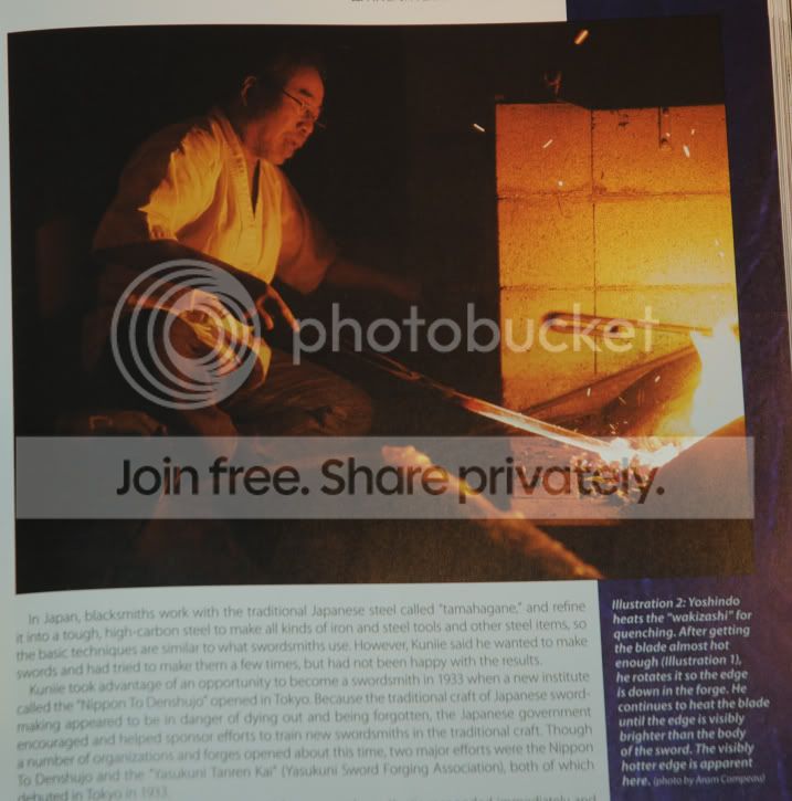

Yes I did break a couple blades and learned from my mistakes; if you bothered to read this thread. I got caught up in certain details and overlooked others.
I have since done a wakizashi quenched in water with success.
I'm glad you don't care anymore.
hey Stuart don't worry about not reading/remembering what I said because I just retaught myself this same leason recently.
I was using w2 and 1095 when I first found out that if I kept the spine below critical I had far fewer failures the when evenly heating the blade. I usually just quench in room temperature water, could be anywhere from 50 to 80 degrees in my shop. Also the tamahagane that I brought homr from Japan and the stuff that I make seem to be less temperature sensitive than w2 or 1095.
Thanks Bill. Interesting that the tamahagane is less sensitive. Any thoughts as to why? Simpler composition?
Here's that picture I mentioned.

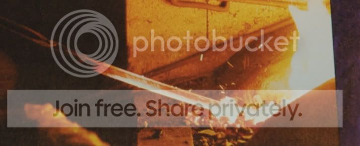

Stuart: Dr. Batson used one of my forgings at the Piney Woods hammer-in for a heat treating demonstration, and he did precisely the same process that you and Bill are describing: heated the blade spine-down in the coal. Once the main part of the blade (the greatest thermal mass) was up to temperature, he flipped it edge down, and let the edge heat up to austentizing temperature. Very slick way to create a thermal differential (edge quench).
Pictures are in the current issue of the ABS Journal, but your picture of Yoshindo doing it is much more dramatic. :)
Unfortunately (for me, working in a garage) I don't see any way to do that in a forge, short of the faux-coal setup Bill is describing.
