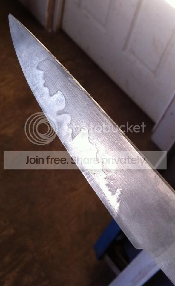

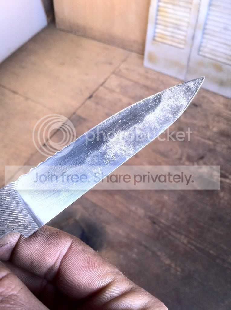

I am having success with 5 seconds in forge steel heated water, and then FAST into canola. Heres two i did the other day, not finished polishing yet.
Both are nicholsons, the first one I forged (my first)

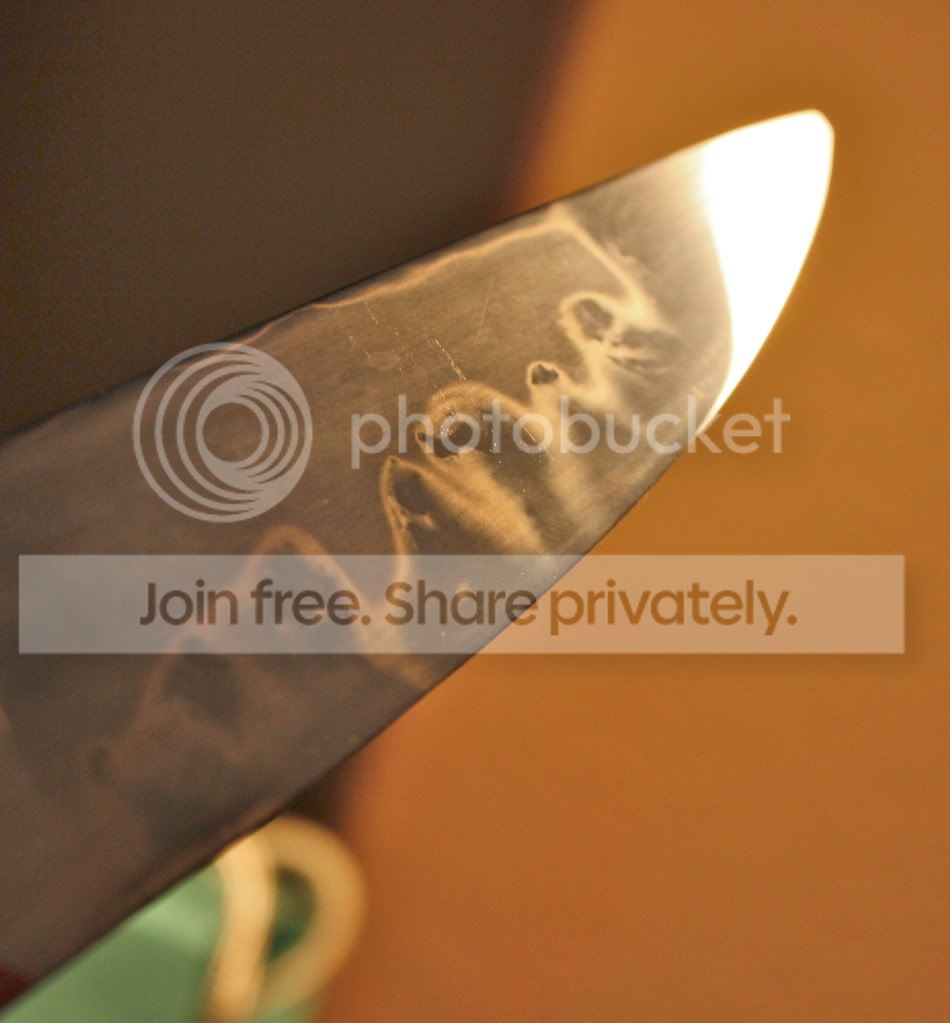

In the article in the book, "The Spirit of the Sword", there's a description and a great photo of a sword being heated for yaki ire. He puts it in the coals spine down to heat the blade without over heating the edge and when it gets close, he flips it over to bring the edge up to temperature while keeping the spine cooler.
There's a great photo showing the colour difference. I'll try to find it or take a pic of it from my book.
This was a big light bulb for me. I want to try to figure out a propane fueled "forge" that mimics the coals of the charcoal fire. Kind of like a gas barbeque supercharged... not sure it can be done though without using a ton of propane.
