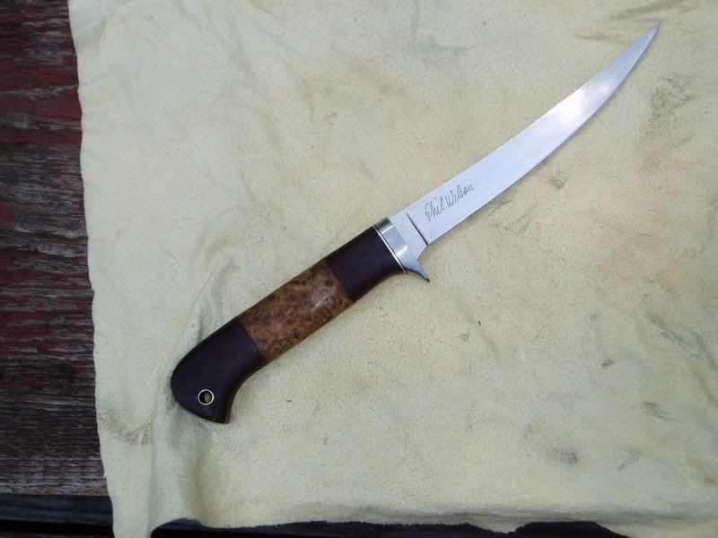

I agree with STeven that Phil Wilson makes some of the best kitchen knives around. I have two.
The first is a 6" fillet in CPM420V:

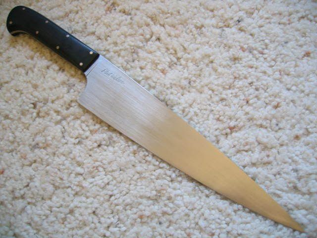

This is a 9" Chefs in CPM10V:
They both cut extremely well and stay sharp.
Jim Treacy
