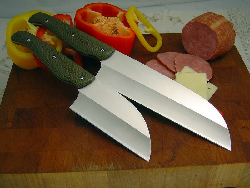

I have two almost done that are TiAlN coated which is dark antracite and they will have orange grips. The TiAlN is rated safe for food prep. Just have to mount the grips!
