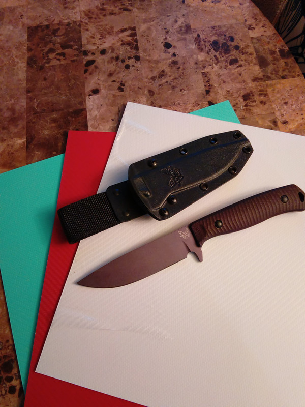

I ordered more Kydex in Tiffany blue, White, and 'EMT' Red. 12x12 in .080, Carbon fiber pattern. And of course, every color I ordered is being shipped on the slow boat. Due here around the 18th.

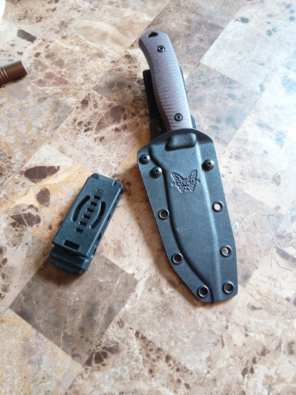

First thing getting remade is going to be this Benchmade sheath. The retention is less then wanted. It's loose enough, that brushing up against a cedar tree will pull it past what snap it has. Bought some belt clips that snap on. They have a button you can push to release it. Don't know how I feel about it. The button sure is easy to depress.
Anyway, imagine the sheath in the picture. Having white on the outside layer. With bright red on the other (the hip facing side). With a much better molding. All I need is for the Kydex to show up.
Those Kydex sheets showed up today. I'll layout my pattern tomorrow. Take the whole day thinking about it. Come Monday, I'll have another custom Kydex sheath. The Benchmade factory sheath reeks of an afterthought. An, "We gotta ship something with this knife". It is not quality.
This particular knife isn't getting the Tiffany blue. I need to plan out that color. So it's A maybe. But the white and Red are going together one something. With a purple knife, I dipped too far in a bath of RIT synthetic.
Benchmade Anonimus.
