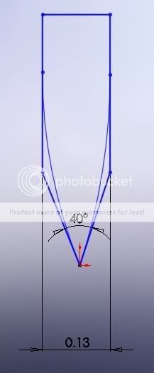

"Zero" grinds:
With the same edge bevel angle:
Required height of a grind to match the edge angle:
This shows that what people consider as "removing shoulders" from V grind is actually only need of a convex to MATCH the original V edge angle. However, if you protrude flat bevel as high as you would a convex one, you get a more acute angle.
You're arguing over semantics, huugh. By convex, we are talking about the same angle at the very edge. In your diagrams the convex edge is at a more obtuse angle than the flat edge. Actually, an edge is always flat at the microscopic scale, convex is when you have a smooth transition to the secondary bevel.
No, you simply cannot understand his simple diagram.

If you "protrude" the edge bevel of a flat grind you are narrowing the included edge angle. Here's an accurate diagram comparing exact same edge bevels that was made by a bladeforums member during a previous discussion:
now if you have a 15 per side bevel with the ~20 per side micro (edge is not centered, 53 pixels to the left, 43 to the right, it's closer to 22/18 as drawn), you get this
In the same previous discussion I also posted this:
You can notice I kept the same edge angle and only from the point where original author started convex (blue line) I pictured flat, drawn to the same height as his convex (red line).
And of course it is narrower. Ceteris paribus, convex is ALWAYS thicker than other grinds.
