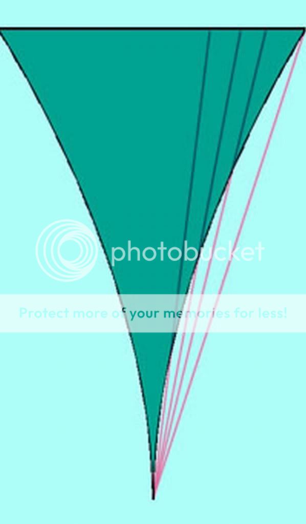

You simply can't show me a convex blade profile where I couldn't draw a straight line INSIDE it. Not in Euclidean space.
What people don't seem to understand is that comparison is only relevant if one changes only one variable at a time. All that talk about I can make that or that is irrelevant, as shown above.
Nor can you show me any of your blade profiles that I can't draw a straight line from spine to edge inside your geometry. It is a good thing, though. ;)
Wrong.
The red parts of lines are NOT inside. I can find infinite number of such straight lines. On the other hand, you won't find even one in convex grind that wouldn't be entirely in the convex profile.
Is it clear now?

That is a correct concave geometry. What is the edge angle on that blade? Ideally it can approach exactly zero degrees (but now quite, in Euclidean space). Do you have an actual knife that matches that geometry? Do you have a radiused stone or wheel to achieve it? If you do, please tell me your secret.
My straight razor looks similar, but is not the same. It is actually convex from edge bevel to spine. The ideal razor is perfectly flat from spine to edge (with a hollow in the middle for flexibility while retaining the weight and stiffness of the thick spine). This is not quite possible with actual sharpening equipment. The stone eats at the edge slightly faster than the rest of the bevel. The edge angle ends up just a bit greater than the ideal flat bevel.
Here's what a real knife edge looks like.
This is a hollow grind with secondary edge bevel. On the right are two tangents that define the overall geometry from edge to spine. By integrating those lines, you develop a curve that defines in a single equation, the shape of the edge. That curve has convex geometry. You can easily prove that (using your own definition) by the fact that a straight line from spine to edge is inside part of the bevel.
