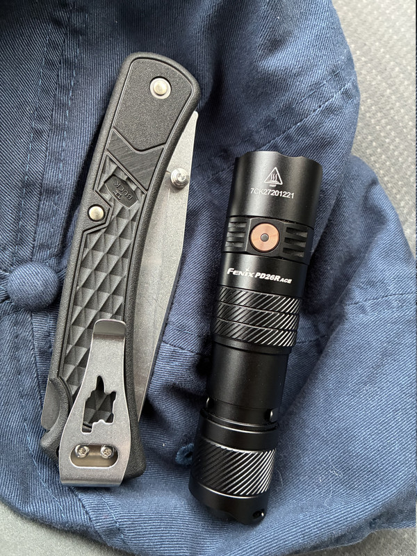

I caught this 424 and have been wearing it for a few days. Just for fun, I measured the hardness, and it's 60 HRC, although that might not be accurate
