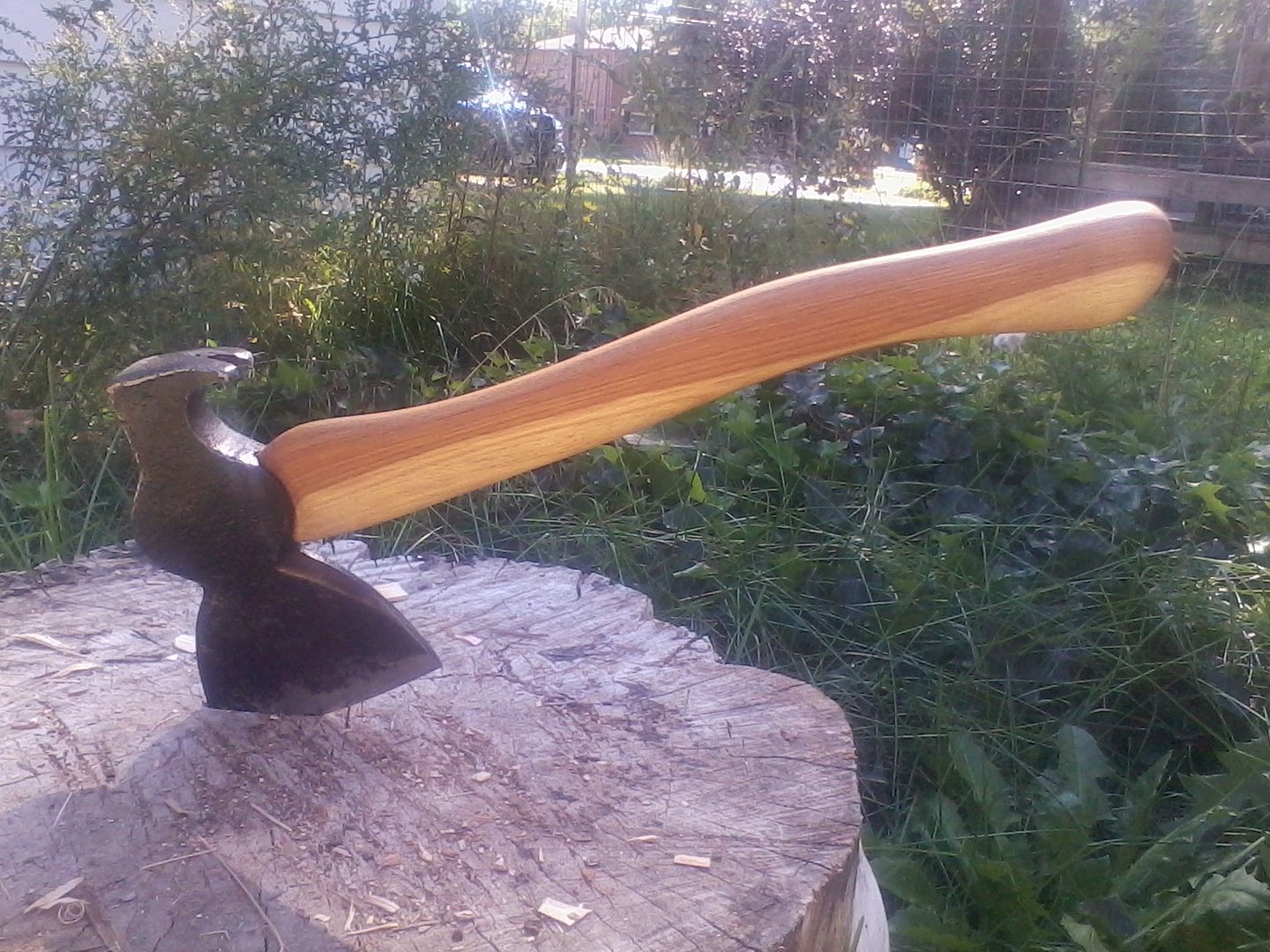

I got a bit more ambitious for this next one. It's a present for my nephew who likes to build forts and jumps for his BMX etc. in the local woods and could use a decent tool for hacking and hammering. I put a double bevel on it and cleaned up the weld on the inside of the claw with a dremel -- it was a good repair that just needed a bit of cleaning so it can grab small nails better. The handle started out as a fat old Link handle that needed thinning for the head, slimming down for child sized hands (he's 12), and something done to address the ugliness and unevenness of the swell. I really like the feel of that Walters, so I used it as my template.
Nice hang JB...I've found myself looking around at handles when I'm picking up stuff from Lowes/Home Depot myself. You really have to dig around to see if any of them are decent but you get lucky sometimes. They are a little thick but that can be changed. I just wish they had smaller stuff in the stores...around here it's pretty much full size axe, maul/sledge handle or full size double bit handles. Oh and the kerf cuts always seem to be hacked
