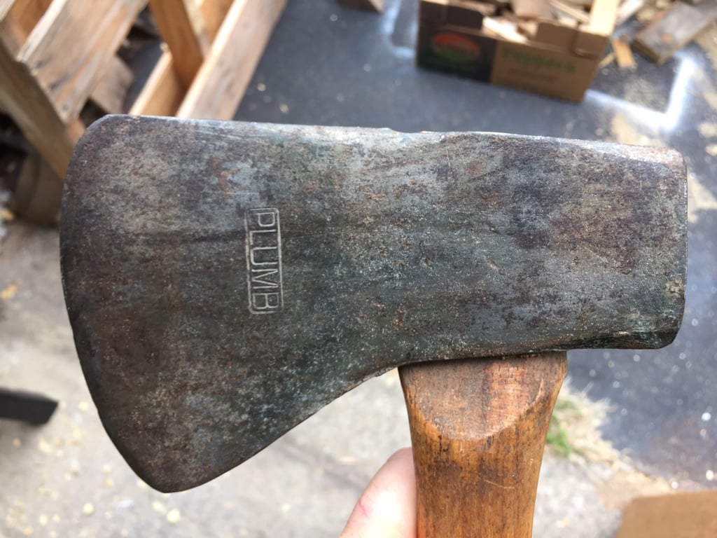

Nice job! I found a plumb just like this the other weekend. I wasn't sure what style haft to hang it on. I may just make one like this. I love how it looks. You know any of the history of this axe?
Here's a pic of the one I found.

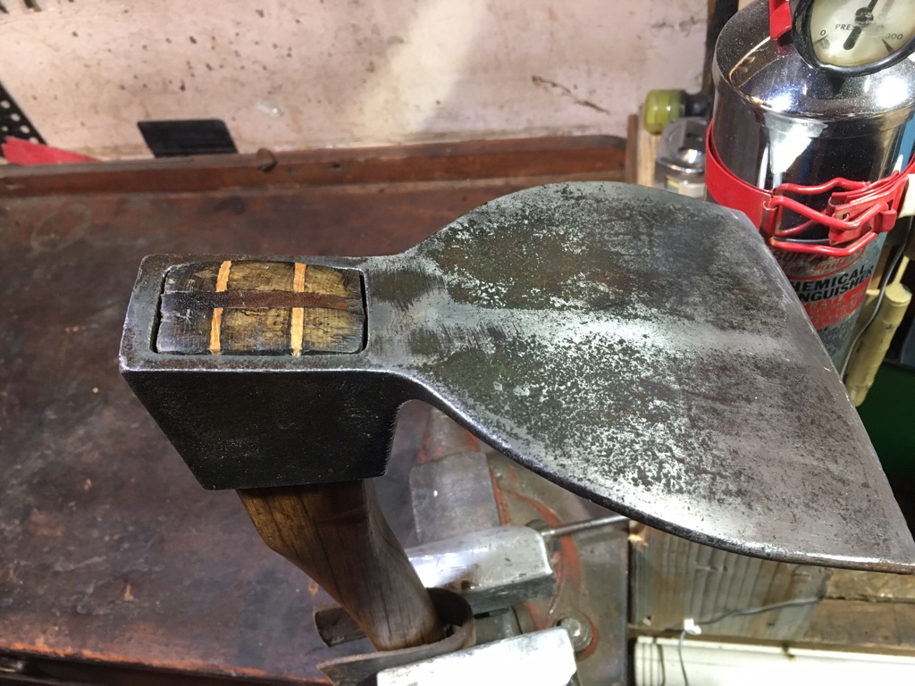

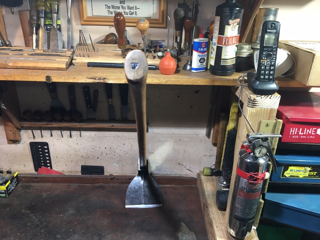

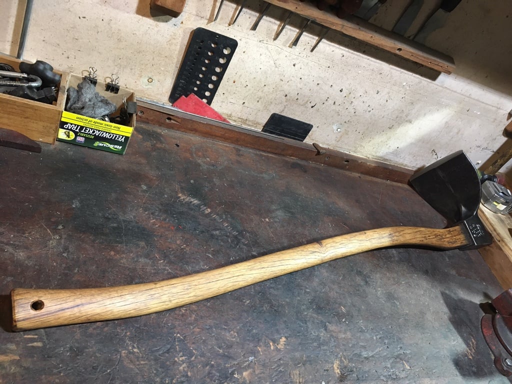

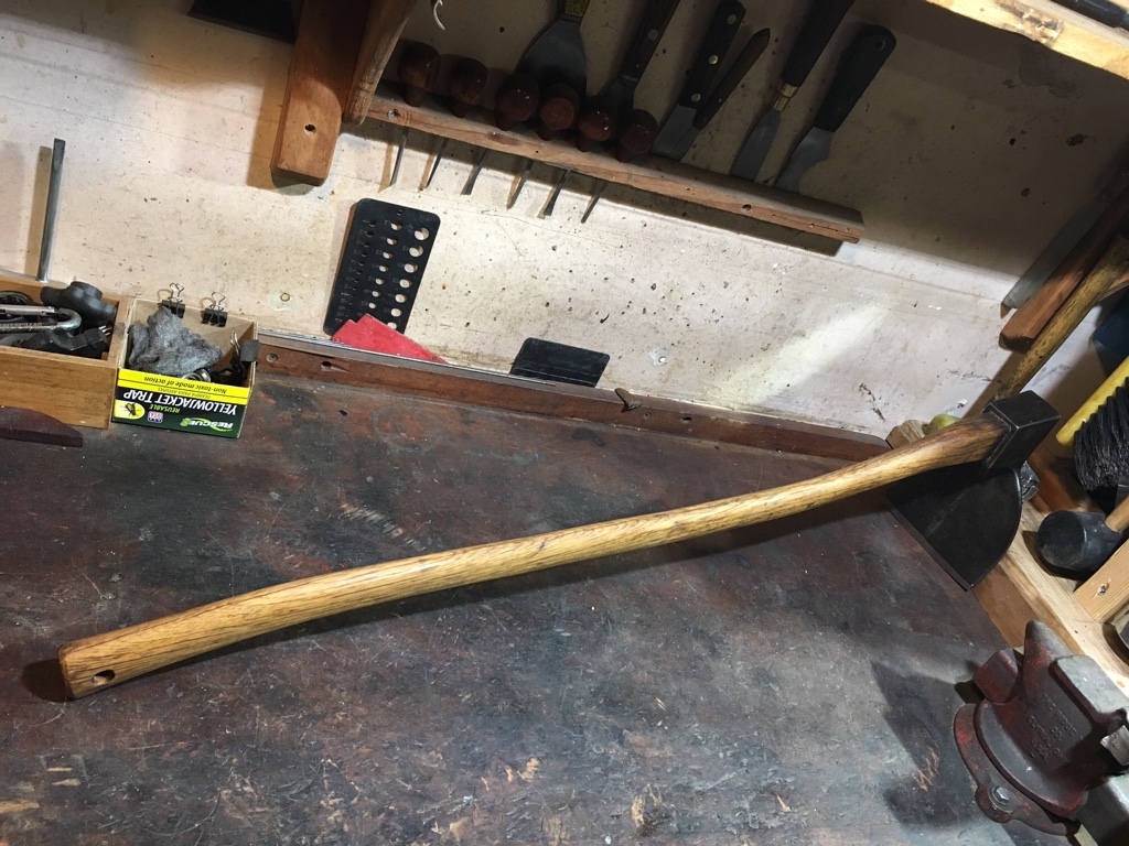

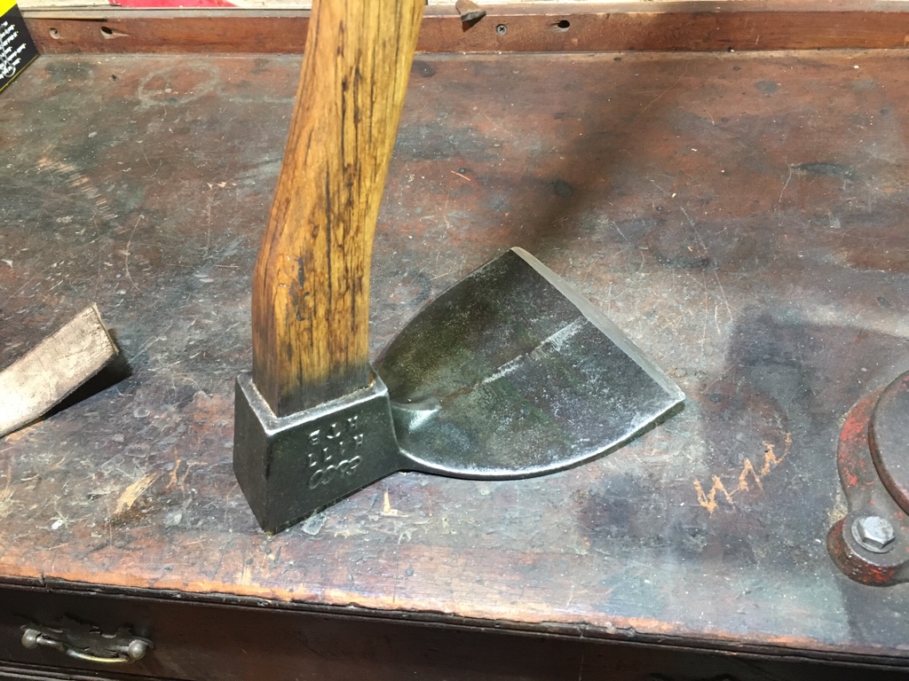

Here's an adze that was given to me a while back. Handle was very dry and checked and blade was dull, probably from being used as a grub hoe. Handle had shrunk so much that handle pulled half way through the head so I tried cross wedging for the first time and it seems to have done the trick. Thanks for looking, SW.

A couple things. First, that's a grub hoe. You can tell by the width. Second, were it an adze you'd want some room in the eye front to back. An adze need to be tuned to present the blade to the work properly. This is done with a shim placed either in the front or back of the eye as required to tune the tool.
Here is an example of an adze tuned with a shim.

Thanks Square_peg, that's good information. Had no idea about the wedge adjustment, makes sense though. It was made by Esco corp. so I assumed it was an adze...it's now a grub hoe with a real tight handle😂
