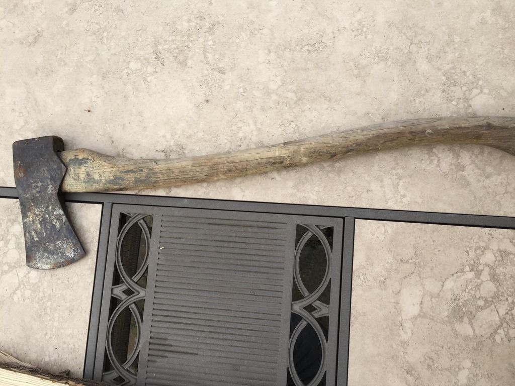

I have never had a Swedish axe. So just recently I bought a "Swedish military surplus new axe" from the SG and wondered what would show up at my door. I was extatic to end up with a Sater Banko that just needed some tlc.*
As received-
Cleaned up and rehung a little closer to the shoulder-
Honestly, for $20 I am thrilled!
You should be. It's a fine looking axe with good pedigree.
Thanks Pegs! With surplus items, you just never know what you will end up with.

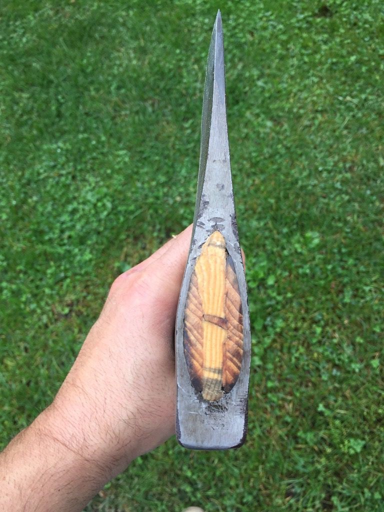

Question for you, if you don't mind: since I'm a novice, I made the silly mistake of cutting a new wedge out of pine but with the grain instead of against. It split when I drove it in so I filled the split with some ash. Should I be worried about this hang or just monitor how tight the head stays over time?

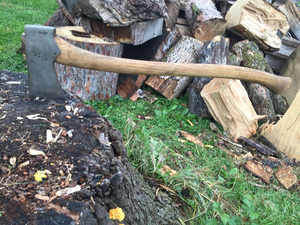

Hung this mini Norlund Hudson Bay on a hickory handle today, I really want to keep this one to use but it's in basically perfect condition so I could sell it, but a different one of the same size and have a lot left over still. Decisions decisions...
Was that pic before the head was completely seated ? Cause that thing still has quite a ways to go.
