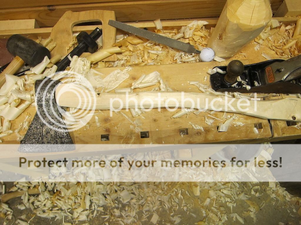

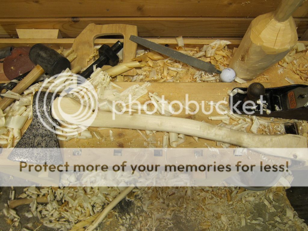

been working on a couple of birch axe handles, i got some staves from a birch which had been downed by a beaver, there is a couple of knots and defects, we'll see if they compromise the handles.
i have made another one for this soviet axe i found online, but it warped like crazy when i had carved it to the final shape. this i made tonight
Aikonen I always enjoy your posts. How much does the head weigh? Handle length?
Im glad you do friend,thank you. I have no idea, but on the parcel it said 1100g, it feels about right.
Handle length will be 60cm once I wedge the head and cut it to final length.
