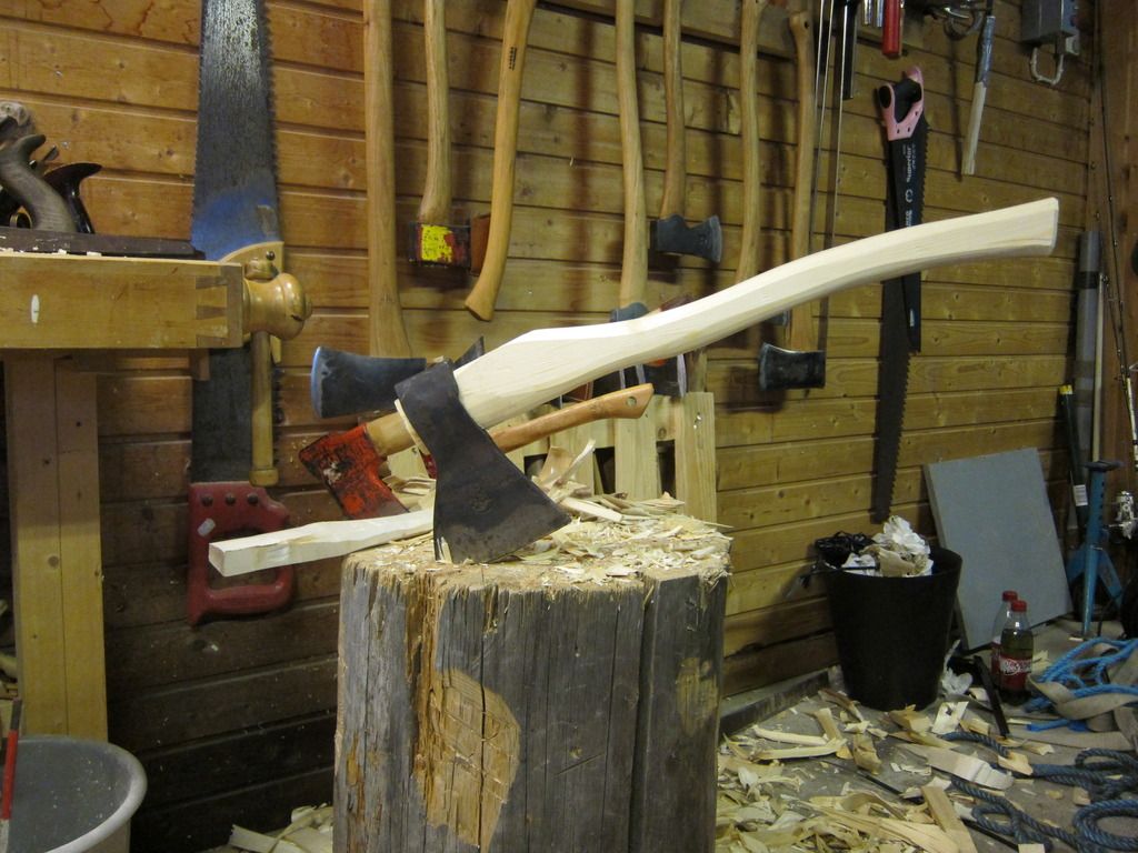

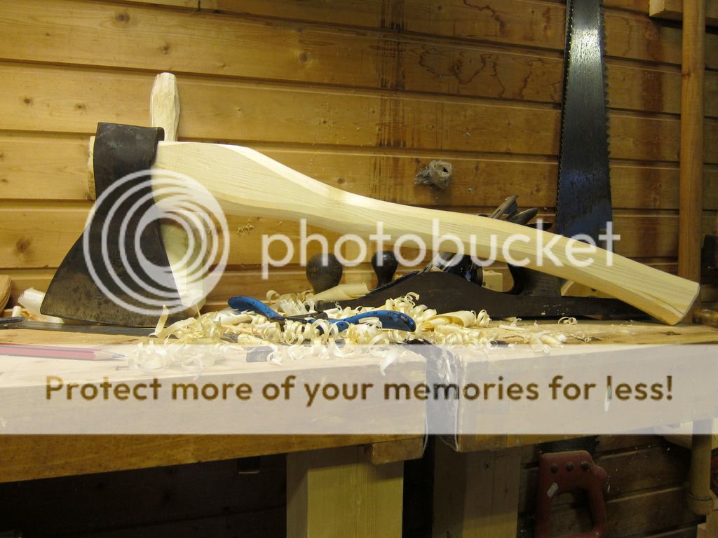

i wanted to carve a handle to see if the length felt good, the balance, and so on

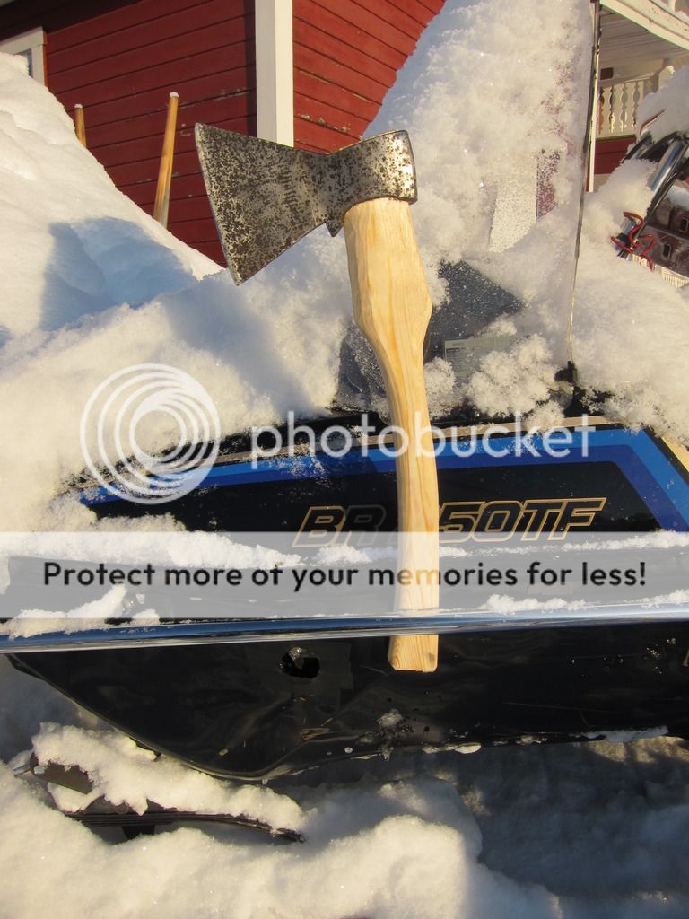

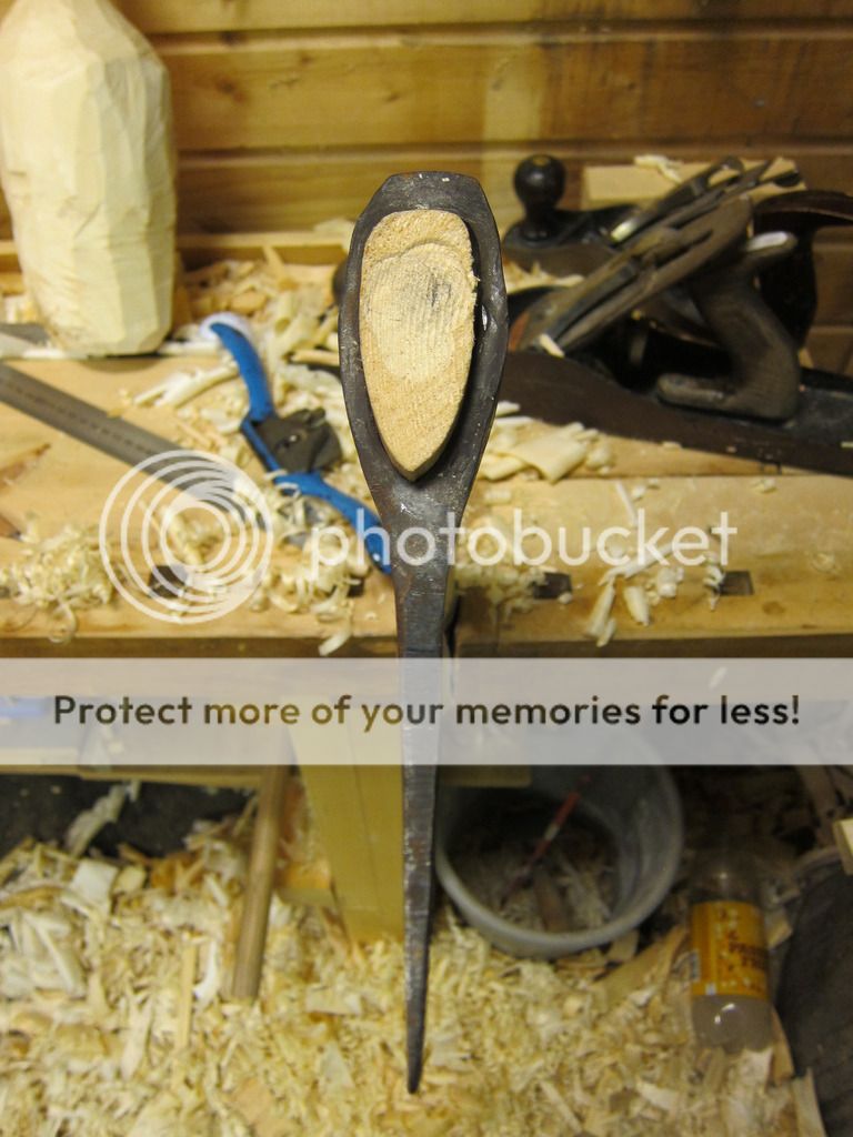

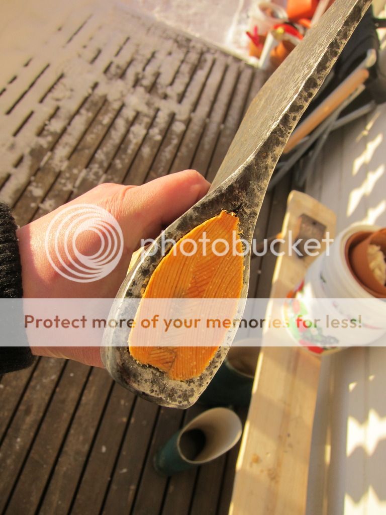

IMG_20180204_095650 by Justin Lyttle, on Flickrabsolutely. the split happened on the first birch handle i made for the smaller axe head, it did have a nasty chunk taken out from when i splitted the blank a couple of months ago, it was a poor choice of handle material, but then only piece of birch i hadGreat work Aikonen. Regardless of the in the field split, doing mock-ups/trial runs is interesting. There aren't any down sides to it I can see.
The more you do something, the better you get. I can think of a hundred less productive things to do lol.
I've done trial handles out of Maple for a large broadaxe and a coopers axe - just wanting to see exactly what the offsets look like before getting better wood.
Also two trial runs of the tongues only on the Kemi axes trying to figure out the angle the handles should come out of the eye into the rest of it.
