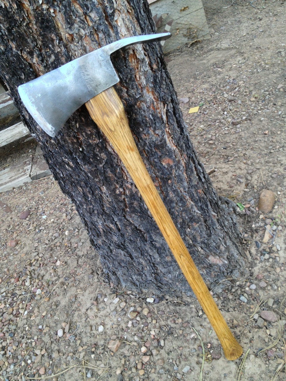

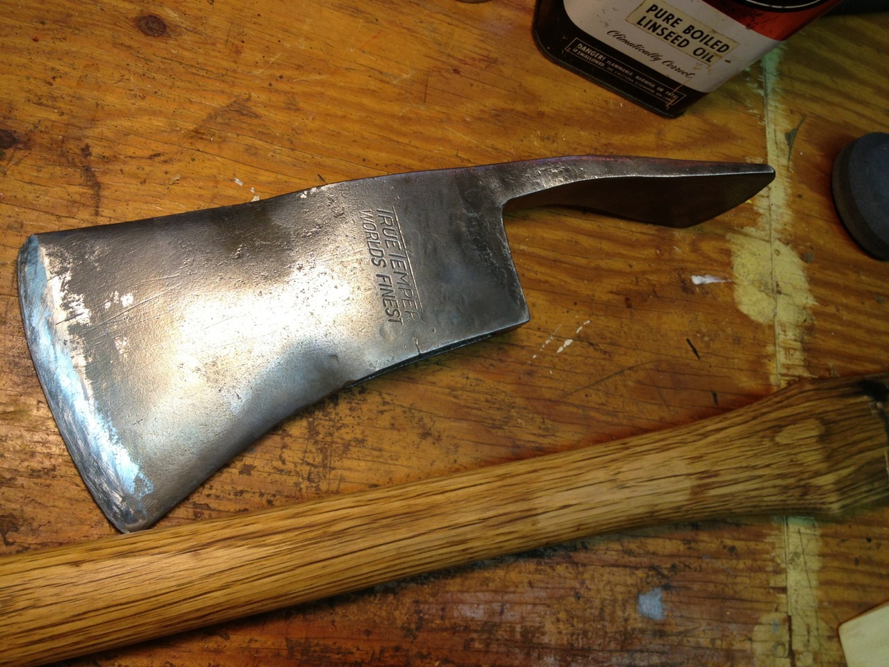

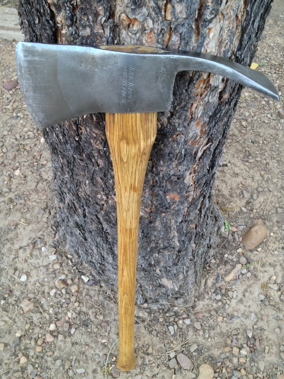

True Temper "Worlds Finest" Pulaski.
Was able to re-use the original handle.

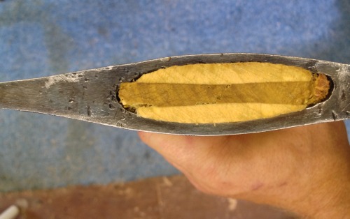

Previously mentioned TT KATCO, same handle (after some straightening, we'll see how it holds up). I wasn't sure about taking the edge all the way back for the big chip. I'm guessing that if I don't, the metal could crack there right? What if I smoothed out the chip only? Also one of my better handle fits, except for the fact that I can't make up my mind whether it's upside down or not.
I would clean out he chip and leave it. It will sharpen out in a few years and shouldn`t hurt anything. Looks great by the way.

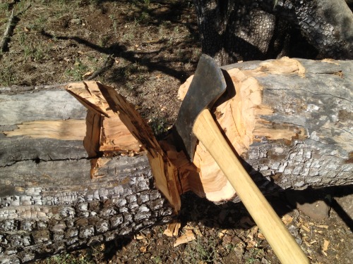

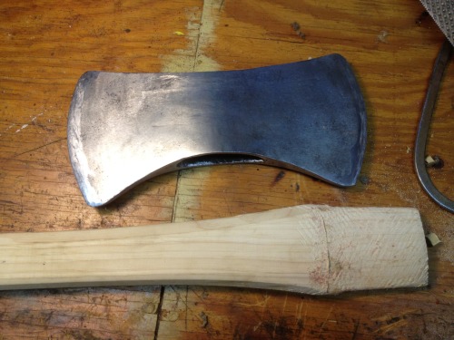

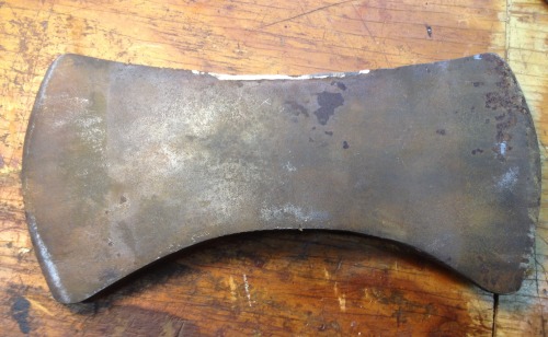

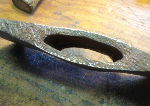

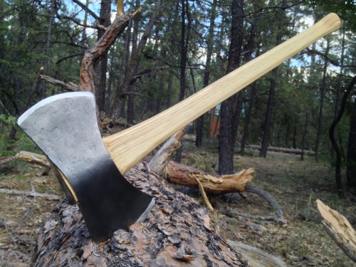

No-name 3½ lb double bit. New user & abuser
It was pitted and mushroomed to all hell so I took a layer off the surface with a belt sander and blue'd it
Hung it on a 30" octagon, final length was 28.5"
Tested it on a dead oak limb and it passed. (head didn't budge and it kept a decent edge)
Sweeet!
It's amazing how much life there is left in/under some of the really banged up axe heads. If there are not cracks and the eye is not deformed, they can be brought back into really nice condition, although you may lose a couple ounces of overall weight.

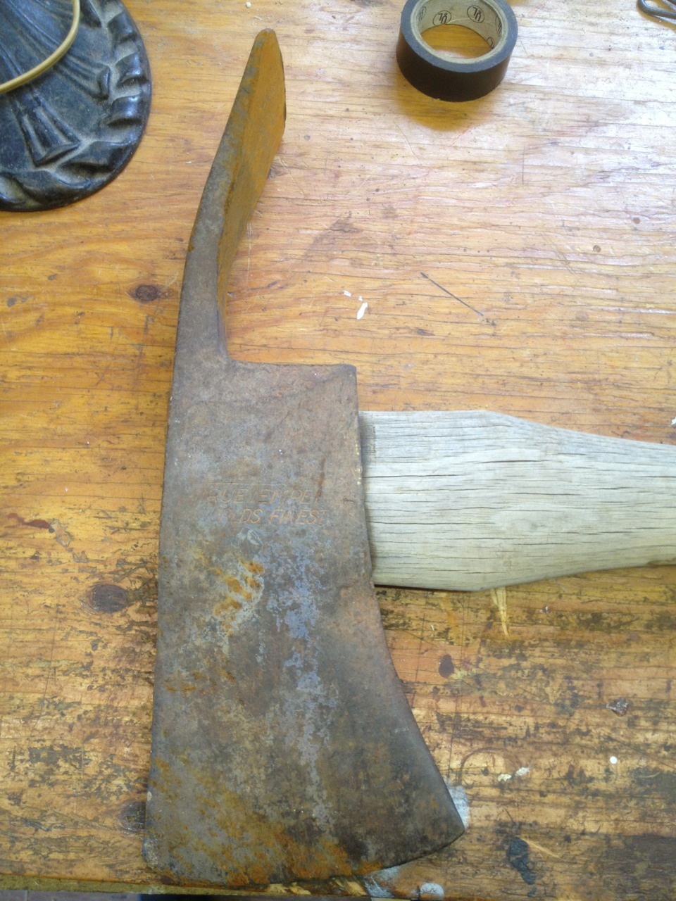

A week ago this was a $2 garage sale find fire fighters axe head (only) and it had a broken point at the rear of the head. Finished it up today.
Did you have to repair the break.. or just grind it back to a symmetrical shape? Paint job looks good!
