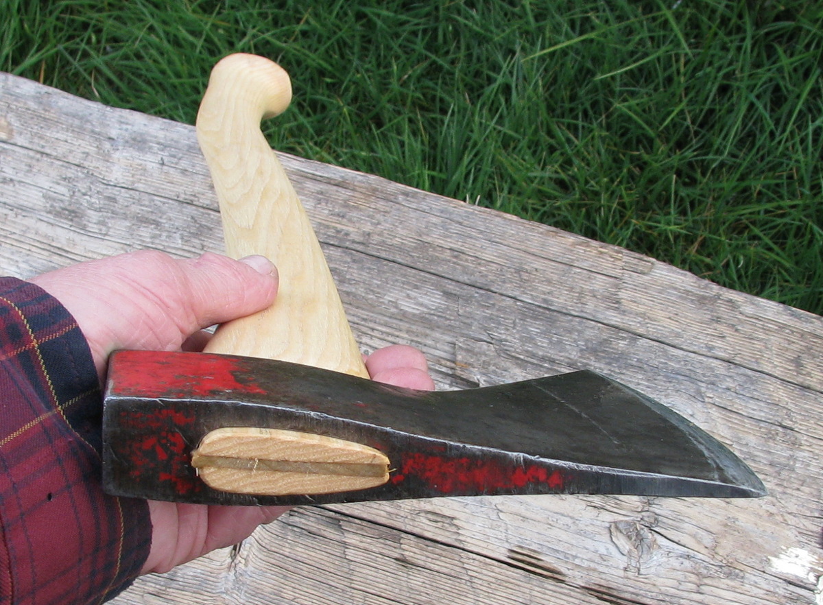

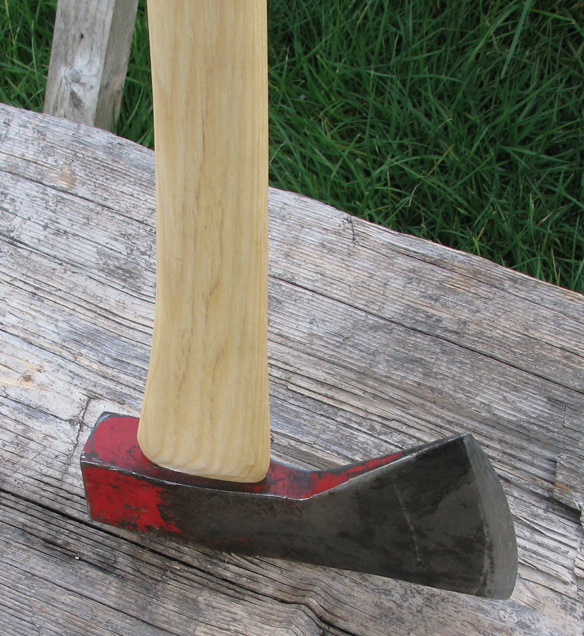

I got bored with all the nasty, cold weather we've been having around here so I thought I'd hang an axe.
I've had these Flint Edge heads laying around for awhile.
A Link handle I picked up at an auction last summer. It was almost as thick as a mattock handle, but had a really small swell. I originally intended to hang a Pulaski on it, but oh well, I thinned it WAY down, and left the scrapped finish instead of doing any sanding.
Used a wire wheel to remove the paint remnants, and rust. The head cleaned up really nice.
I had to slide the head way down on the shoulder of that handle to get the bottom of the eye completely sealed off. The sassafras wedge has been fit to the eye, and marked as to kerf depth, and ready to drive.
I cut the excess tongue and wedge off yesterday, and recessed the wedge this afternoon. I also applied, and let it soak up some BLO turpentine mixture whilst sitting there in the vice.
All finished, and as good as new!

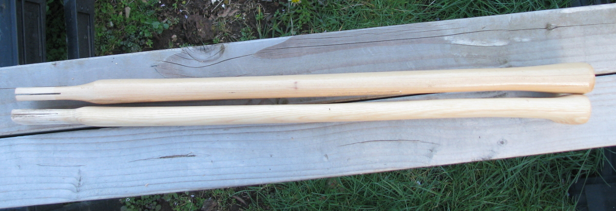

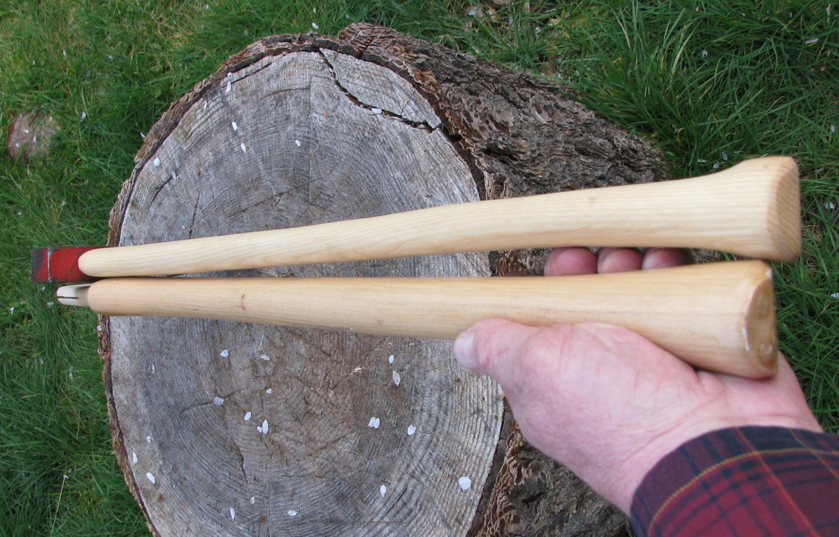

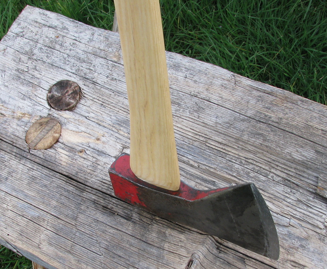

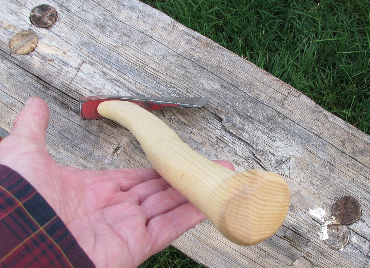

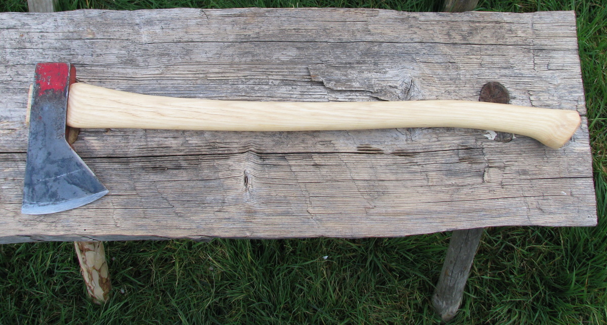

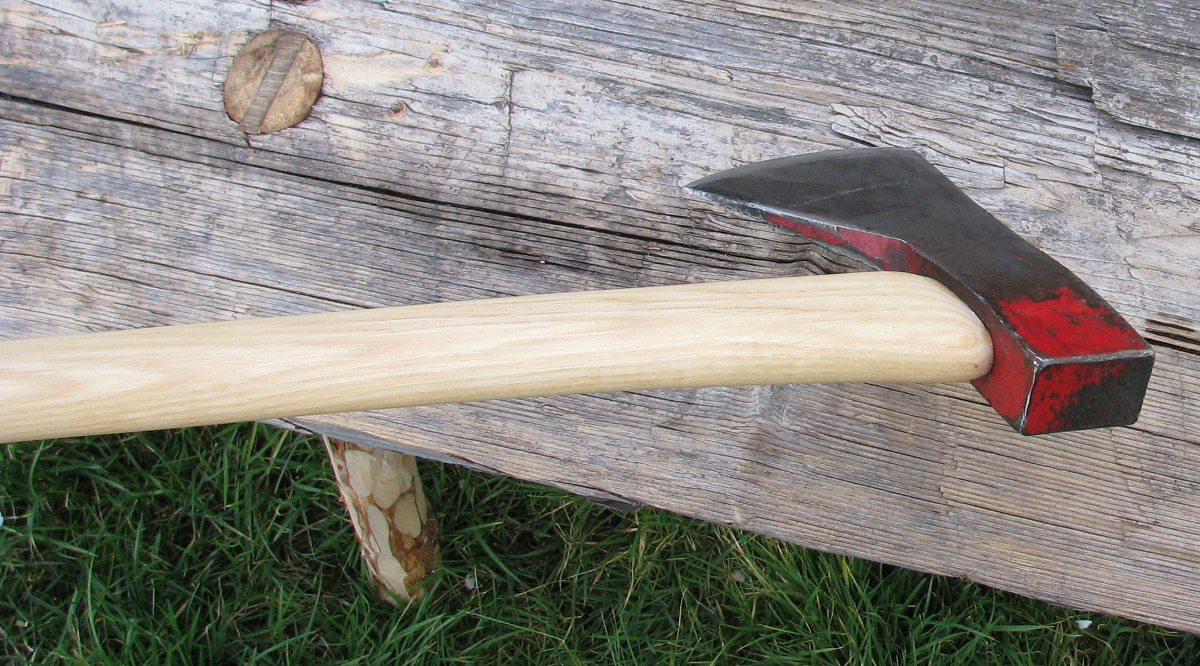

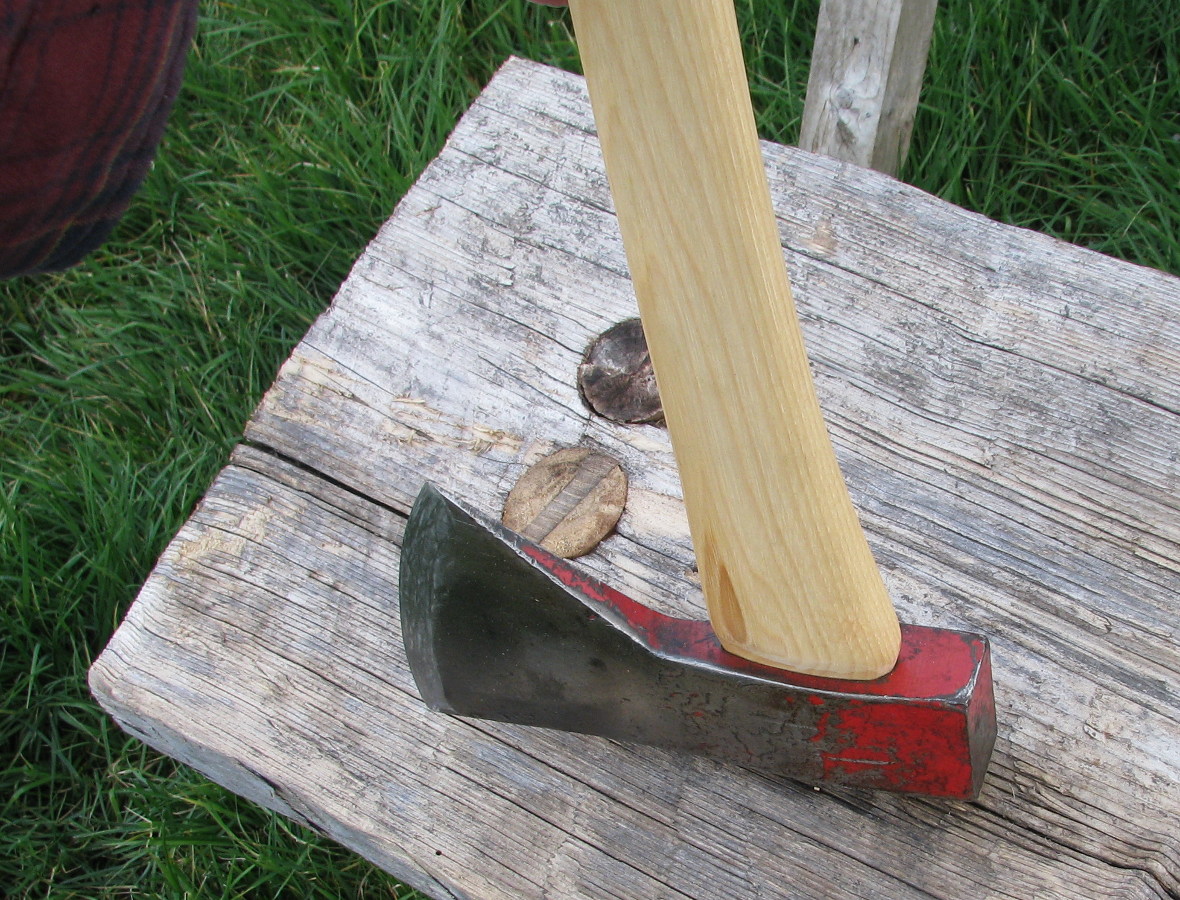

I hung this no-name Hudson Bay today. The head was in good shape and the file said it was hard so I kept this one for myself. It's a 2-1/4 pound head (2.23 after filing).
It's hung on one of a pair of Tennessee Hickory boys axe handles I picked up last year. The handles both had really nice wood and grain but as is typical for TH they came fat as a bat. I thinned one for this hang. The thinned haft weighs 386g. The un-thinned haft weighs 563g.! I shaved off about 31% off this haft!
Hmm, never seen a no-name HB before.
Sure looks like a quality head, I would definitely never suspect it to be a cheapo import based on looks.
You definitely hung it well too.
